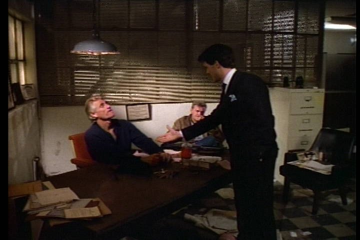

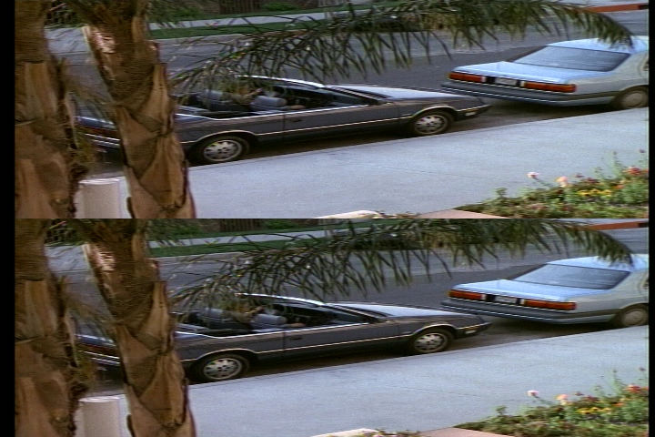

  10. It's one of those sources where if you want the best possible result, you'll need to adjust TFM (and maybe use other filters) for different sections accordingly.
    The first sample has the stair pattern baked in. It's not TFM's fault, but you can at least settle it down a bit with an anti-aliasing filter. I just threw one at it for the attached encode and didn't try adjusting it.
    [Attachment 79133 - Click to enlarge]

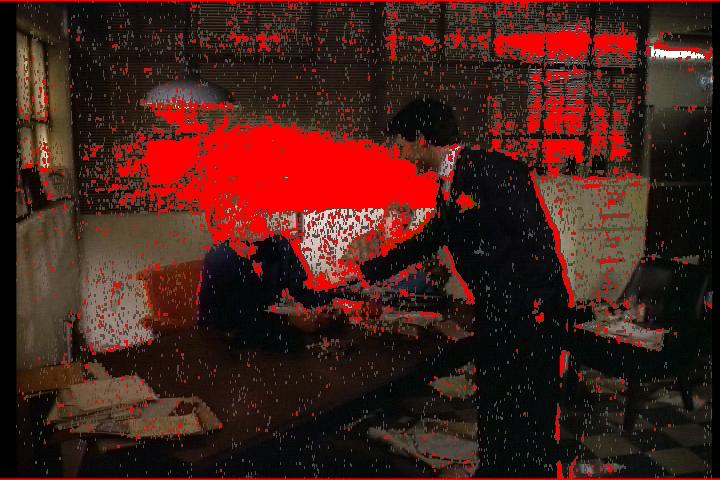

    For the record, an easy way to see where TFM is detecting combing is to do this. Anywhere you see red, it's detecting combing. It can help when adjusting it's settings.
    A = Last
    Red = BlankClip(A, Color=color_red)
    TFM(Clip2=Red)
    [Attachment 79134 - Click to enlarge]
    The cropping and resizing is only added due to my OCD. It's not supposed to improve the quality in any way.

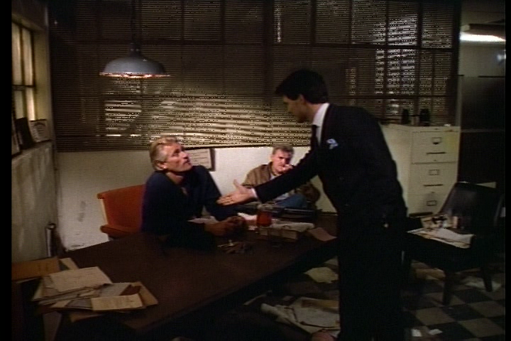

  19. Member Alex_ander's Avatar
    Oct 2006
    Russian Federation
    Originally Posted by skh View Post
    ... if there is a way to detect the scene parts which are fully interlaced?
    You can visualize them in AVSpMod for scenes with motion, by turning on/of e.g. the TFM filter. If a video fragment is full interlaced, it will still look interlaced throughout after turning on TFM(pp=0), while if it's just field-shifted progressive or telecined, it will become progressive after field-matching with TFM. So the interlaced scene will stand out.
    ... it is actually a composite cut out of telecined film and fully interlaced video.
    Can you post a more lengthy sample containing both telecined and full interlaced parts?
    The 3 samples you posted don't show this. As for the scene with blinds in sample2 (=renamed first upload), it's not full interlaced either. Due to specific type of content (thin horizontal lines) TFM filter (with its default setting pp=6) takes it for line structure and tries to modify their internal areas after field matching (frames 245, 274, 276, 277 & 278 - I didn't notice it before doing my older post, sorry for that). This issue completely goes away with disabled post-processing - TFM(pp=0), as jagabo has already shown, which results in standard IVTC pattern (4+1) for further decimation. Here's the difference before/after disabling the post-processing (pp=0):
    frame 245:
    [Attachment 79179 - Click to enlarge]
    [Attachment 79180 - Click to enlarge]
    frame 274:
    [Attachment 79181 - Click to enlarge]
    [Attachment 79182 - Click to enlarge]
    You can apply the pp=0 setting selectively (to that short fragment only), by using Trim.

    So if you have a clever idea how to fix the stair pattern (obvious in sample1: car and sample 2 rolling shutter) that would be awesome

  28. An antialias filter like Santiag(2,0) will reduce the aliasing in sample1. A second call will reduce it even more. Here's an example using a mask to limit Santiag() to strong edges:

  29. If it pleases the court, I would like to offer an alternative hypothesis for the "mixed" sample.
    I was really only concerned with making the shots of the flying gizmo look smooth. In the second shot, if you look closely, it does make the motion of the cars in the background a little jerky in a couple of places as it's a combination of different frame rates, but it's barely noticeable. I was only worrying about the two overlaid shots of the flying gizmo and not about applying the best filters.
    A = QTGMC().SelectEven()
    TFM(metric=1, clip2=A, CThresh=8, chroma=true)
    Trim(0, 2579).TDecimate(denoise=true, conCycle=2) + \
    Trim(2580, 2749).TDecimate(denoise=true, conCycle=2, m2PA=true, mode=7, rate=20000.0/1001.0).FrameRateConverter(NewNum=24000, NewDen=1001) + \
    Trim(2750, 2814).TDecimate(denoise=true, conCycle=2) + \
    Trim(2815, 2969).TDecimate(denoise=true, conCycle=2, m2PA=true, mode=7, rate=20000.0/1001.0).FrameRateConverter(NewNum=24000, NewDen=1001) + \
    Trim(2980, 0).TDecimate(denoise=true, conCycle=2)
    MAA2()
    CropResize(0,0, 16,0,-16,0, ResizeWO=true, CropDAR=4.0/3.0, InDAR=15.0/11.0)
