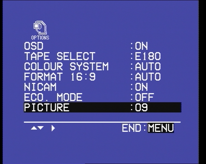

    Hi Oln
    The toshiba doesnt have many options at all im afraid, i can change the sharpness, but it doesnt seem to make any difference.
    [Attachment 79123 - Click to enlarge]
    Cheers
    DMS
