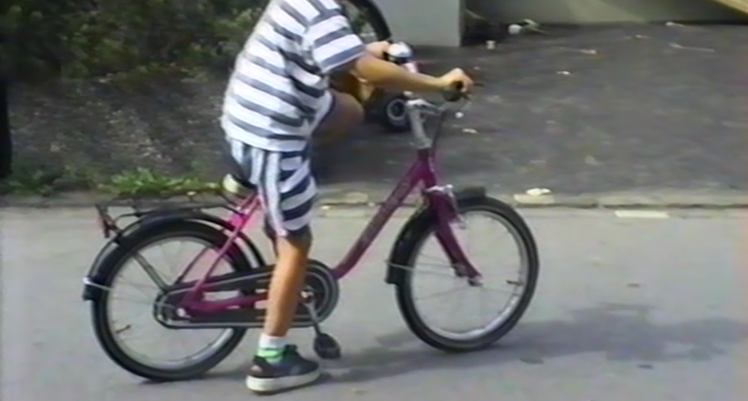

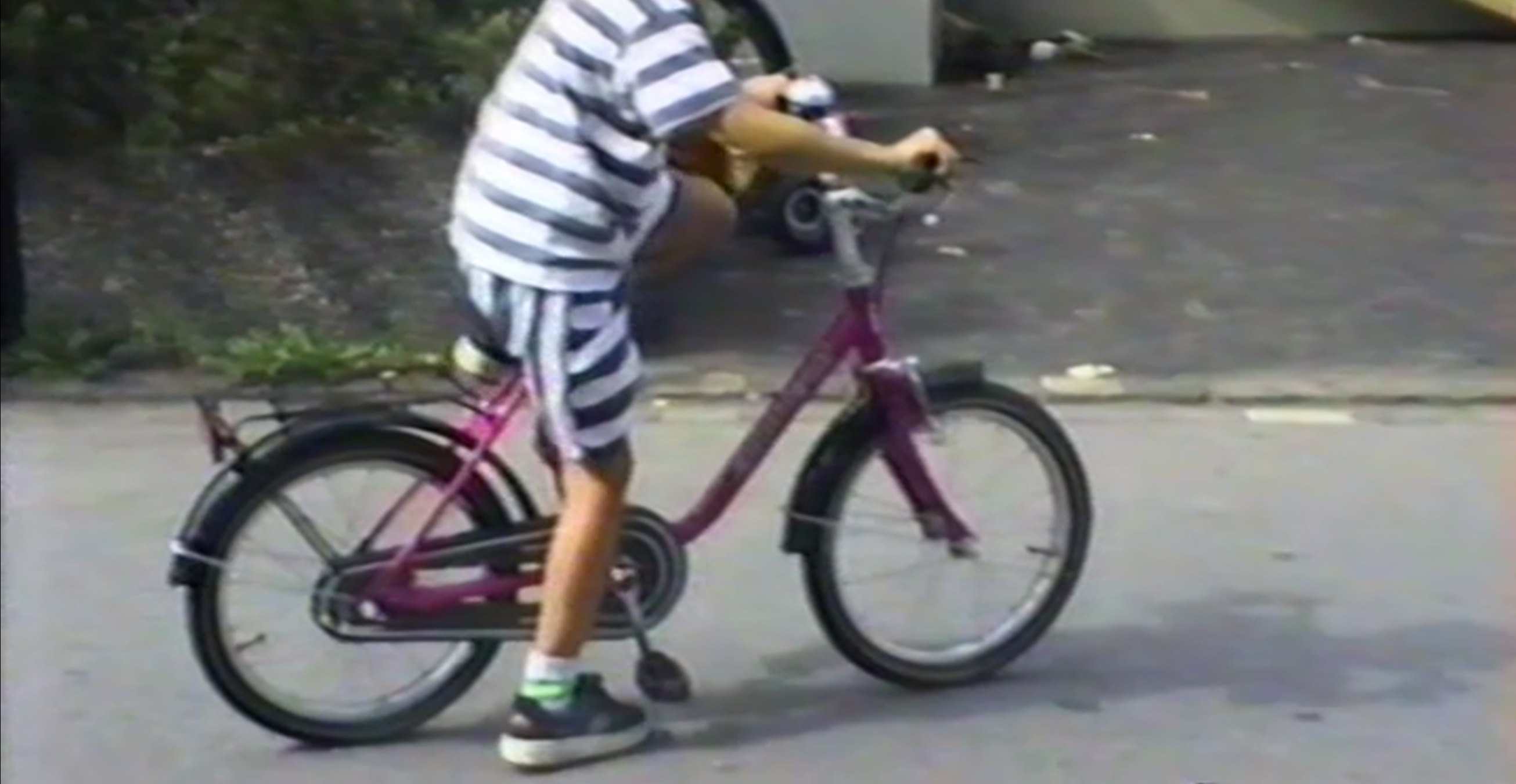

  1. i have two videos and need help with the desicion which of them has the wrong "stretch". I will show you a screenshot of it (because it is a personal video, i cut of the head in the picture). I do deliver not more information on purpose because of a "blind test".
    Which one of these pictures does show a wrong stretch? I ask you that, because i am not 100% sure. It is only about the stretch, not the picture quality.
    I will not tell you (now) what i think which one the "right" one is (or if none of them are).
    I would be glad if some of you could borrow me your eyes for a short time
    Ps. Maybe look at it on full-size and switch with alt+tab or so. Maybe that makes it easier.

    The 'normal' way would be to assess a circle. Slightly harder since the wheels are not full on. But if one is not true then I would have to, personally, say that the lower one is.
  3. Upper is wrong, lower is correct IMO.
  4. Hmm, why the lower one? The wheel from the lower one looks wider than high. I also counted the pixels and the upper one is more circly than then lower one.
    So the lower one is the "Bild53.png" right ?
    What do you mean with assess a circle ? You mean to search a circle in the video? Thats what i tried with the wheel. And the upper one is more circle (when you measure the pixelcount the upper one is more circle). So on the left wheel of the bike.

    'Assess' as in is this a perfect circle ? The lower rear wheel, in my eye, looks slightly elongated.
  6. Originally Posted by DB83 View Post
    Yeah exactly, that what i also see. the lower rear wheel looks elongated. But why should this one be the "good" one? Because you said the lower one is it.
    Edit: And yes, the wheel should be perfectly in front of the camera. But it is very hard to find sth circle (and big) perfectly in front of the camera.

    Surely you asked which has the WRONG stretch and that is how I answered = the lower one
  8. Originally Posted by DB83 View Post
    Ah ups xD
    Thats true.
    So then it is 2 vs 1
    Sharc say the opposite. I think also the upper one is the correct.
    @Sharc: Why do you mean the upper one is the wrong one? Which part did you use for comparing? Or did i also understand you wrong?
  9. The front wheel looks to be more perpendicular to the camera axis with less perspective distortion than the real wheel which is closer to the camera. Also there is a small circle just below the boy's ellbow which looks more circular in the bottom picture.
    Anyway - take the one YOU think is right.
    (If it is an analog PAL VHS capture with small black borders each side stretch it with 12/11 and it should be correct.)
    Edit: My green reference circles on Bild53 (small wheel below the boy's arm and around pedals)

    Rough pixels across the back wheel:
    74: 332 high, 329 wide: 1.009
    53: 418 high, 429 wide: 0.97
    I therefore think that 74 is more accurate, especially given that, if the wheel was moved to be absolutely perpendicular to the camera, it would be elongated, width-wise, which would make 53 even more askew.

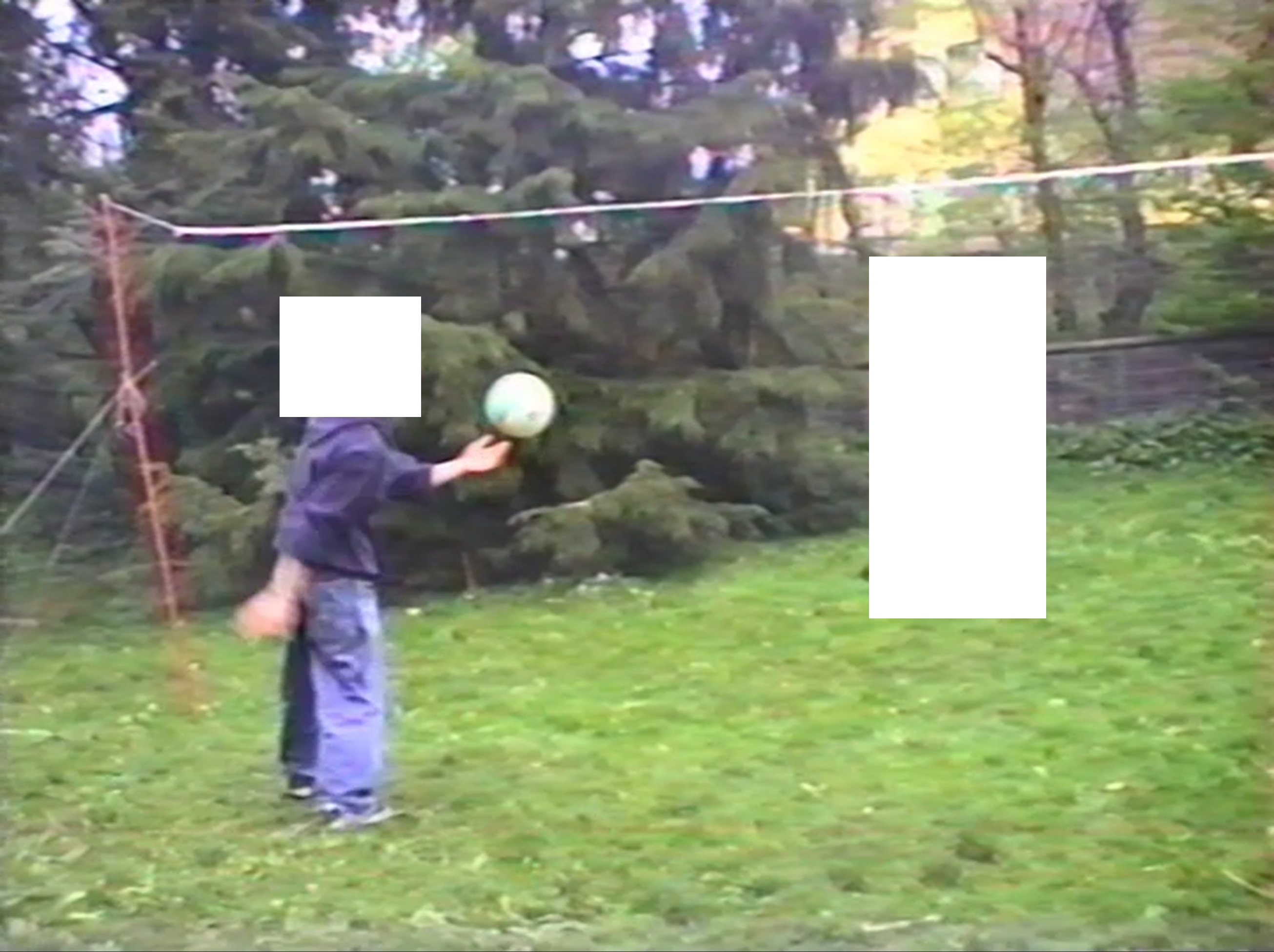

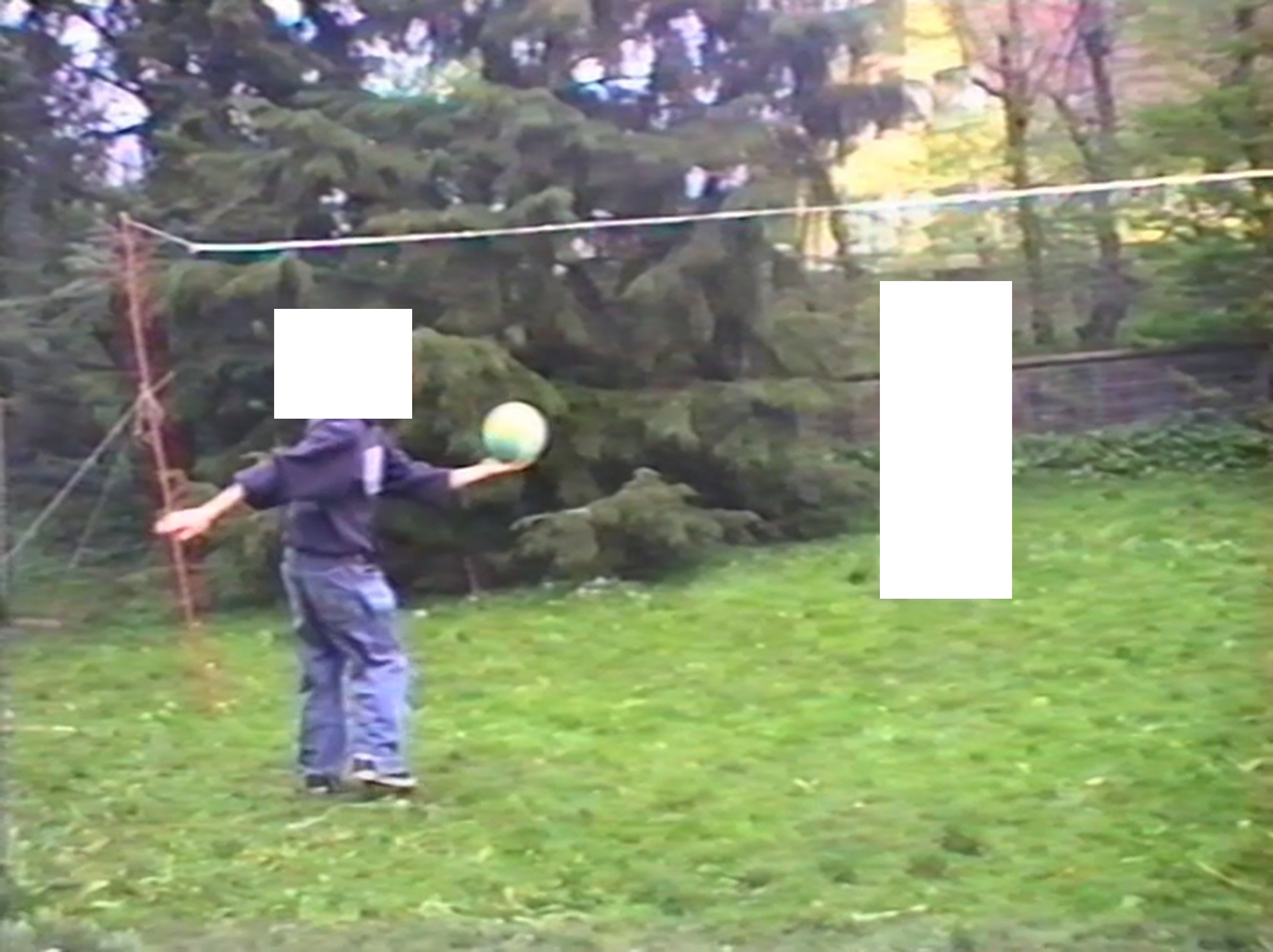

    Ok, i found another scene. It is not a square, but i think it is even better: A ball. A ball should be (in 2D) always a circle, doesnt matter which perspective, isn't it?
    So here is an example. Is this a better one ? The ball is not moving there on this scene, so it sits on his hand.
    Edit: i have even 2 better one: some couple frames later he do lett the ball fall, so the hand is not in the way (but the ball is nearly not moving because it is only 2-3 frames after letting the ball fall):
    (I think the 7 is less stretched. What do you think ?)

    I don't even think one can take the back wheel as a circle reference. It is distorted. Look at the fork of the wheel. Imagine what the fork would look like if the camera was pointed vertically onto the centre of the wheel - as it should for a meaningful circle test. The camera is directed from top&back onto the bike, resulting in a distorted, vertically squeezed wheel, inevitably.
    Anyway, as has been said, that tilted view is useless for a test. The OP just wants to play games, as he got the info about anamorph (=non-square pixels) captures in his earlier thread and should know by now how to capture and convert to square pixels.
    I agree that 7 is less stretched.

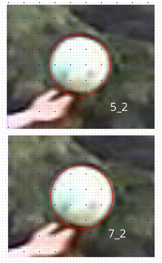

    The balls. I haven't made the balls the same size, but the red circle should be enough. I think 7_2's the winner.

  29. Thanks, what Software do you use for this comparison?
    So i think i will use the 7_2 Version.
    And yes, i still would not upload personal videos in public.
    Just my drawing program, Xara. You should be able to overlay a circle in any of the regular drawing/illustration programs.
