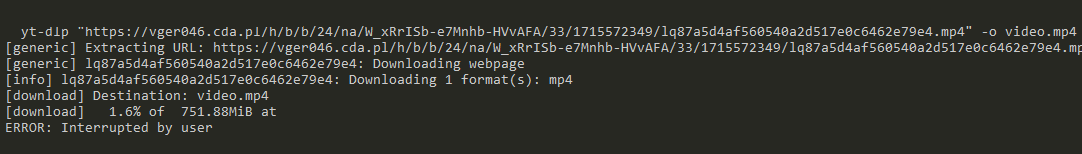

  9. N_m3u8DL-RE work to download from m3u8/mpd (download video/audio segments)
    if you need to download mp4 file, use simply IDM or also yt-dlp with flag -o video.mp4

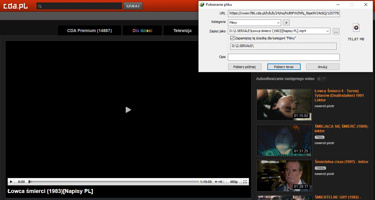

    [Attachment 79049 - Click to enlarge]
    I would use IDM for DRM-free materials

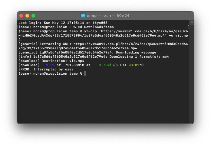

  13. Lomero, which version of yt-dlp are you using? I changed it to the latest one, but now something like this appears:
    [generic] xxxxxxxxxxxxxxxxxxxxxxxxx : Downloading webpage
    ERROR: [generic] Unable to download webpage: HTTP Error 403: Forbidden (caused by <HTTPError 403: Forbidden>)
    EDIT: New yt-dlp solved a problem, and thanks all for help !!

    You have to use the link you got by yourself and not the one the others sent.
    [Attachment 79051 - Click to enlarge]
  15. aqzs: I was using an older version of yt-dlp and that was the reason it didn't want to download correctly and wanted the headers now everything works beautifully
