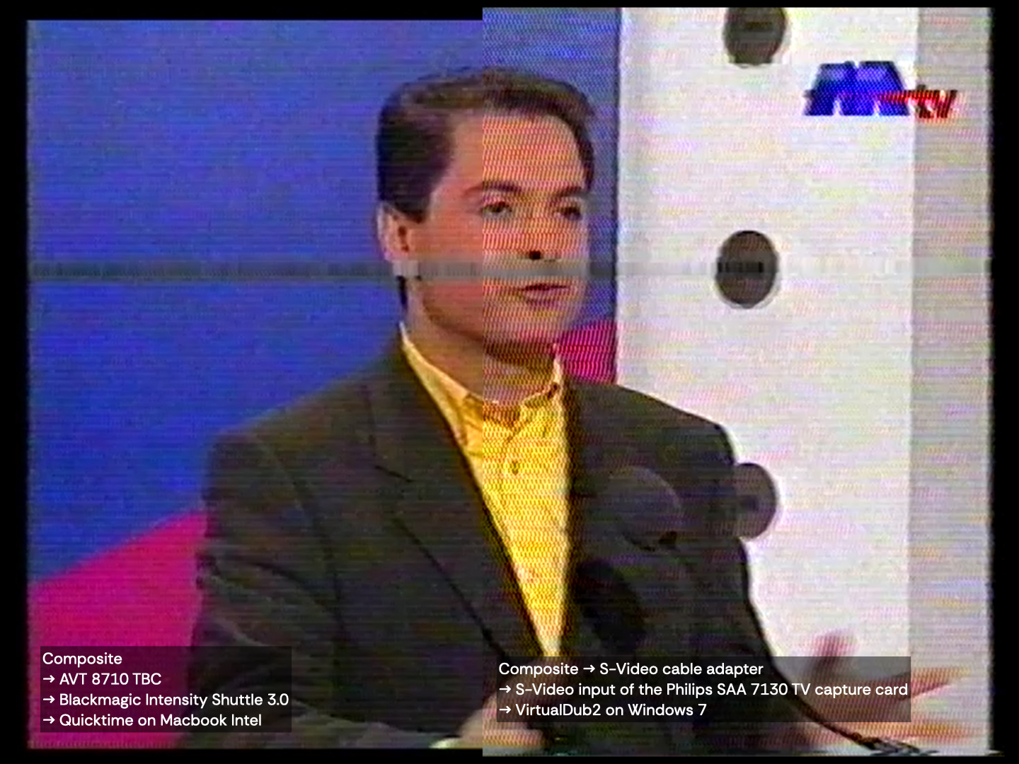

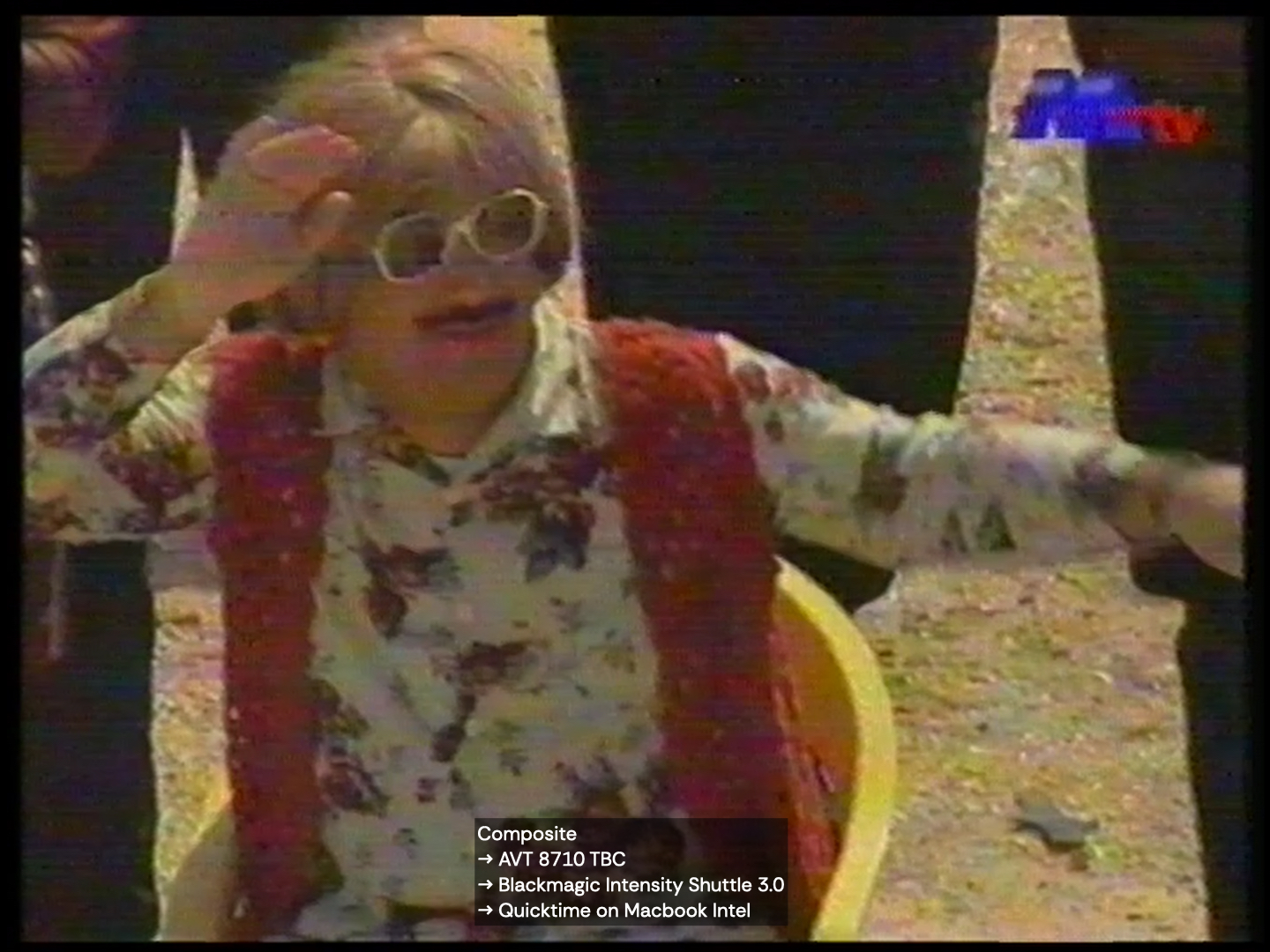

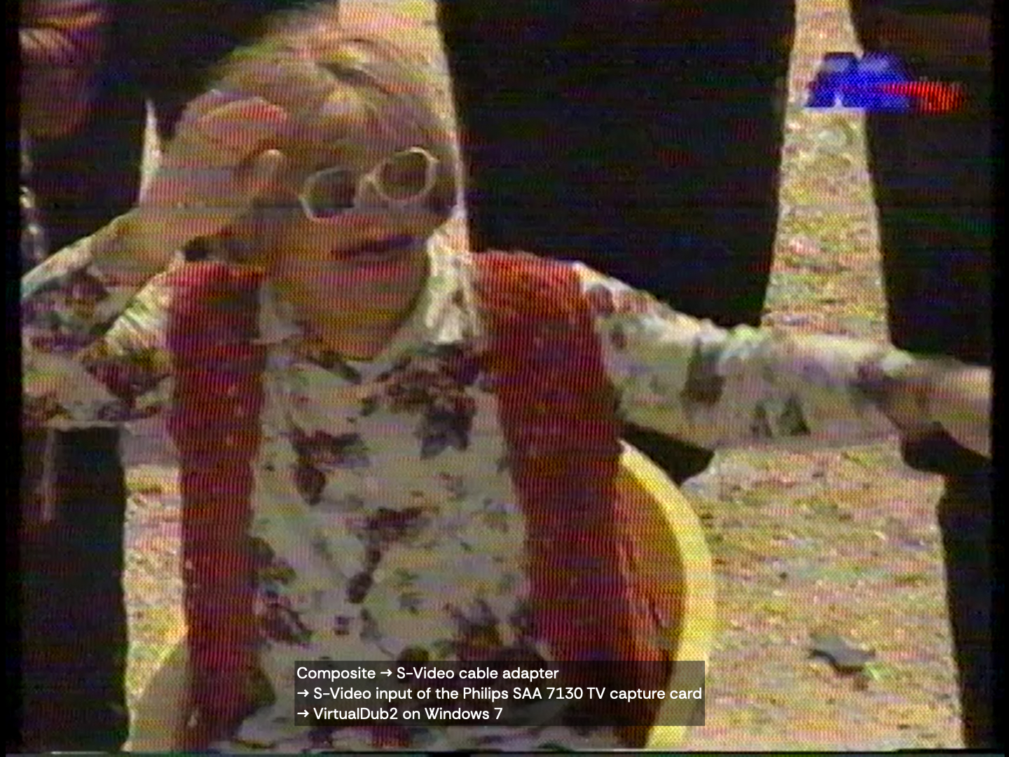

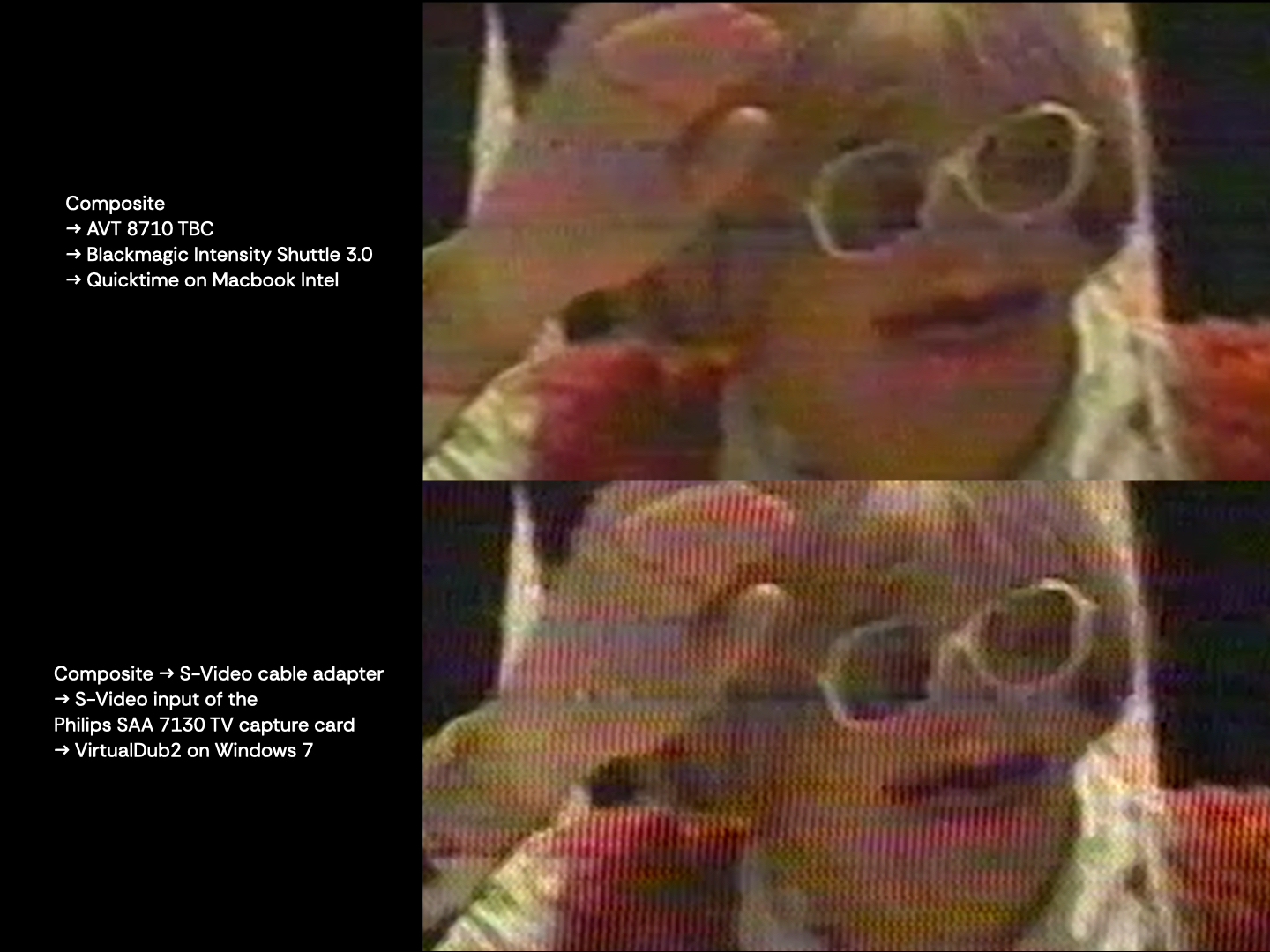

Small update and some additional information.
So I ran another test, and I managed to capture via the S-Video input that I was avoiding in the beginning.
Why does the S-Video have this vertical lines texture over the image? Here are few screenshots:
[Attachment 79088 - Click to enlarge]
[Attachment 79089 - Click to enlarge]
[Attachment 79090 - Click to enlarge]
[Attachment 79091 - Click to enlarge]

The interference pattern looks typical coming from a bad/wrong connected composite/S-Video connection.
(The big dark streak looks tape damage to me.)
What kind of adapter are you using?
A simple passive Composite to S-Video adapter/connector makes no sense and will improve nothing.

And yes, I'm using a simple passive composite to S-Video adapter, so that's why I'm getting the interference pattern.
