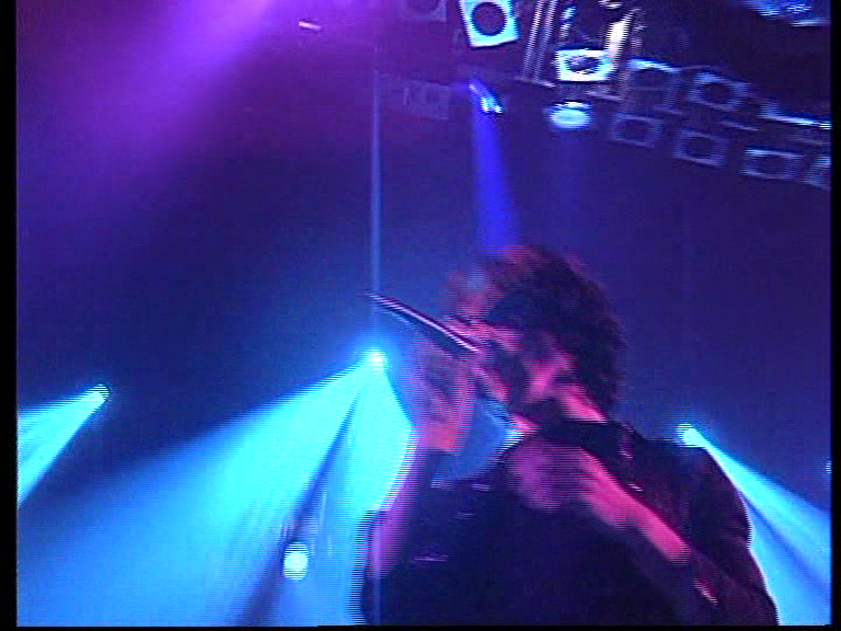

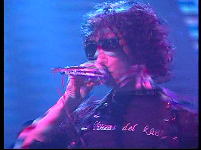

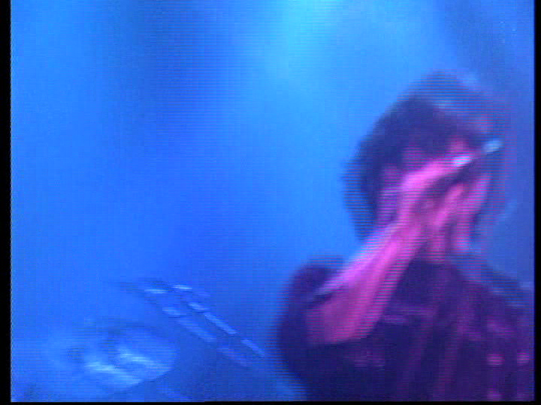

  1. I have this fragment, from a video obtained from a DVD from a few years ago, but it is impossible for me to achieve a clean and deinterlaced image of it.
    [Attachment 78978 - Click to enlarge]
    [Attachment 78979 - Click to enlarge]
    [Attachment 78980 - Click to enlarge]
    [Attachment 78981 - Click to enlarge]
    fragment
    Mar 2008
    In Avisynth
    bwdif(field=3) # bob deinterlace
    srestore()        # match the proper fields
    seems to work OK, revert the clip to 23.976 fps

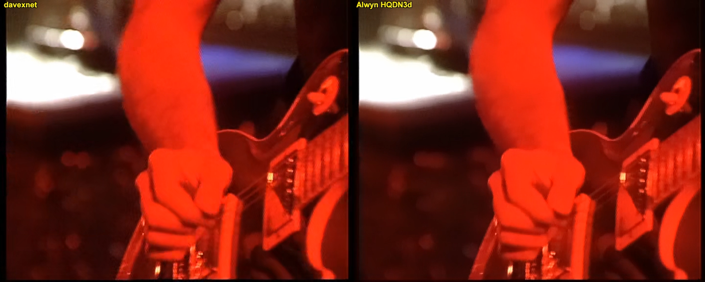

    Here's my go! I like that hqdn Dave.

  4. Originally Posted by Alwyn View Post
    Removes noise and kills the details. See for example the strings of the guitar, pattern on the floor .....
    Don't overdo with denoising.

    It's not "killing" anything, Sharc. The strings are better-off for hqdn. As for the floor, I'm not looking at the floor. Everything's a tradeoff.

  7. Originally Posted by Alwyn View Post
    Look at the strings to the right of the thumb, around frame 130. 3 strings celarly visible in the left picture, while almost gone on the right picture. Not sure which filter contributed most to the smoothing, I didn't check.
    Similar with other low-contrast details. Tradeoff, yes. Not to critizise or prefering anything, just a hint.

    You can always use HQDN3d with a lower setting; it's all a compromise.
    I just found a strength of 6.5 seemed to be OK for that video with the guys and gals dancing in the desert
    from a couple of days ago.
    I gravitate towards this kind of relatively fast filter because my PC is old and slow!

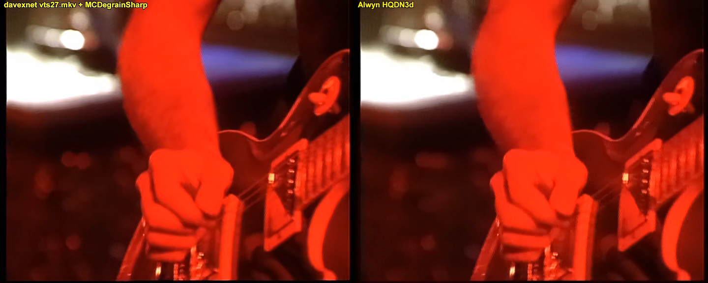

  9. Originally Posted by Alwyn View Post
    @sharc, just curious, how would you tackle this video?
    Perhaps something like this (left video is based on post#2 as a source plus filtered with MCDegrainSharp)
    See the text jaggies in the 2nd example.

  10. Originally Posted by davexnet View Post
    Yes, speed is just one more dimension of "quality".

      tmp = pre.BicubicResize (width/2,height/2)
      emask = tmp.mt_edge (mode="prewitt", thY1=25, thY2=25, chroma="-128")
      if ( true ) {
        pre_ds = mt_merge (tmp, RemoveGrain(tmp,0), emask, luma=true).vsDegrainMedian(5,5,modeY=2)
        sc_ds  = pre_ds.MSuper (hpad=0,vpad=0, mt=mt)
        mv_ds  =  sc_ds.MAnalyse (multi=true, delta=tr, blksize=bs, mt=mt, scaleCSAD=scaleCSAD, dct=dct)
        mv_dsr =  sc_ds.MRecalculate (mv_ds, tr=tr, blksize=bs/2, overlap=overlap, thSAD=100, mt=mt, scaleCSAD=scaleCSAD, dct=dct)
        mv     =  mv_dsr.MScaleVect(2)
        MDegrainN (sc_full, mv, tr, thSAD=thSAD, thSAD2=thSAD2, limit=limit, mt=mt) }
      Crop(8,8,-16,-8)
      #### Optional post-denoise sharpening
      #CAS(0.5)
  28. Member
    May 2005
    Australia-PAL Land
    @Buzz, thank you, working well now.
  29. Slightly different interpolating approach
    ffms2("VTS_27_1 videohelp.mkv")
    assumeTFF()
    QTGMC(preset="fast")
    Selectevery(4,1,3) #25fps
    #25->50 interpolation:
    z_ConvertFormat(pixel_type="RGBPS", colorspace_op="709:709:709:l=>rgb:709:709:f")
    RIFE(gpu_thread=1, model=28, fps_num=50000, fps_den=1000, sc=true, sc_threshold=0.12)
    z_ConvertFormat(pixel_type="YUV420P8", colorspace_op="rgb:709:709:f=>709:709:709:l")
  30. Originally Posted by Sharc View Post
    assumeTFF()
    Interesting, is there a way to try it in StaxRip?
