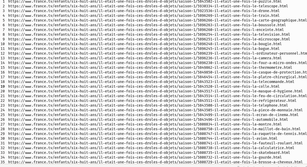

 Addon for Chrome Link Klipper
 https://chromewebstore.google.com/detail/link-klipper-extract-all/fahollcgofmpnehocdgo...kchiekoo?pli=1
 Extract all links and put them in a file "list.txt"
 [Attachment 78938 - Click to enlarge]
 Use yt-dlp to download
 Code:yt-dlp -a list.txt
 [Attachment 78939 - Click to enlarge]

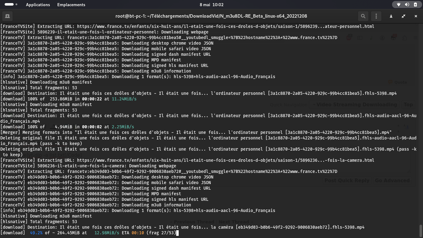

 On Windows running:
 Will create an "france.tv.txt" size 21.232 with only 78 lines and YT-DLP comes up with ERROR:Code:france.tv.py > france.tv.txt
 If I copy the 78 lines and paste into Notepad "franceX.tv.txt" it's size is 10.613 for the 78 lines and YT-DLP works ..Code:[generic] Extracting URL: https://www.france.tv/enfants/six-huit-ans/il-eta...uzzle.html ERROR: [generic] 'h\x00t\x00t\x00p\x00s\x00:\x00/\x00/\x00w\x00w\x00w\x00.\x00f\x00r\x00a\x00n\x00c\x00e\x00.\x00t\x00v\x00/\x00e\x00n\x00f\x00a\x00n\x00t\x00s\x00/\x00s\x00i\x00x\x00-\x00h\x00u\x00i\x00t\x00-\x00a\x00n\x00s\x00/\x00i\x00l\x00-\x00e\x00t\x00a\x00i\x00t\x00-\x00u\x00n\x00e\x00-\x00f\x00o\x00i\x00s\x00-\x00c\x00e\x00s\x00-\x00d\x00r\x00o\x00l\x00e\x00s\x00-\x00d\x00-\x00o\x00b\x00j\x00e\x00t\x00s\x00/\x00s\x00a\x00i\x00s\x00o\x00n\x00-\x001\x00/\x005\x008\x004\x003\x005\x000\x002\x00-\x00i\x00l\x00-\x00e\x00t\x00a\x00i\x00t\x00-\x00u\x00n\x00e\x00-\x00f\x00o\x00i\x00s\x00-\x00l\x00e\x00-\x00p\x00u\x00z\x00z\x00l\x00e\x00.\x00h\x00t\x00m\x00l\x00' is not a valid URL. Set --default-search "ytsearch" (or run yt-dlp "ytsearch:https://www.france.tv/enfants/six-huit-ans/il-etait-une-fois-ces-droles-d-objets/saison-1/5843502-il-etait-une-fois-le-puzzle.html" ) to search YouTube [generic] Extracting URL: ERROR: [generic] '\x00' is not a valid URL. Set --default-search "ytsearch" (or run yt-dlp "ytsearch:" ) to search YouTube
	france.tv.py | yt-dlp -a - --write-subs
 Reading URLs from STDIN - EOF (Ctrl+Z) to end:
 [FranceTVSite] Extracting URL: https://www.france.tv/enfants/six-huit-ans/il-etait-une-fois-ces-droles-d-objets/saiso...le-puzzle.html
 [FranceTVSite] 5843502-il-etait-une-fois-le-puzzle: Downloading webpage
 [FranceTV] Extracting URL: francetv:ec7305f8-f877-4d83-b12a-6cbaa1e9ed76#__youtubedl_smuggle=%7B%22hostname%22 %3A+%22www.france.tv%22%7D
 [FranceTV] ec7305f8-f877-4d83-b12a-6cbaa1e9ed76: Downloading desktop chrome video JSON
 [FranceTV] ec7305f8-f877-4d83-b12a-6cbaa1e9ed76: Downloading mobile safari video JSON
 [FranceTV] ec7305f8-f877-4d83-b12a-6cbaa1e9ed76: Downloading signed dash manifest URL
 [FranceTV] ec7305f8-f877-4d83-b12a-6cbaa1e9ed76: Downloading MPD manifest
 [FranceTV] ec7305f8-f877-4d83-b12a-6cbaa1e9ed76: Downloading signed hls manifest URL
 [FranceTV] ec7305f8-f877-4d83-b12a-6cbaa1e9ed76: Downloading m3u8 information
 [info] ec7305f8-f877-4d83-b12a-6cbaa1e9ed76: Downloading subtitles: qsm
 [info] ec7305f8-f877-4d83-b12a-6cbaa1e9ed76: Downloading 1 format(s): hls-5398+hls-audio-aacl-96-Audio_Français
 [info] Writing video subtitles to: Il était une fois...ces drôles d'objets - Il était une fois… Le puzzle [ec7305f8-f877-4d83-b12a-6cbaa1e9ed76].qsm.vtt
 [hlsnative] Downloading m3u8 manifest
 [hlsnative] Total fragments: 53
 [download] Destination: Il était une fois...ces drôles d'objets - Il était une fois… Le puzzle [ec7305f8-f877-4d83-b12a-6cbaa1e9ed76].qsm.vtt
 [download] 100% of 12.65KiB in 00:00:06 at 1.83KiB/s
 [download] Destination: Il était une fois...ces drôles d'objets - Il était une fois… Le puzzle [ec7305f8-f877-4d83-b12a-6cbaa1e9ed76].fhls-5398.mp4
 [download] 9.7% of ~ 258.86MiB at 846.34KiB/s ETA 04:44:05 (frag 5/53)
