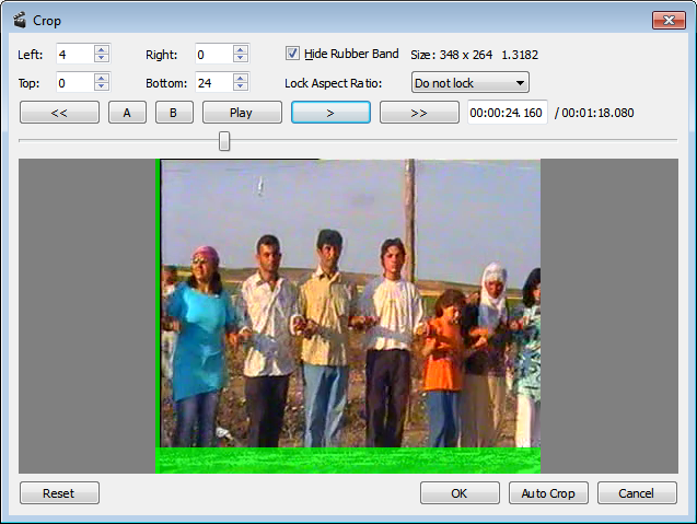

    If there is so much (consistent) tracking noise and you have no option to recapture it better, you can cut the static away and fill/re-center the picture.
    Something like this for example:
    [Attachment 78921 - Click to enlarge]

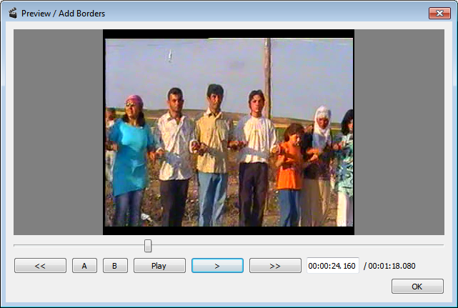

    Add borders to make the video original size again:
    [Attachment 78922 - Click to enlarge]

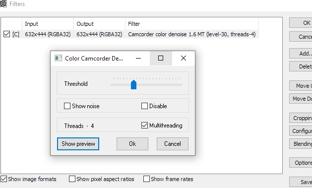

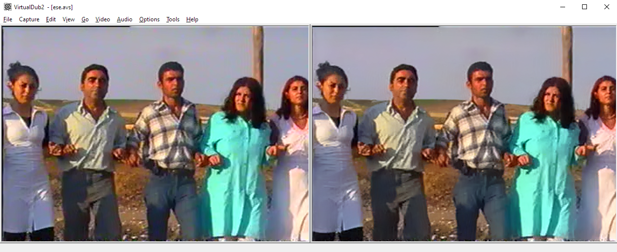

    Here's my attempt, using Virtual Dub2-64bit for resizing to 4:3 (assuming it is that), denoising with Camcorder Colour Denoiser and Neat Video (which is a paid plugin), Mercalli (paid-program) for stabilisation and Magix Movie Studio for per-scene cropping (to remove bottom static) and export. File DAR is 1:1 (1440x1026). Bitrate can be cranked up if desired.

    Just tried it, looks good. I put VDub CCD on top of it and it is even better.
