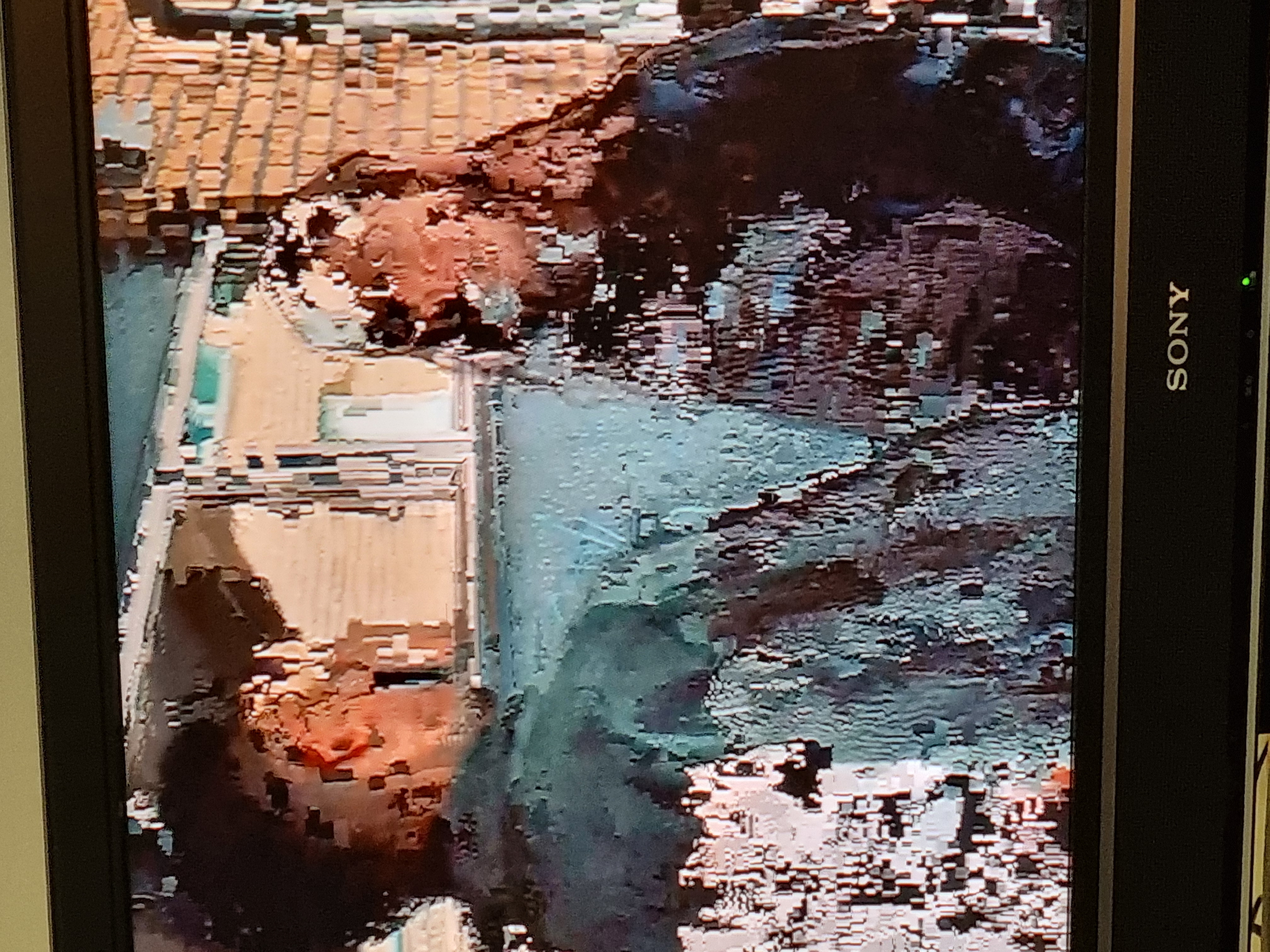

    Subfile I have is a converted .srt into a mpeg-ts stream (compatibel with FFMPEG) with .dvb extention. I use a dedicated softwere for this conversion. So then I use FFMPEG to mux the files togheter. But I have also tryd using Subtitle Edit to convert det the .srt file to a idx and sub file but the oucome is the same.
    I have a friend that has access to Telestream Vantige (https://www.telestream.net/vantage/overview.htm) and when he mux the files togehetr the file is playing fine. So I am woundering what is FFMPEG doing that makes the file unplayable on the device.
    Added an image of how it looks like when its played on the divece and a line is dipslayed:
    [Attachment 78890 - Click to enlarge]
