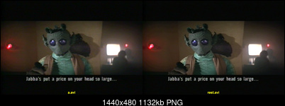

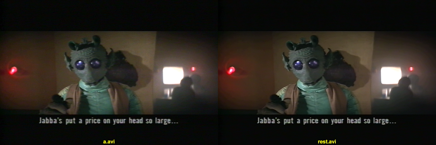

    On my LD captures, I generally only apply a basic filtering:
    video_org=AviSource("StarWars4LDclip-org.avi")
    # IVTC
    video_org_ivtc=video_org.AssumeTFF().TFM(order=1, mode=0, PP=0, slow=2, field=1).TDecimate()
    ### convert to YV16
    deinterlaced_yv16=video_org_ivtc.convertToYV16()
    ### denoising
    denoised_yv16=deinterlaced_yv16.TemporalDegrain2(degrainTR=3)
    ### convert to YUY2
    denoised=denoised_yv16.convertToYUY2()
    ### convert to YV12
    denoised_yv12=denoised_yv16.convertToYV12()
    ### sharpening
    sharpened_yv12=denoised_yv12.LSFmod(defaults="slow")
    ### convert to YUY2 with chroma from YUY2 color space
    restored=sharpened_yv12.convertToYUY2().MergeChroma(denoised)
    return(restored)
    comparison side by side:
    comparison with slider:
    https://imgsli.com/MjYxNjEw
    restored video:
    rest.avi
