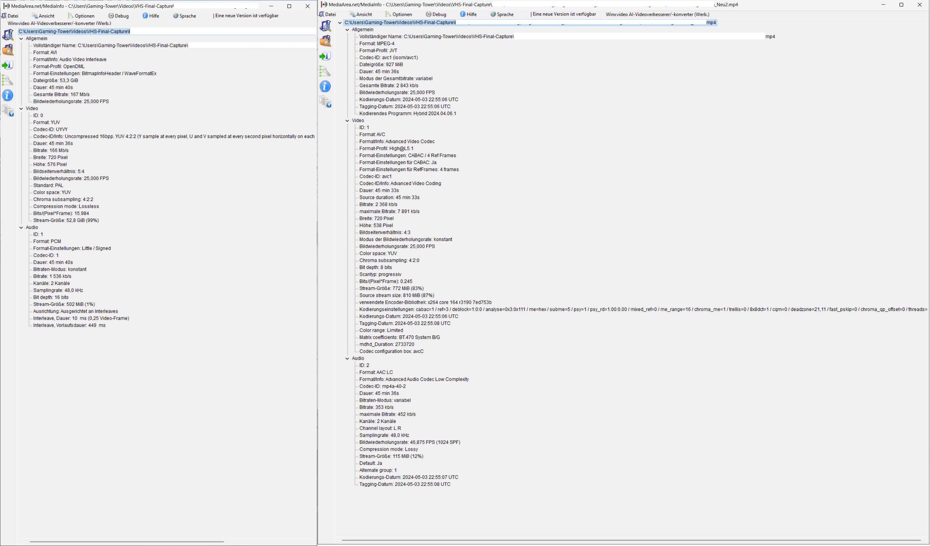

  6. I think the two videos have different framerates (fps).
    A mediainfo report (text mode) from both videos (the capture and the encoded one) could help.
  7. Originally Posted by ProWo View Post

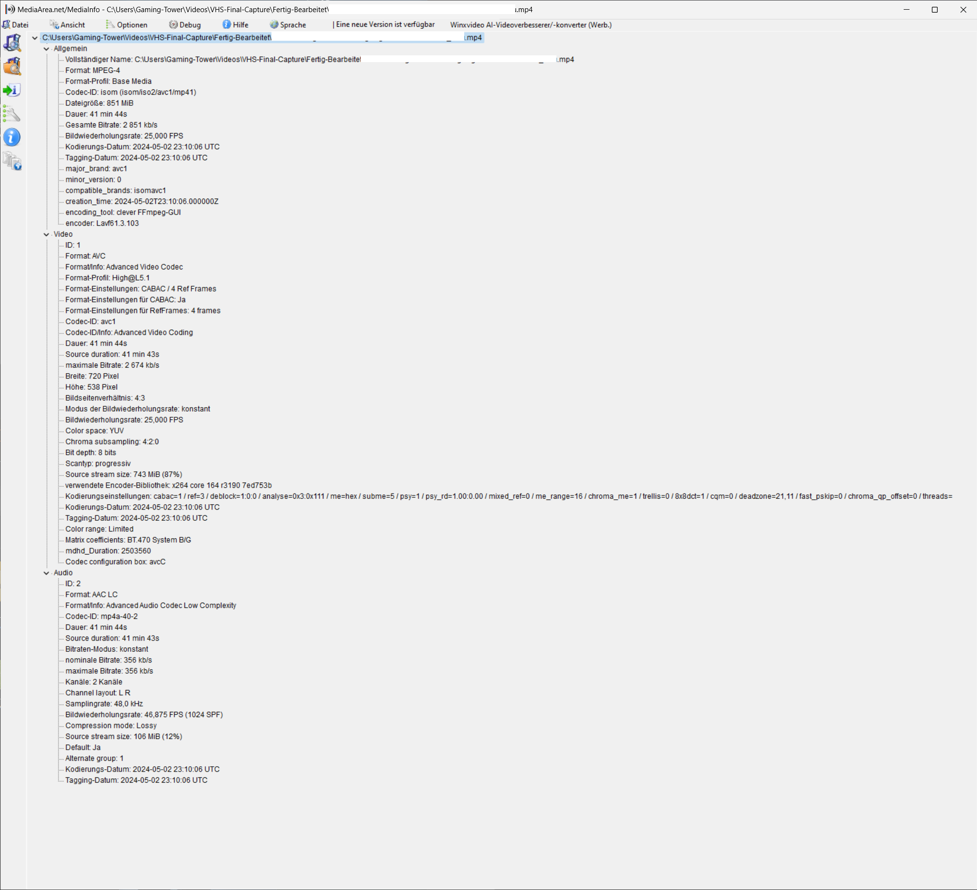

    Sure, i can do that, but the video has no different framerates. It would also not be possible to watch 16 minutes side by side without a video-delay (and also no audio delay), if they would have different framerates. But here is the screenshot:
    To say it again: The video (and also audio) has no delay, when i play them side by side. But when i jump somewhere (on the timeline), then i get directly a async on the video (not the audio. The audio is sync between the two videos when playing side by side from (for example) 36minutes, but the video is totally async on the encoded one). And btw: I did now several test with different encodings. So only a h.264 encode with pcm to AAC (because of mp4 container) --> same result. One time i did it with h.264 and mkv and did not even touch the audio (no reencode) and same problem. One time i used NVENC H265 and same result... I did not apply any other filter or sth like that.
    Edit: Here the second picture (with only one media-info window) is an example of a other vhs-video (encoded with hybrid), which is totally fine. no video-delay after skipping. So it is very strange. I did recapture the vhs-video btw 3 times and it is always the same. The capture is fine, but the encode is ugly. It does not only happen on this one, also 3-4 other videos are affected by this problem.

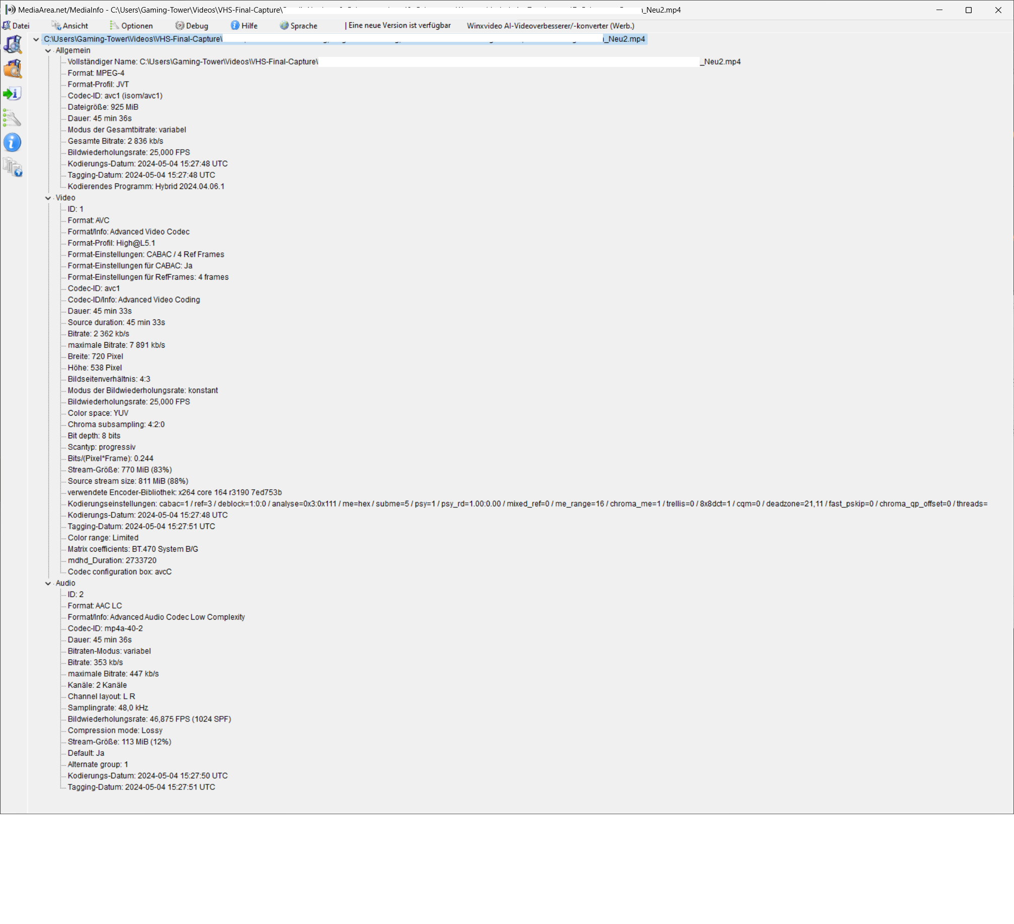

  8. The two videos have different lengths. 45:33 and 41:43.
  9. 2 comments:
    With captured avi, the audio track is 4 seconds longer than the video track. This should perhaps be adjusted before re-encoding.
    Re-encoding with profile high@L5.1 is total nonsense for a 720x538 resolution. Here main@3.0 would be better.
    I think if you adjust the audio track of the avi file to the video track and then re-encode it, the sync problem will also disappear.

  16. Update: It did NOT work with cutting the audio before!!
    I cut the audio from 45min 40sec to 45min 36sec as in the video (there was a dead line with no sound for the last 4 seconds). Then loaded this audio in hybrid and did an encode.... It did not work.
    Last time it was like that (look on picture above): Raw video was 45min 36sec video and 45min 40sec audio and the encoded was 45min 33sec video and 45min 36sec audio. NOW the new encode is 45min 33sec video and 45min 36sec audio.
    So the video still gets cut down to far. BUT as i said: The video is totaly fine when played, it is just wrong, when you jump to a specific time. Then the video is completly wrong!
    Has anyone an idea?
