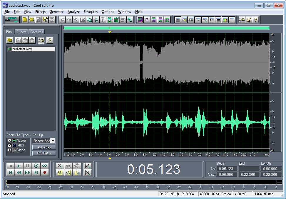

  10. Member The_Doman's Avatar
    Feb 2004
    Netherlands
    Originally Posted by The_Doman View Post
    Well, if there is no alternative audio track you can switch to (Linear/HiFi Stereo Audio) you can't do anything about it during capture.
    It appears the source you have is recorded with a Stereo-HiFi track.
    Also the sound on the first clip is clean on the right channel.
    So start investigate/experimenting switching between the stereo left/right and mono audio track on your VCR when capturing and listen what is going on exactly?
    Here the right audio track of the first clip sounds perfectly fine?
    And yes, that's an old school program.

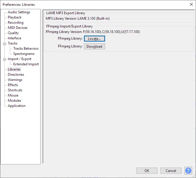

    Mar 2008
    Originally Posted by Platos View Post
    Edit: The portable version from audacity does not allow you to choose a ffmpeg directory. only the installed version.
    You can choose it using preferences/library
