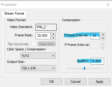

    Hi
    Im curious to know what the Compression settings are for in the Capture Pin section in VirtualDub, both the fields are editable for me and i was wondering if this would make any difference to my captures?
    thanks in advance.
    DMS
    [Attachment 78800 - Click to enlarge]

    Which version of VirtualDub are you using? What codec are you using? For lossless the blue highlighted fields have no effect.

    Ahh ok, so its VD2 and i capture using Lagarith, so this will not have any affect then. thanks for clarifying.

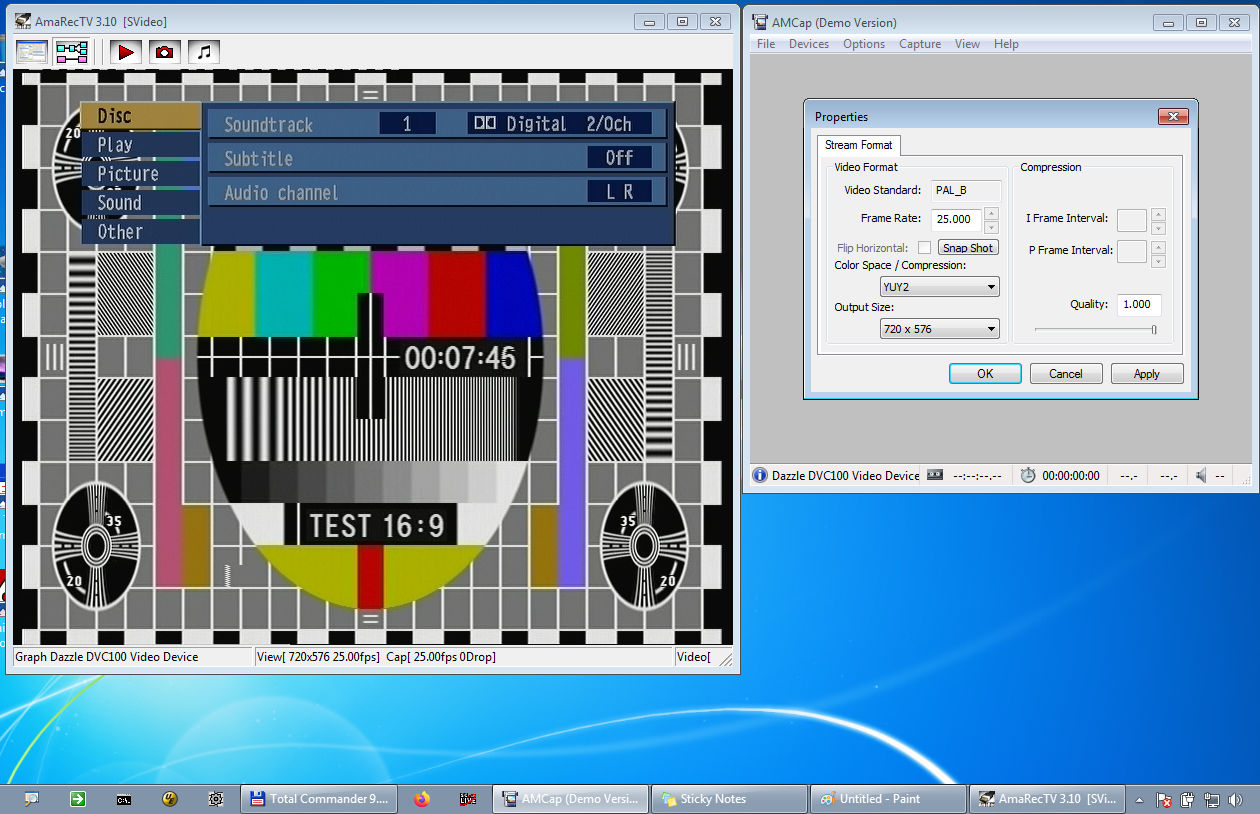

  10. Member The_Doman's Avatar
    Feb 2004
    Netherlands
    Originally Posted by DMS View Post
    My device is iodata gv-usb2, and it was defaulted at 0.500. i may do a comparison, see if i notice any difference, but it sounds like it may affect only when capturing with a lossy codec.
    To be sure i would set it to max/1.000 quality.
    If i set the quality settings below max/1.000 it destroys the image totally.
    That setting is permanent for all capture programs, as with the procamp controls.
    When i change it, it goes into effect when restarting/re-initializing the used capture program.
    When you use a low quality source and/or small preview window you possible won't notice it directly.
    Again, results/effect with other cards/drivers can/will be different of course.
    Dazzle DVC100 quality set to 1.000
    [Attachment 78806 - Click to enlarge]

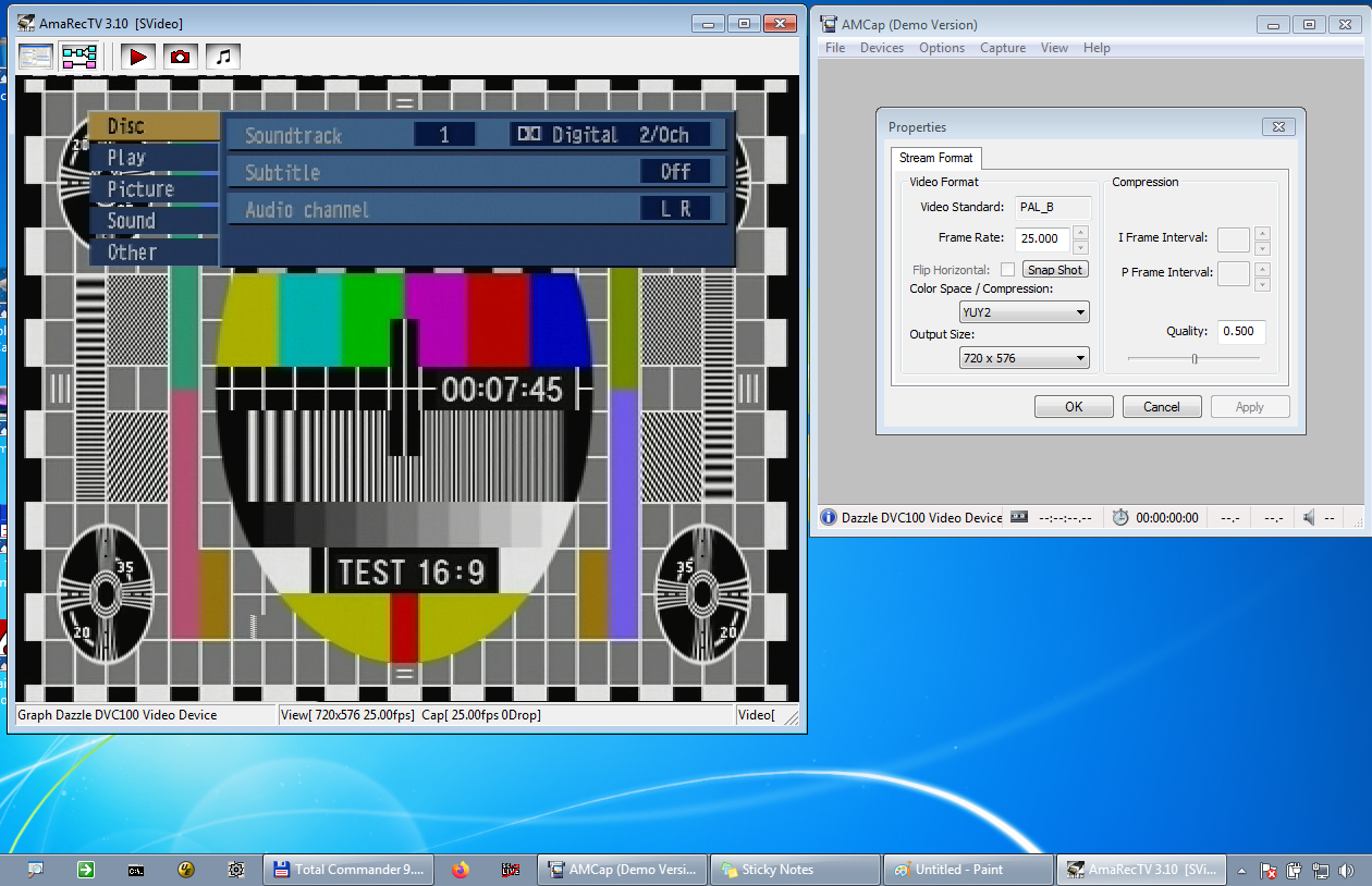

    Dazzle DVC100 quality set to 0.500
    [Attachment 78807 - Click to enlarge]
