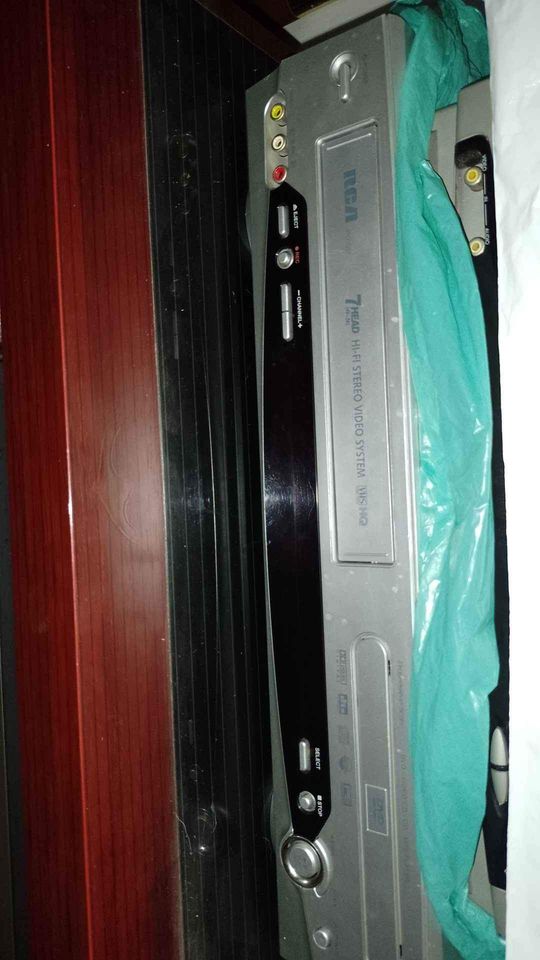

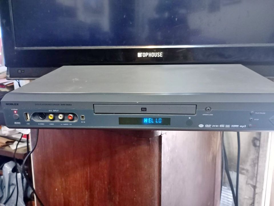

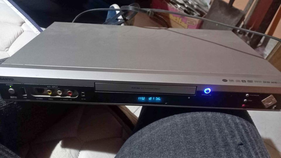

    Hello! I'm looking for a DVD player that will work as a TBC or stabilize my VCR signal. I want to capture with my Blackmagic Design Intensity Pro from 2007 PCI-E.
    I get these DVD players in local market:

    NOBLEX

    SANYO

    RCA
    Would any DVD player with video input and output work?
    thank you
