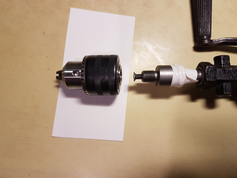

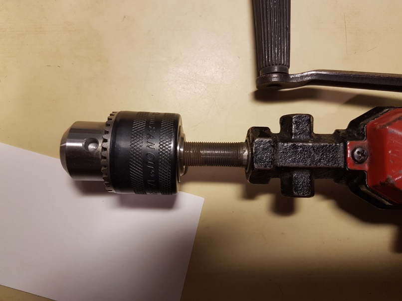

    I have an old hand drill that I used to drill holes in wood. Over time the chuck broke and I couldn't find an original replacement.
    Over a month ago I decided to buy a new chuck. I ordered one that seemed to be able to fit into the hand drill.
    Today I received it (long wait indeed). The chuck looks really great even better than the dead one.
    When I tried to screw it on, it went only few threads and stopped.
    The new chuck thread is 1/2-20UNF so I am guessing my drill has a threading of 1/2-20 UNC or 13mm (metric size) and this is why it wouldn't go any further.

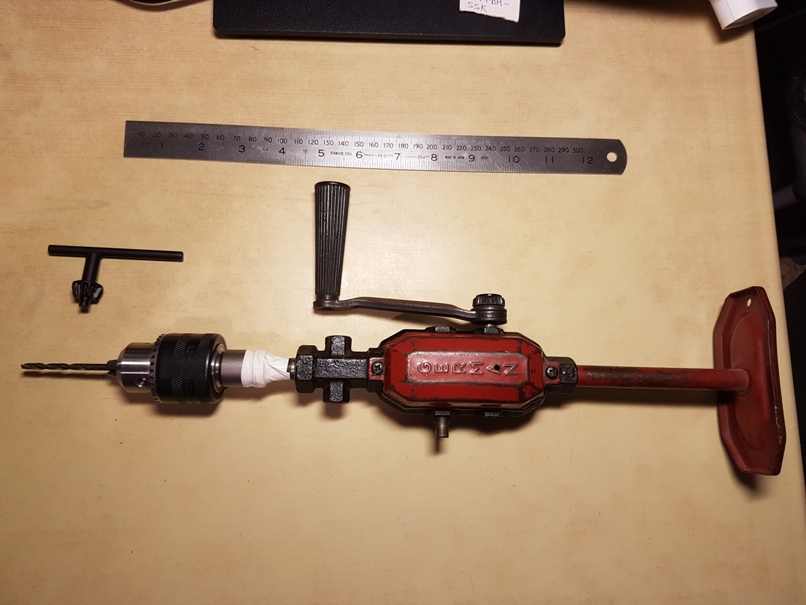

    In the end I found a working solution using an accessory that I ordered together with chuck. It has a square opening but it went inside the drill and I fixed it with adhesive tape. Well it works now but I would like to know if there is a better option.
    What I need is a coupler or adapter that has different thread pitch on both sides.
    Can anyone think of a better solution, without the need to order a custom design?

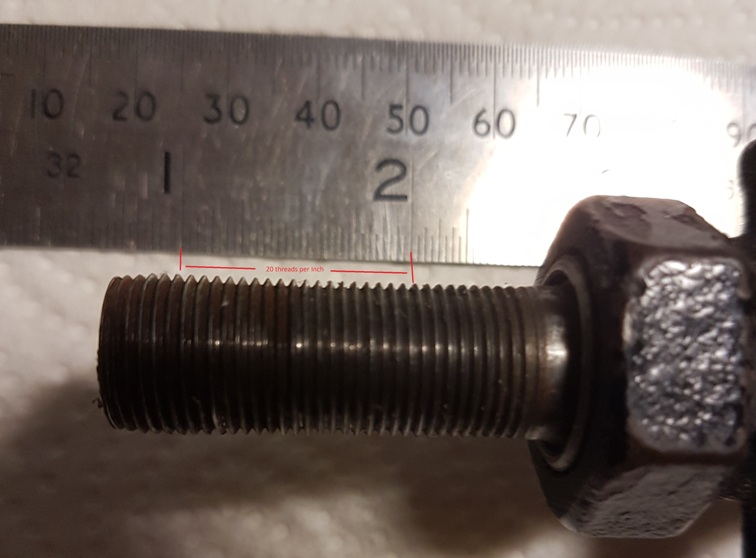

    I took few images and enlarged them so that I would be able to count the number of threads per Inch on my hand drill.
    As seen from the photo, I counted 20 threads per inch which means this drill was made to metric standards and not imperial, because 1/2 Inch UNC can only have 13 threads and it can't be 1/2-20 UNF because the chuck wouldn't screw onto the drill. I am guessing that the diameter is NOT 1/2 Inch (13mm) BUT possibly M12 with standard pitch of 1.25mm which makes it 20 threads per inch, as seen in the image.
    Unfortunately the adapter 1/2-20 UNF to 1/2-28 UNEF is not going to help, as I need 20 threads on the drill side and not 28 threads.

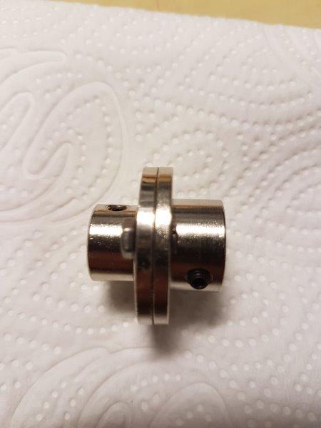

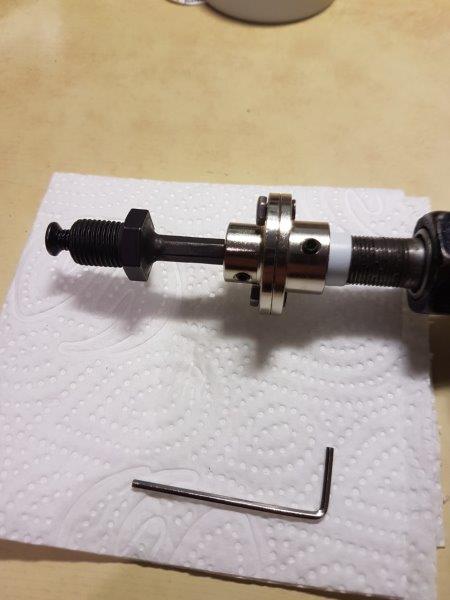

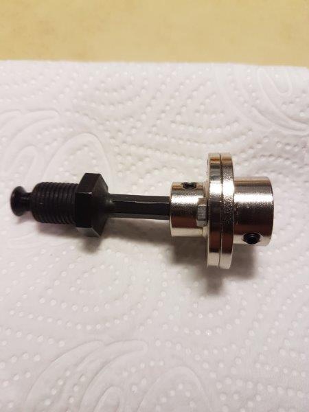

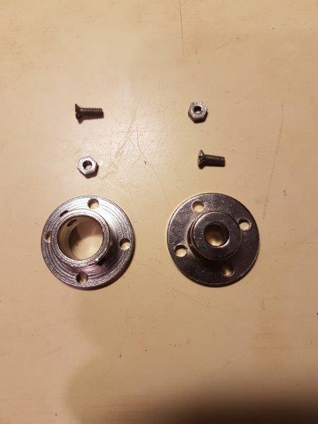

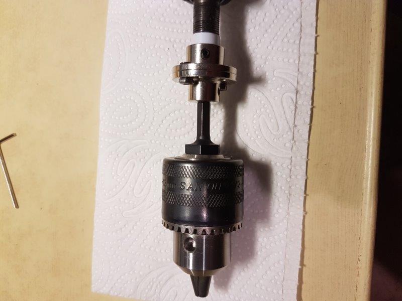

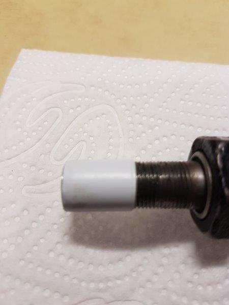

    I finally got the drill to work relatively stable.
    Ordered flanged rod coupling size 7mm and 14mm (unfortunately they didn't have 1/2 Inch size which is 12.7mm or 13mm only 14mm). So I had to wrap the drill shaft with masking tape to increase the diameter to 14mm.
    The couplings come with set screws and they have a really good grip on the parts.
    The images show the installation process. The drill works fine but it is not 100% straight. Nothing serious, at least now I can drill away without the chuck coming out of the drill shaft.
