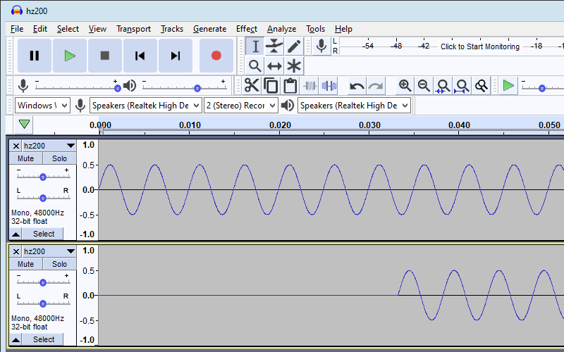

  8. The reason for adding a short silence to the start of the compression has to do with the way audio compression works. Here's an example:
    [Attachment 78775 - Click to enlarge]
    On the top is the start of a WAV file (uncompressed PCM). Below is the same audio converted to aac. You can see the aac encoder added about 33 ms of silence to the start of the audio. You can't see it here but the aac encoding also added some silence to the end of the audio.
    Rather than removing a short bit before compression you can add an audio advance (a negative delay) at the container level when muxing.
