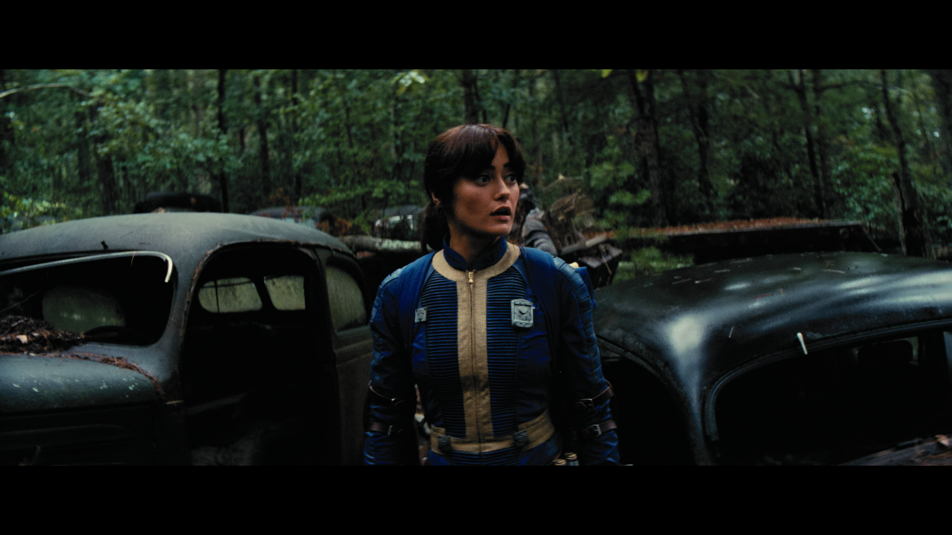

Here are some screenshots so you have a visual representation of what we are talking about
This is how the shader worked before your tweaks, it targets the set srgb threshold "float Thresh = 45.0/255.0"
[Attachment 78736 - Click to enlarge]
This is the normal image without any shaders or when I run the shader with your tweaks
[Attachment 78737 - Click to enlarge]

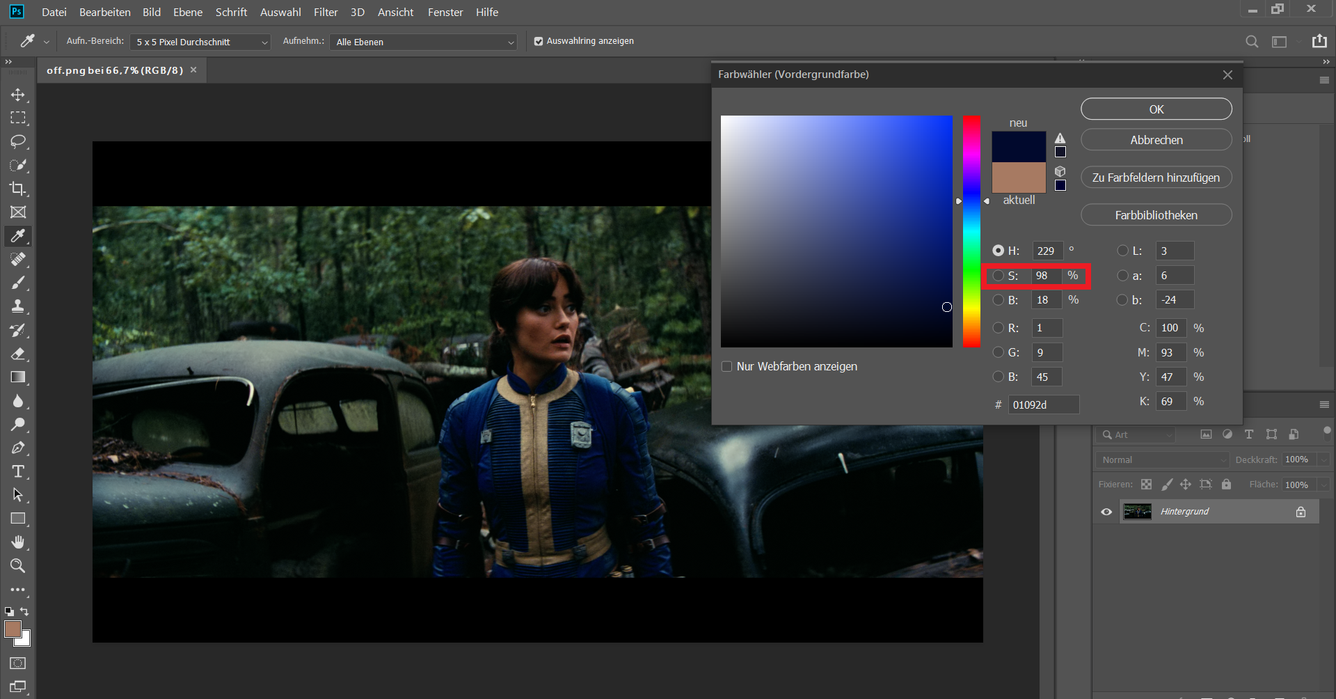

Here you can see the saturation of the suit, it's at 98%, so it shuld be affected by the shader
[Attachment 78738 - Click to enlarge]Last edited by geextah_2; 30th Apr 2024 at 12:23.

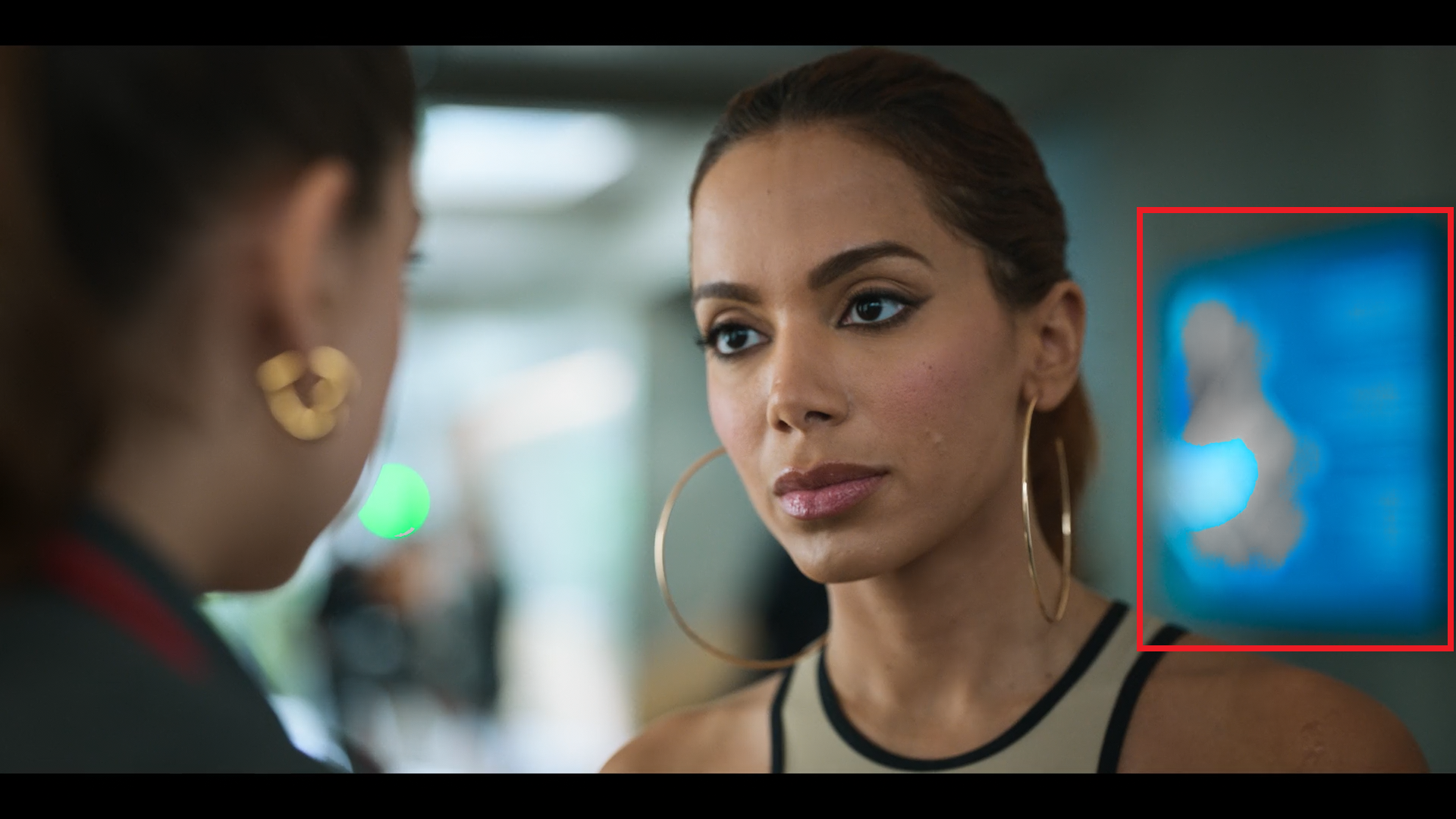

This is an improved version, with less hard edges, better smoothstep
Here you can see the comparisonCode://!PARAM vibr //!DESC Saturates/deSaturates //!TYPE float //!MINIMUM -1 -0.5 //!HOOK MAIN //!BIND HOOKED //!DESC Vibrance #define CoefLuma vec4(0.2126, 0.7152, 0.0722, 0) //sRGB, HDTV float Thresh = 200.0/255.0; float w = 10.0/255.0; vec4 hook() { vec4 c0 = HOOKED_texOff(0); float lum = (c0.r + c0.g + c0.b)/3.0; float colorSat = max(max(c0.r, c0.g), c0.b) - min(min(c0.r, c0.g), c0.b); vec3 sat = mix(vec3(dot(c0, CoefLuma)), c0.rgb, 1+vibr - colorSat*abs(vibr)); float delta = smoothstep(Thresh-w, Thresh+w, lum); sat = mix(sat, c0.rgb, delta); delta = smoothstep(0.8, 0.9, colorSat); c0.rgb = mix(c0.rgb, sat, delta); return c0; }
Hard edge
[Attachment 78852 - Click to enlarge]
Smooth
[Attachment 78853 - Click to enlarge]Last edited by geextah_2; 5th May 2024 at 08:20.
