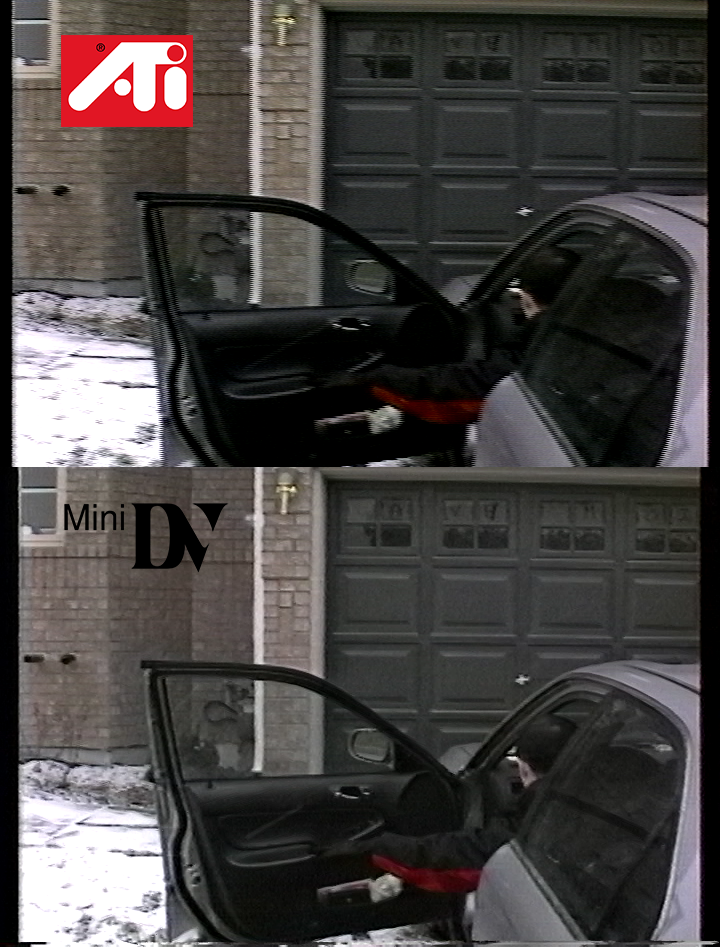

  1. I have always been confused by display aspect ratio, pixel aspect ratio (input and output). I would like to know definitively how to handle this and what settings to use. Specifically...

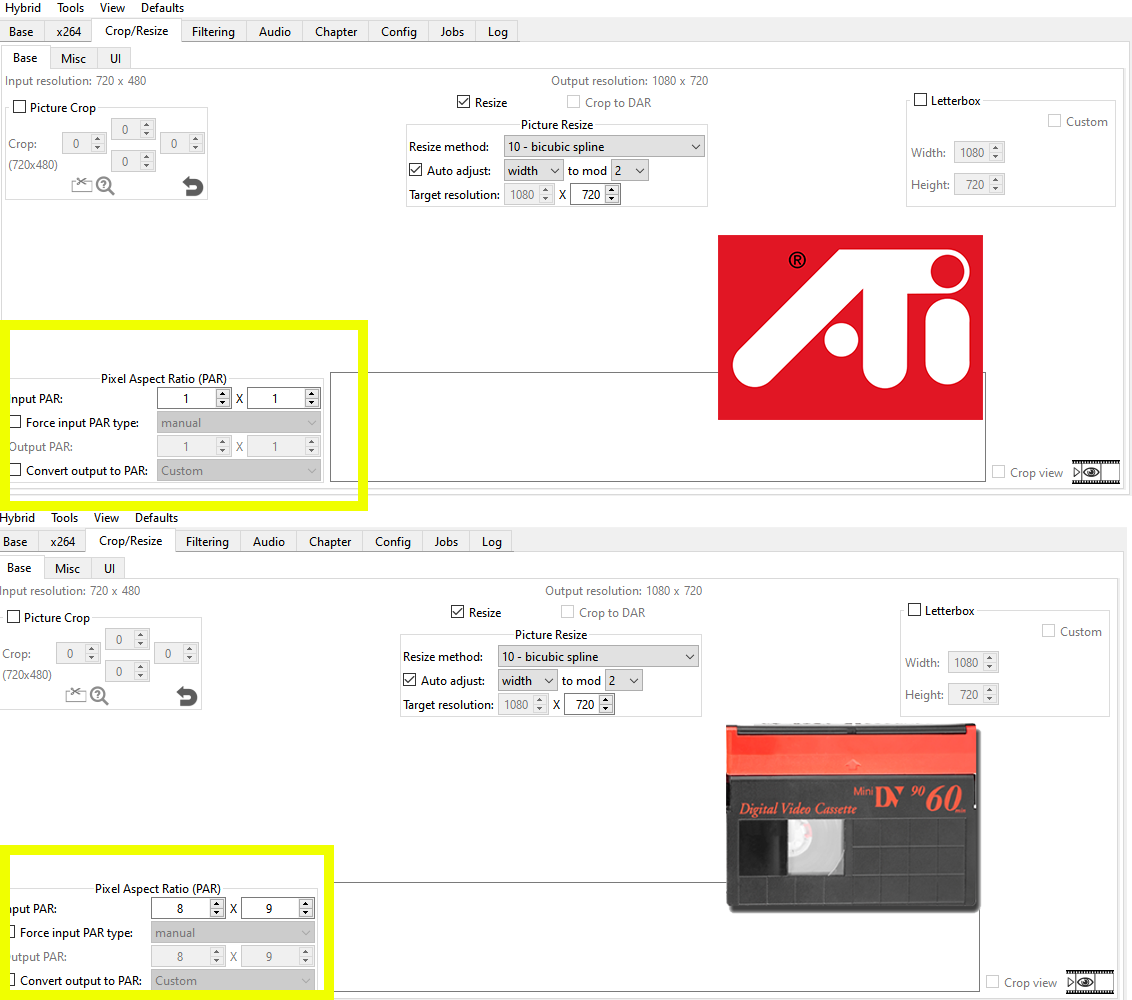

    I capture 8mm tape with an ATI AIW-9600XT. According to MediaInfo, my AVI files (HuffYuv) have a display aspect ratio of 3:2 and a size of 720x480. When I open in Hybrid, in Crop/Resize--Base, the Input Par is set to 1x1.
    By comparison, when I capture a MiniDV video via firewire, according to MediaInfo it has a display aspect ratio of 4:3 with a size of 720x480. When I open in Hybrid, in Crop/Resize--Base, the Input Par is 8x9 by default.
    Bottom line: what should I set as the Input Par and Output Par for the 8mm captures, and the MiniDV transfers? Thank you!!

    For 8mm video captured via ATI capture card, what should I enter in Hybrid for Input Par and Output Par?
    I should also mention that the ATI capture version looks more stretched out. Is that related to the 3:2 versus 4:3 thing?
    [Attachment 78687 - Click to enlarge]

  10. @Darryl In Canada: BTW your ATI screenshot looks interlaced. DON'T resize vertically without prior deinterlacing.

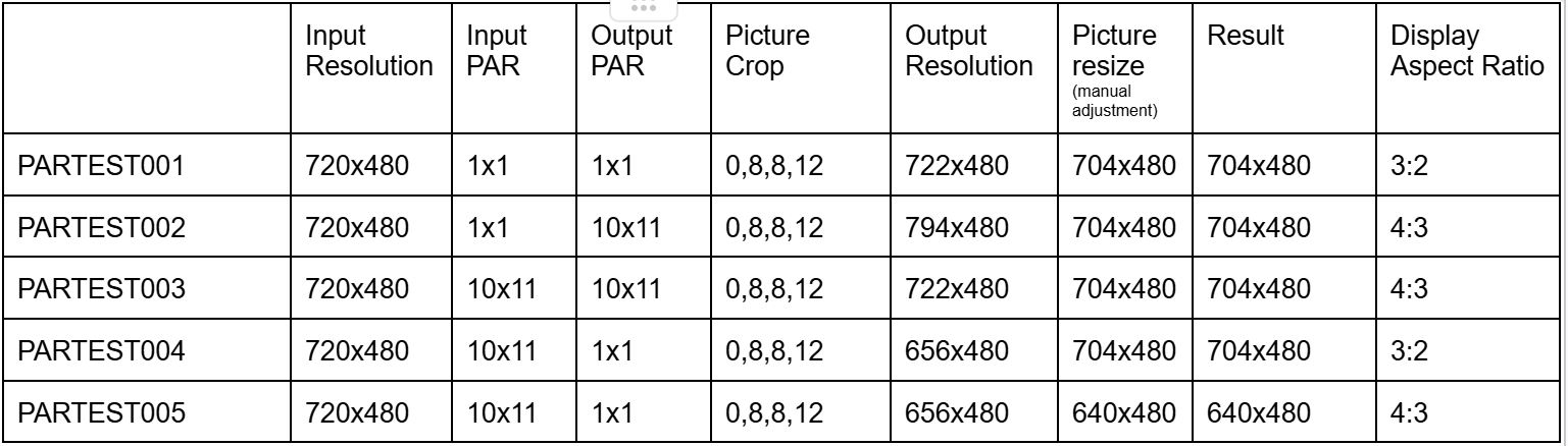

  11. I did five tests with different combinations of input PAR and output PAR. (Click to enlarge table.)
    [Attachment 79583 - Click to enlarge]
    Things I am still confused about:

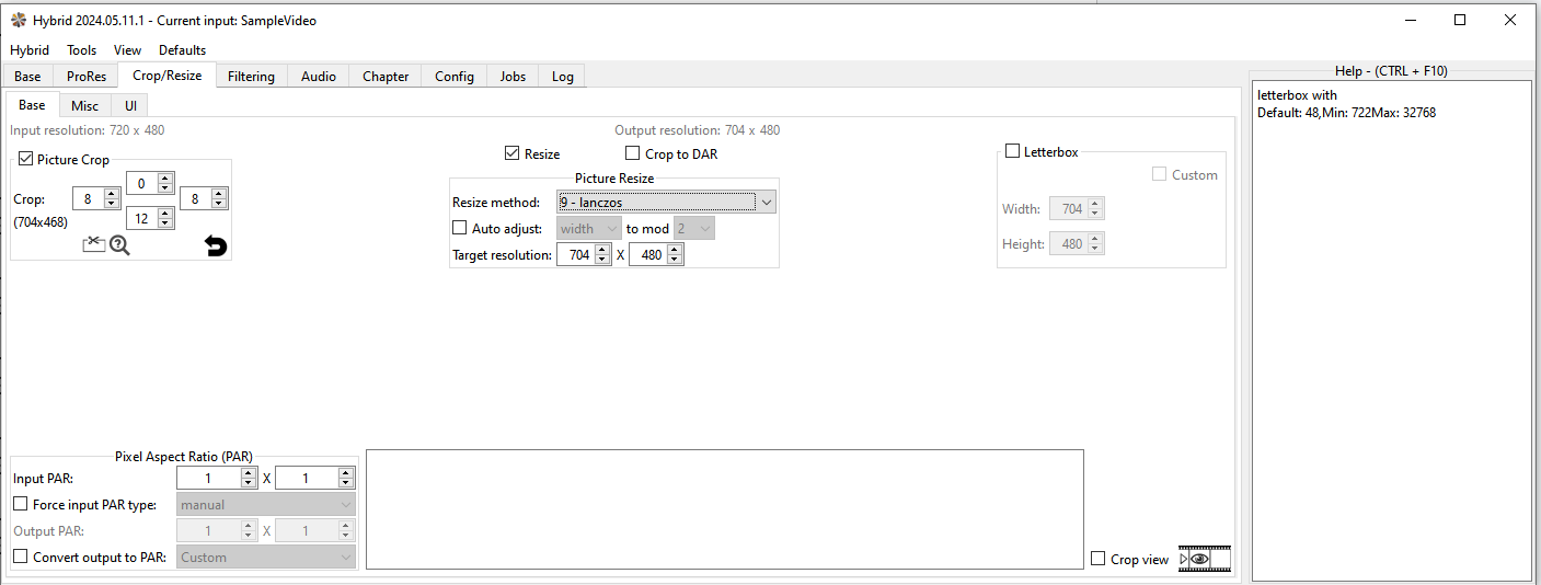

    - Which Input and Output PAR I should be using in Hybrid from my SD capture card.
    - Whether I should force the resize of 704x480, 640x480, or something else.
    [Attachment 79584 - Click to enlarge]

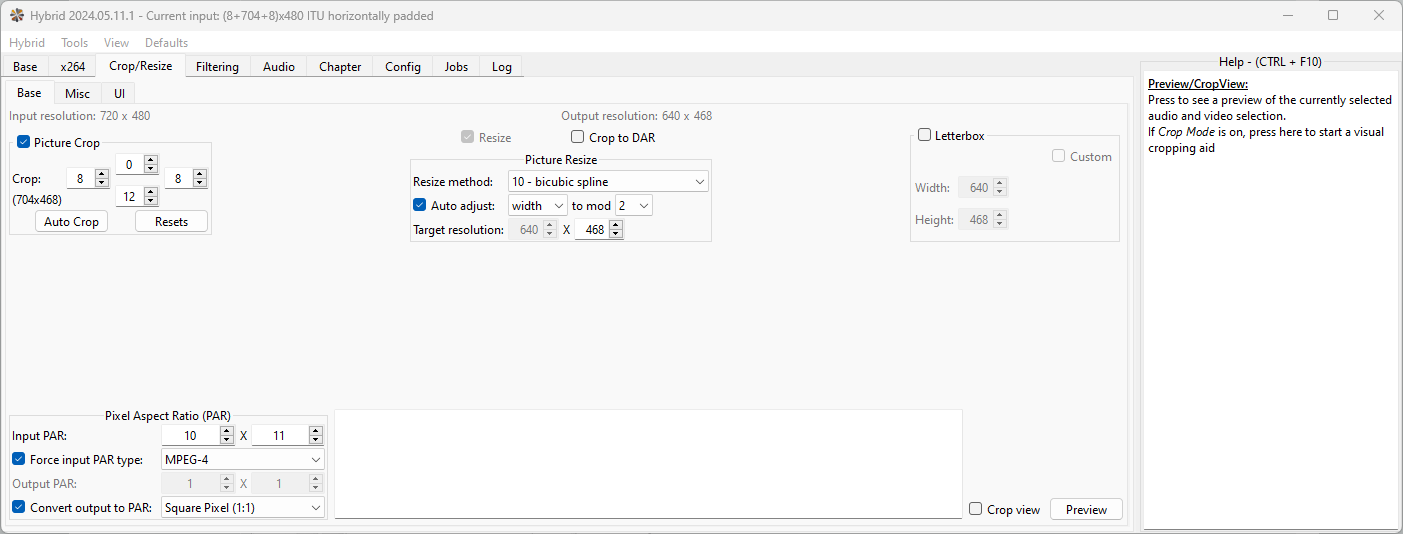

  12. For square pixel output with your cropping and no vertical resizing because your capture is interlaced:
Name:	Screenshot 2024-06-03 083308.png

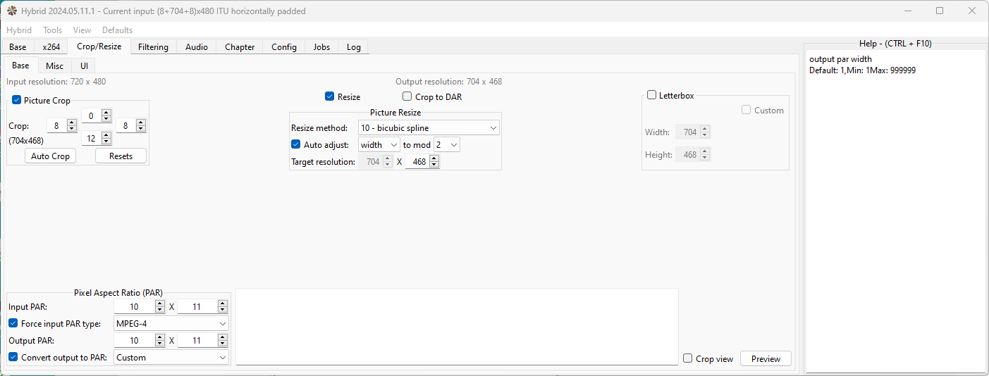

  13. If you want to leave it anamorphic:

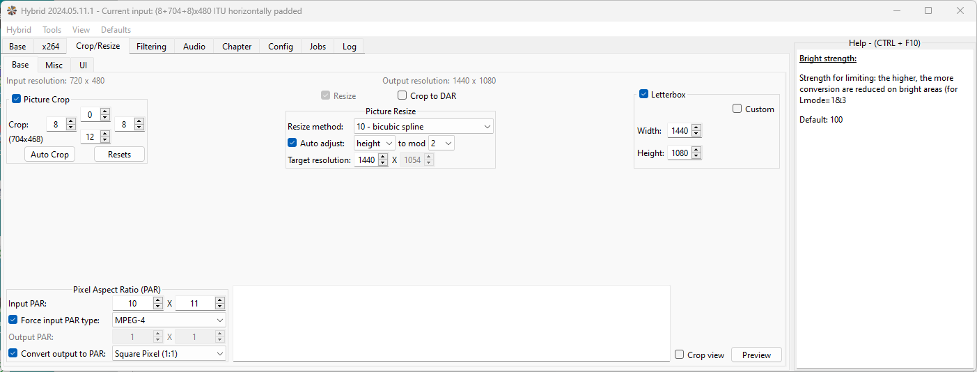

  14. If you deinterlace you can apply resizing, for example to 1440x1080

  16. See my last example in post#14. It produces a 1440x1080 4:3 frame. Small black borders will be added according to your cropping to make it overall 1440x1080, undistorted picture in a 4:3 canvas, compliant with your (1), (2), (3) above.
    (Maybe select Auto adjust 'height to mod 4' to be on the very safe side.)
