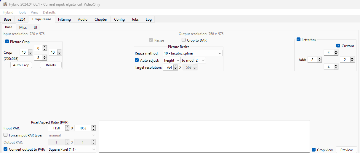

  4. Thanks for your further help.
    So then i believe i am doing sth wrong, because when i use 1150/1053 in hybrid, i get a big difference compared to the one source from #1. I attached 2 pictures. The wider one is from #1, the other is from 1150/1053.
    So can you say me, if that is the "slight difference" or am i doing sth wrong here? Its a screenshot which i made smaller because of filesize limitation.

  5. And without Avisynth ?
  6. if your source is wrongly flagged, you should overwrite the input par
  7. Originally Posted by Gelinox View Post
    Sorry, i dont understand what you mean. I use vapoursynth in hybrid for deinterlacing. So it should be no avisynth i think.
  8. Originally Posted by Selur View Post
    Ahh, but how do i know if it is wrongly flagged and even more important: how do i now which is the correct one?
    Should i better use fix Resolution ? Problem is i would have to calculate because of the cropping i guess.
    Edit: Testes fix resolution without cropping and it does not work either.

    As explained before:
    The input PAR for #1 (the .mkv file) is 12/11 (or 1150/1053 if you prefer), not 1:1 or 16/15
    The input PAR for the elagato capture is 12/11 (or 1150/1053 if you prefer)
    And you have to decide whether you want to keep it anamorphic (non-square pixels) or convert it to square pixels.

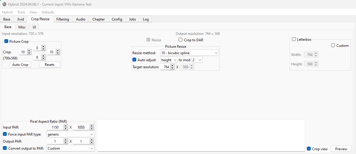

  12. Ok, i actually do not care about the source from #1. I only want, that the video is stretched as correctly as possible without the need of a player who fix it.
    So actually i would be glad if someone could tell me, if these hybrid-settings are the right for it:
    Especially the "auto adjust" on crop/resize->resize ist sth, which drives me crazy. Do i have to uncheck that while changing the PAR or do i have to set it on auto ?
    and if this setting is the right one: Can i now crop the picture without changing sth else without changing the right "stretch" or do i have to change sth then?
    Sorry to all, but i would be very glad, if someone could tell me, what is correct.

  13. Originally Posted by Platos View Post
    OK, so you want to convert it to square pixels.
    For example like this with your cropping and keeping the vertical resolution intact. You see that the output resolution will become 764x568 as I wrote before.
    So again: The PAR of your capture is the Input PAR which is 1150/1053. As you want to convert to square pixels you select the Output PAR as 1/1. Now you can play with with the Auto adjust target resolution. You can now set the width OR the height but not both, because one depends on the other to fullfill the square pixel condition. Hybrid is very smart.

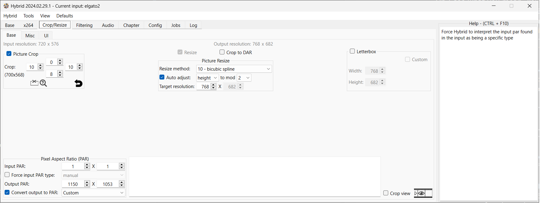

  14. ok thanks. I do it now this way, thanks alot.
  15. As you may readily conclude the 764x568 output is no longer exactly 4:3, but 1.34507. The reason is of course your cropping of the source. But the objects are displayed correctly (=undistorted), means a perfect circle will still be a perfect circle when played back in square pixel view.
    If you wanted an exact 4:3 overall frame you would have to pad the picture (=adding black borders) accordingly, so for your cropped example the overall frame size becomes including the borders 768x576 (=4:3), square pixels.
Name:	Screenshot 2024-05-02 175014.png

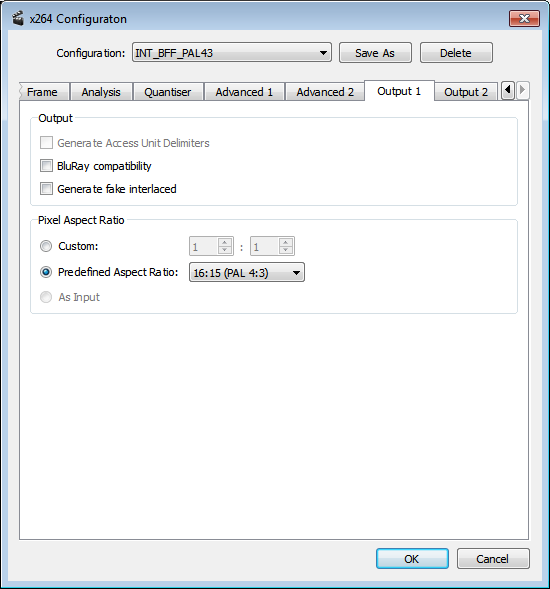

  18. Rec601 specifies a luma sampling rate of 13.5 MHz which for PAL gives a Pixel Aspect Ratio (PAR) of 59/54 aka 1150/1053, approximated by 12/11. Therefore the active picture width of a capture within a 720 wide frame is ~702 pixels, and the 4:3 picture is represented by the inner ~702x576 pixels.
    DVD is a digital standard which does not even specify the PAR but only the DAR (like 4:3, 16:9). Being a digital medium it follows the mpeg2 standard which violates Rec601. The implicit PAR of a 4:3 DVD (including the sidebars of captured analog footage) then becomes 4/3*576/720=1.0666... = 16/15, and this is what tools usually report, although the PAR of the captured inner ~702x576 picture is actually acc. Rec601 (approximated by 12/11 for 4:3 PAL).
    Commercial DVD content may however be PAR 16/15 or 12/11, it's not specified, and one may only find out with the circle test.
    A DVD will always be reported as 16/15 and played back as 4:3, irrespective whether its actual video has a PAR of 12/11 or 16/15. DVD is just sloppy.
