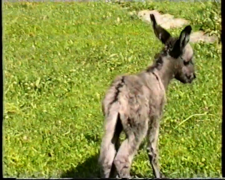

  1. I have here an old camera-shot which was one of these VHS-cameras (video below).
    Has anyone of you an idea, which filters i can use for this?
  2. Originally Posted by Platos View Post
    How did you capture this? What tools did you use? Your setup?
    You should start with a decent capture: lossless YUV 4:2:2, interlaced.

    I see 3 main issues with your new attempts:
    1) Interlacing.
    What you see on your PC are the interlaced scanlines which is exactly as it should be for an analog tape capture. This is normal and not an artifact and it will disappear with deinterlacing, either done by your player/TV at playback time, or by postprocessing the .avi capture using a deinterlacing filter (Avisynth, VirtualDub ....)
    2) Dotcrawl
    You got a lot of dotcrawl (flickering moving dots). This has its origin in the composite video signal coming out of your VCR. It can be avoided by:
    - using a better VCR with S-video output instead of the SCART/composite of your model
    - using a decent capture card with a good internal "comb filter" instead of your current USB dongles
    - using a DVD recorder in passthrough (composite IN -> S-Video OUT, with its comb filter enabled)
    - applying a dotcrawl/rainbow filter in post processing
    3) Line wiggling/flagging.
    - A VCR with TBC, a capture device with TBC functionality, an extarnal TBC or a DVD recorder in passthrough will solve it.
    Lastly, you captured into RGB which is just a waste of bitrate for VHS video. Capture into YUV 4:2:2. Configure your codec accordingly.

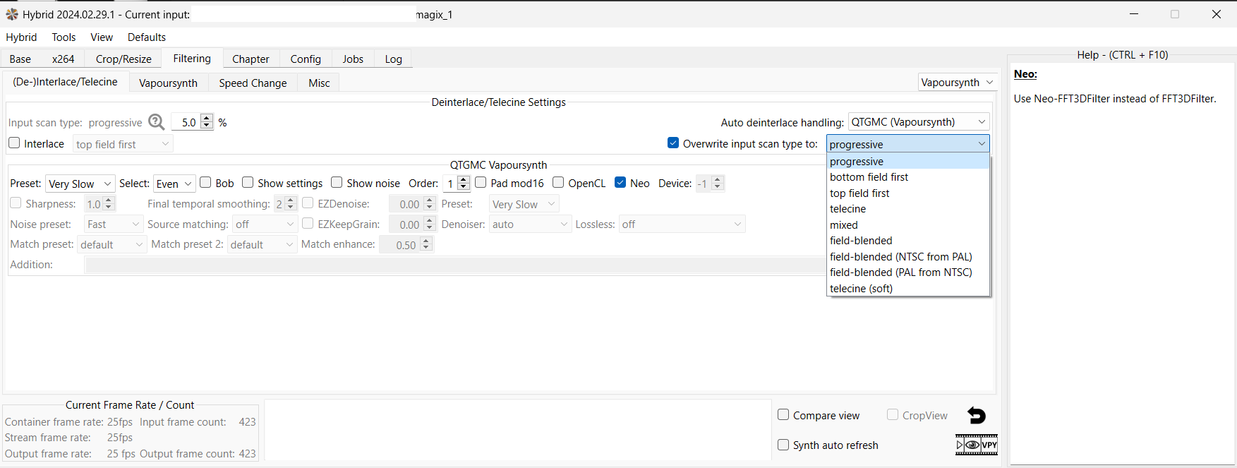

  13. Thanks for all the advice. I will test the deinterlace. Which one would you recommend for this source? QTGMC?
    2) Do you have a sugestion for a specific model i could search for on second-hand platforms ? Maybe when i get a nice price i would think about buying such one (I mean Videoplayer)
    3) What is TBC ?
    And how can a DVD-Recorder be usefull for video-tapes? I can't put video tapes in it to record.
    And about YUV: I could not take that. VirtualDub said not supportet by capturing device. But when i have to deinterlace anyway (so reencode), then i can just take sth else when reencoding. So doesnt matter then.
    Edit: And what do you think is a better source for editing? The magix one or the elgato one ? So in case i would not buy another capture device.
    Edit 2: I think Hybrid does detect it (wrongly) as progressive. But i have no clue what all these terms say (like telecine, field-blended and so on): What should i take here:
    .avi doesn't have an interlaced flag, so Hybrid (or any other tool) can't know. You have to set it manually. Your captures are interlaced, TFF (=top field first).

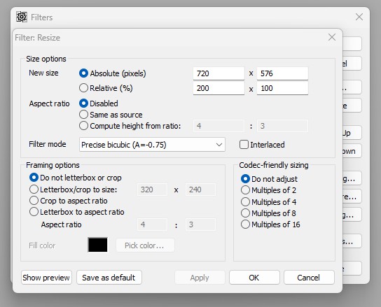

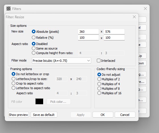

    Do the resize as Sharc -described as follows:
    Add the Resize filter, set up the first resize (to 360) exactly as per this:
    [Attachment 78732 - Click to enlarge]
    Hit OK
    Now, add another instance of the Resize filter to go back to 720x576:
    [Attachment 78733 - Click to enlarge]

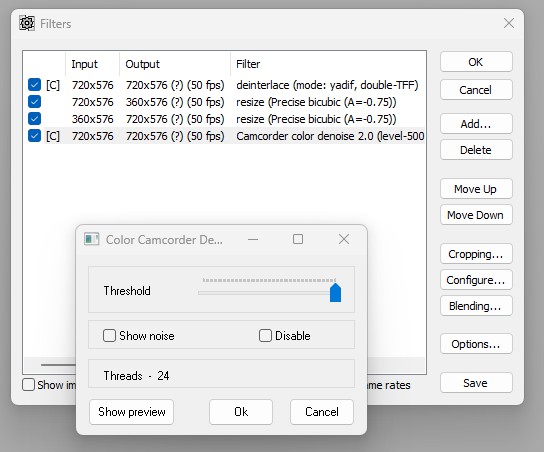

    Finally, add the CCD filter and set it up like this:
    [Attachment 78734 - Click to enlarge]
    Hit OK twice.

    BUT: can someone explain me why the new capture all are 5:4 instead of 3:4? Resolution is the same (720x576) but aspect ratio isn't ?? How is that possible? Can i somehow change that in virtual dub ?
    You have to study "Anamorph" picture storage, means the context between Frame Dimensions (720x576 in this case), Display Aspect Ratio (DAR, like 4:3) and Sampling Aspect Ratio (SAR) aka Pixel Aspect Ratio (PAR). It can be quite confusing, I know. Especially because the same 3-letter synonyms for various "Aspect Ratios" like PAR, DAR, SAR, FAR, MAR are used ambiguously.
    Simplified explanation for your case: Your captured frame is stored as a frame of 720 width and 576 hight. 720/576=1.25=5:4. That's where the 5:4 comes from. However, this picture is anamorphic distorted, means it is horizontally slightly squashed. For viewing it correctly as 4:3 it has to be horizontally stretched. This stretching is done by the player (TV) reading the picture's SAR aka PAR (which is in very good approximation 12/11 for standard PAL VHS captures like yours), or just forced by the player to play it as DAR=4:3 rather than 5:4. Alternatively, you can stretch it yourself by resizing it by means of a script or a tool (GUI) to represent a 4:3 picture. Confused? No wonder. You have some buzzwords. Tons of posts in this forum on this subject. Google for it and have fun . Maybe start reading here:
    https://en.wikipedia.org/wiki/Pixel_aspect_ratio
    When you right click into the picture in Vdub you get a list of some standard Pixel Aspect Ratios (PAR, aka SAR). Play with these selections and see and try to understand what happens.

    The strange thing is: The old source (From #1 in this post) is also 720x756 pixel, but it has the right 4:3 aspect ratio. So in this source the pixel aspect ratio is then 1:1 (when i understood correctly before). So i feel like this was made somehow directly on the capture.
    So is it maybe possible to make that in virtualdub while capturing? Or why is the other source from #1 same resolution but 4:3 aspect ratio than my capture? I feel like i missed some important settings on capturing.
    Edit: I saw this right now: When i left or right click in the picture in virtual dub nothing happens. I can see the video playing but i can not click into the picture nor beside it.
    Edit2: Ah, you meant in the normal mode, not in capture mode.
    The tool which you used to produce the .mkv flagged the DAR explicitiely as 4:3 in the .mkv container, so the player which reads this DAR flag got instructed to play it as 4:3.
    When you play it in Vdub (not forcing the 4:3 playback) the frame is still played as 720 wide and 576 high which is 5:4.
    Now right click into the picture and select "4:3 frame (TV)" and you get the 4:3 view as 768x576 (including the small black side borders).
  30. Ok, Update: I found out i can change output PAR in Hybrid and then it is the same resolution, 4:3 aspect ratio (So DAR) and i can change the "stretch" of the Video.
    For testing i took 1150x1053 (as described in Selurs link for analog sources), but it is not the same as in source from post #1. But actually im not sure which one of them is the right one. Actually quite difficult to tell.
    Is 1150/1053 common for the VHS-8 PAL tapes ?
    Edit: I tried also 12/11 and this is less stretched than the source from #1. Difficult to decide
    Edit2: Yeah ok, the one source from #1 is 16/15. But i just dont know which stretch is the original one.
