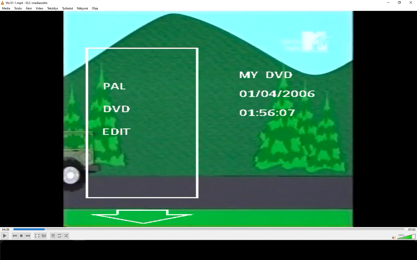

I have a question: I recorded many TV shows on DVD. That DVD player broke so I recover those videos as .VOB files then I encode them to .mp4 with Handbrake. Sometimes I get menu box on top of video. Why that happens? It reads texts like PAL, DVD, EDIT and Date / Time.
I can try to provide screenshot about problem if it helps to solve it.

So. That box is my problem. It happens sometimes when I encode .VOB to .mp4
How to remove that from happening? I know .VOB files are segmented to chapters. Does that box happen because of it? -
Looks like you used also vob file containing a basic menu. Skip file VTS_0[number]_0.VOB. Edit: it also can be VIDEO_TS.VOB. I don't remember what create standalone recorders as I no longer use such mpeg files.

As mentioned before, you seem to have added the VIDEO_TS.VOB file and this is the menu file.
You can open it very briefly with VLC or for as long as you wish with PotPlayer. -
I only get those VTS files when I recover them with Isobuster from DVD disc. That is why they have that VTS name. Only some videos give that White box not all videos and that is strange. I bet it happens because some programs have commercials and I try to cut them off. That is why video gets multiple segments / chapters there.
