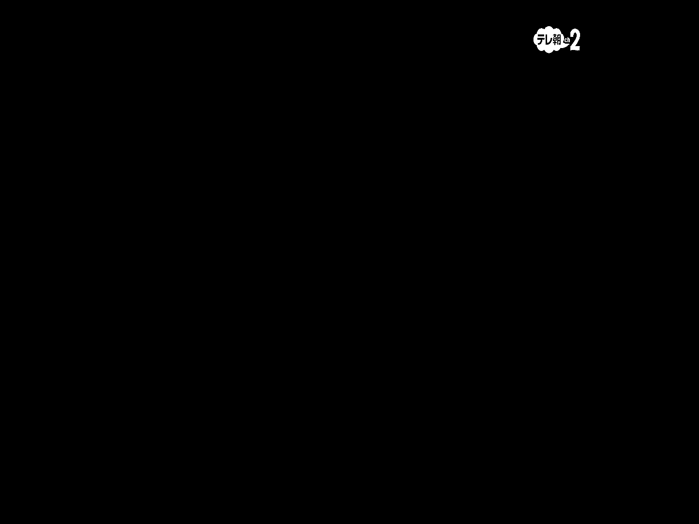

    I attempted the InpaintDelogo process first. I had a picture of the logo on black (0:30 at sample) so I hand traced it and replaced the other pixels with pure black. After a while I wrote this script:

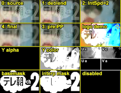

    The script ran sucessfully, however, either due to me not running IVTC or another issue the TV logo is not completely gone.
    [Attachment 78574 - Click to enlarge]

    I have IVTC'ed the video as suggested. However, I am struggling to keep the remnants of the logo out of the video. There are slight artefacts in the logo with my settings. Attached is a sample of the video and my script; please help me remove the logo further.

    Don't include frames with animated logo like fade ins or fade outs, redo all masks without those frames.
    Btw, frames without logo should be excluded too.
    Then share all the masks.
  6. Hello VoodooFX
    I have redone the mask from the frames with the logo.
    Below is it attached.
    [Attachment 78637 - Click to enlarge]

    Those are not important, where are ebmp masks for deblend?
    Btw you are run it there only on 1 min sample, that's not how deblending works, you need to run on all frames with logo.
