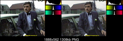

    Hi, I have JVC HR-J668 and JVC HR-S7500 (PAL). I've been capturing my tapes using them paired with Panasonic DMR-ES10 or EH-65. I used hauppauge live 2 with ES-10 and Blackmagic Intensity Pro with EH-65 (HDMI route, seems more pleasent as it's luma range isn't limited and double A/D conversion is avoided). I usually like picture the most from J668 (the best physcial state) but as it's not an S-VHS VCR i get a little of dot crawl in my captures. It wasn't bothering me at all but when i put the S7500 between J688 and EH-65 it seems to me it has better comb filter than one in the Panasonic. What do you guys think? Can you see the difference? Is it worth to add S7500 to the capturing chain? Both VCRs were set to EDIT mode with BEST on.
    Single frame comparsion (i tried to match histogram values here): https://imgsli.com/MjU4MzYz/0/1

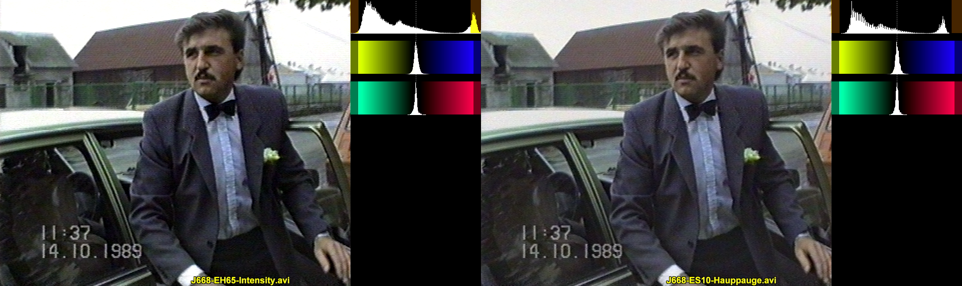

    The standard route (ES-10 -> USB Live2) is better than HDMI route (EH65 -> Intensity Pro) in this use case. In the second the details in the whites areas are lost.
    frame 580 comparison: https://imgsli.com/MjU4Mzkz
    However, although the whites are in the >235 area, there is no clippling in the Infinity histogram:

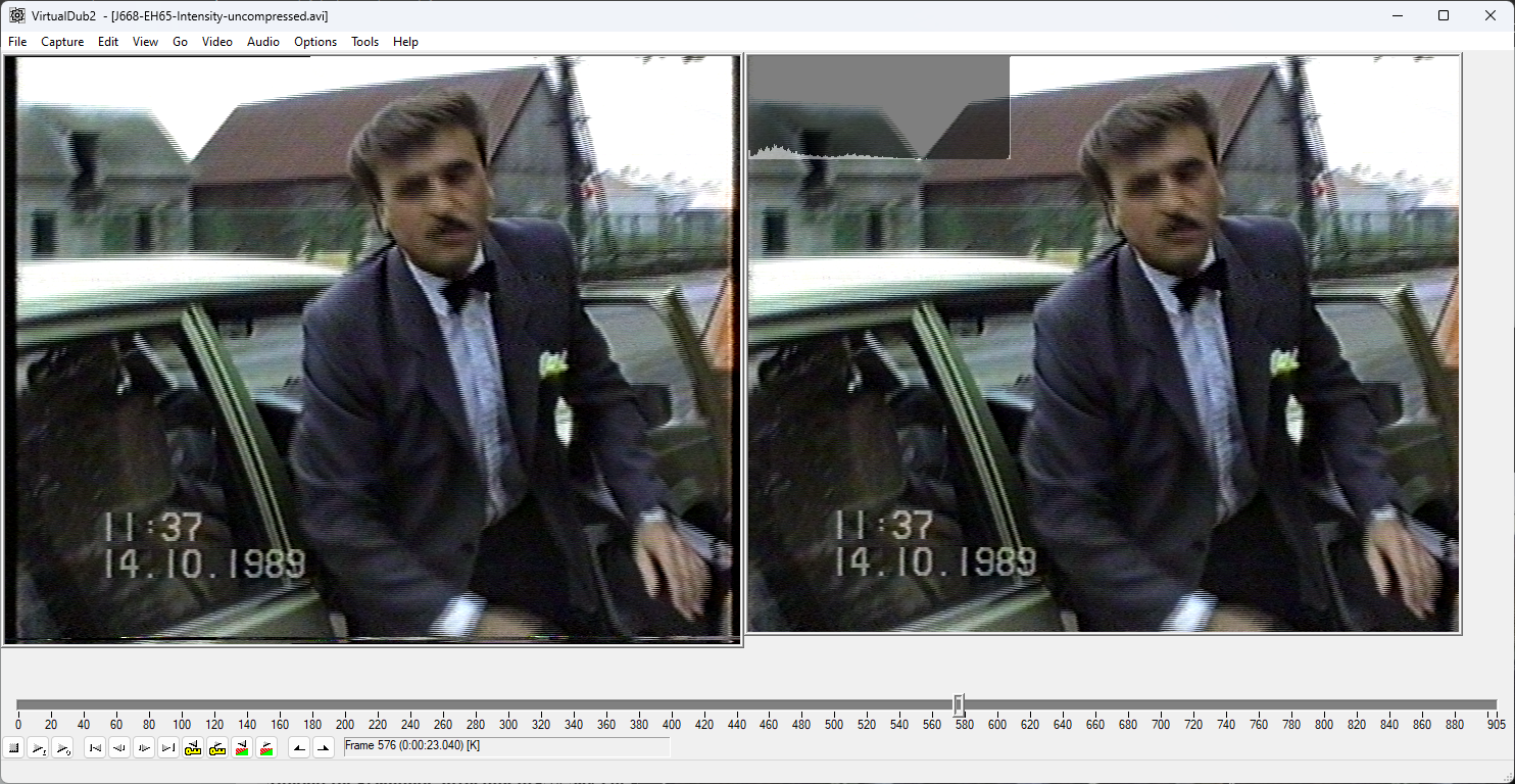

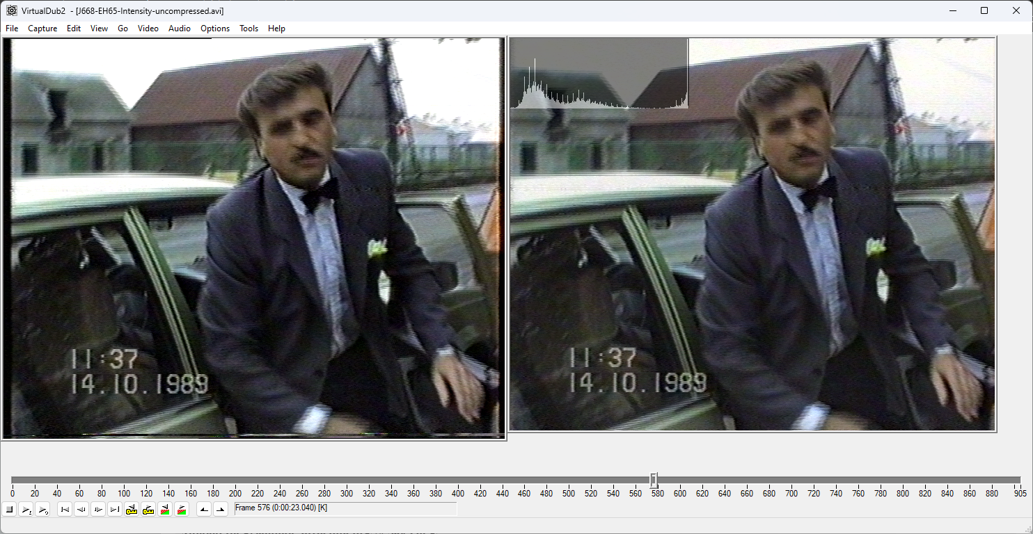

Name:	vdub without adjustments.png
Name:	vdub adjustment.png

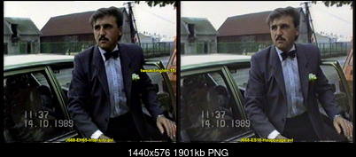

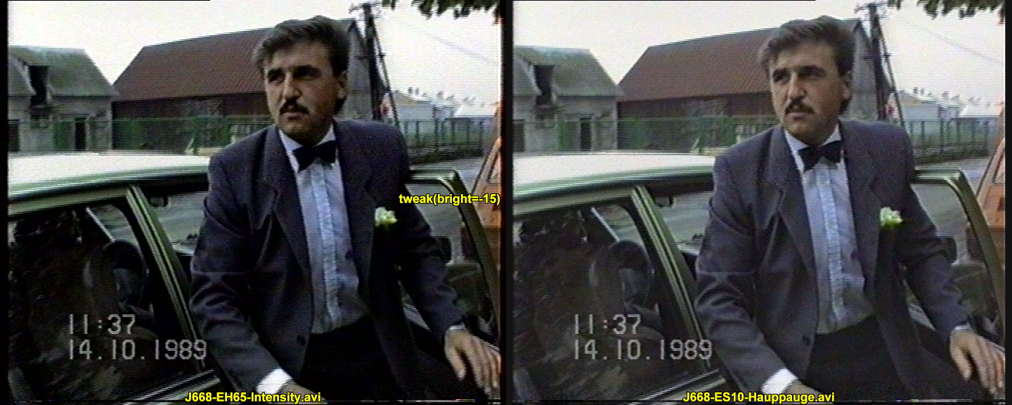

    Correct, but partially. And by doing so you are affecting the whole picture, which becomes too dark (uness you use a specific mask based on luma and/or area). Overall, the HDMI picture is less convincing. And it features one missing/drop frame if I am not wrong.
