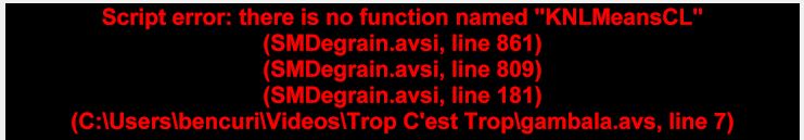

    But when I do so to test the script, I get some errors:
    1. "LWLibavVideoSource does not have a named argument "prefer_hw"
    2. "There is no function named KNLMEANSCL" -SMDegrain.avsi- -> this one is installed in the plugin folders though, so it strange to report an error
  10. Originally Posted by Bencuri View Post
    Must be a version difference. Just remove that argument. Or use Mpeg2Source() rather than LWlibavVideoSource().
    Make sure you have the MSVC 2019 redistributable package:

    Installed the latest one but no difference.
    I noticed that there is a new version of SMDegrain available, too, however after I installed it, AVSPMod didn't even start. It reported an Avisynth error.
    I have Windows 7 anyway maybe that causes the issues?

    [Attachment 78624 - Click to enlarge]
    From the Microsoft addon, I installed this one (direct link): https://aka.ms/vs/17/release/vc_redist.x64.exe
    I have Windows 7 64 bit SP1. I wonder if it is compatibile at all with the SMDegrain version you use. As I said when I install the newest version of SMDegrain that you have, AVSPMod does't even open the script but reports Avisynth error, this one:
    [Attachment 78625 - Click to enlarge]

    Removed the old Avisynth, installet Avisynth x64 to ProgramFiles(x86) -> that was the default folder the installer selected. Downloaded AVSPMod x64. This is the error message now:
    [Attachment 78631 - Click to enlarge]
    Line 1 is:
    LWLibavVideoSource("Gambala cut2.mpg", cache=false)
    I have replaced LSMASHSource.dll with the x64 version. But I get the same error message.
  27. The 64 bit LSMASHSource.dll should be in AviSynth+'s plugins64+ folder. It will autoload from there. Ie, you won't need to include LoadPlugin(...LSMASHShource.dll) in your scripts).
    It was avstp.dll. Not even mentioned in line 1, but after completely rebuilding my plugin folder with 100% 64 bit plugins, now your script works, having Avisynth+ installed. I can see the preview now.
