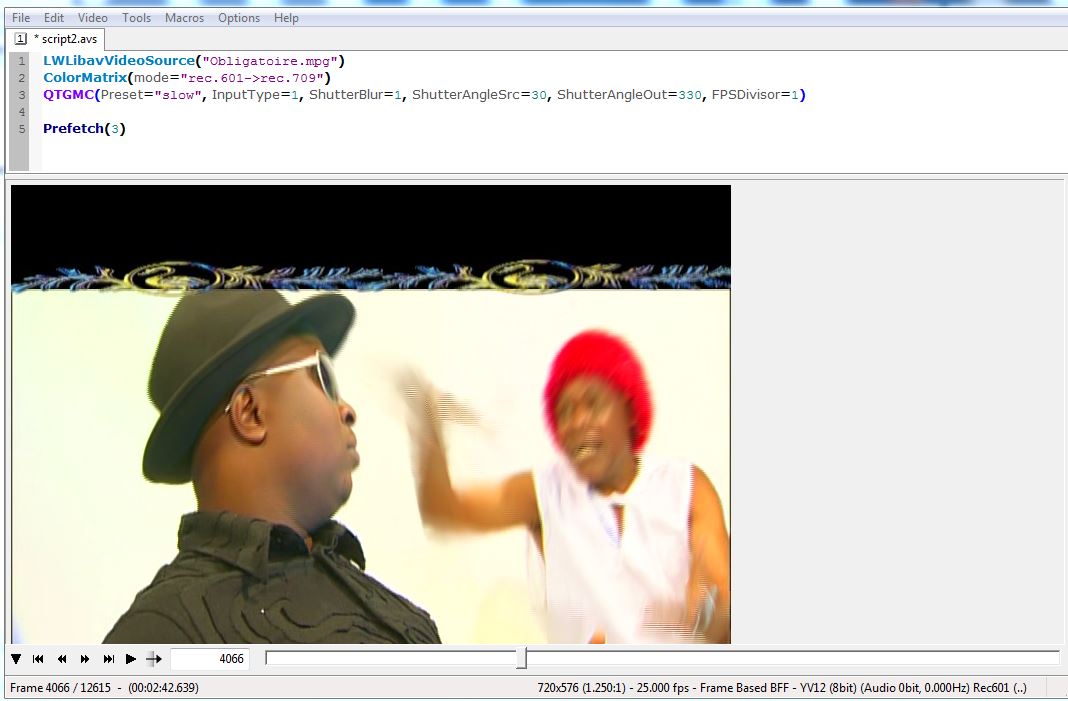

    I have insterted the blurring script to AVSPmod, but strangely it is causing combing. Why is that? If I remove the blurring part, only leave QTGMC(), the combs disappear.
    [Attachment 80330 - Click to enlarge]
    EDIT: Okay I have found if I remove everything from that line only leave the 3 shutter parameters, the combing stops.

  14. Originally Posted by Bencuri View Post
    I was starting with your progressive sample so it didn't need deinterlacing. You are starting with an interlaced video so it needs deinterlacing.
