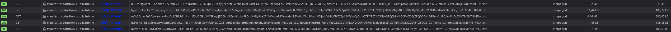

    My problem is that i'm only getting 480p quality instead of 720p because the original manifest that's being loaded is getting an NS_BINDING_ABORTED error:

    I'm only having this issue in the Nightly browser started using playwright.
    I'm able to get 720p quality using these methods:
    - Normal Firefox
    - Normal Nightly
    - Nightly Private
    - New PRIVATE Window opened from playwright nightly
    I know that NS_BINDING_ABORTED means that the connection was terminated by the server before anything could be transferred.
    Why is the server killing my connection/how is it identifying me?
    Any help would be appreciated!

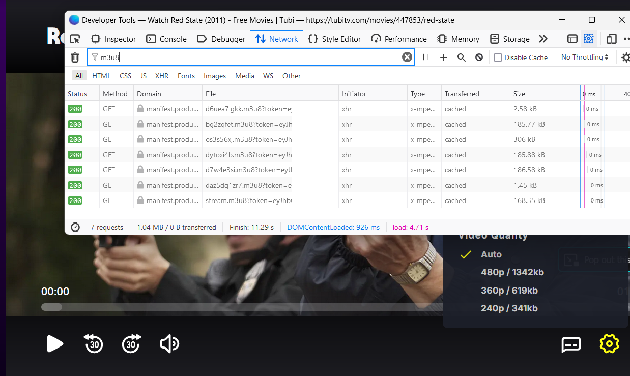

    I ran your code and I can't play 720p. However the m3u8 is requested without errors for me:
    [Attachment 78516 - Click to enlarge]

    Same thing with m3u8 (200 status code, but can't see 720p). As for the license call, it fails. Unauthorized. Error code: 403
