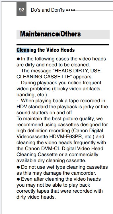

 Another thing you could try is cleaning the heads on your HV20 with a head-cleaning tape, as per page 92 of the manual:
 [Attachment 78499 - Click to enlarge]
 Follow the instructions on the cleaning tape box.Last edited by Alwyn; 19th Apr 2024 at 23:42.
