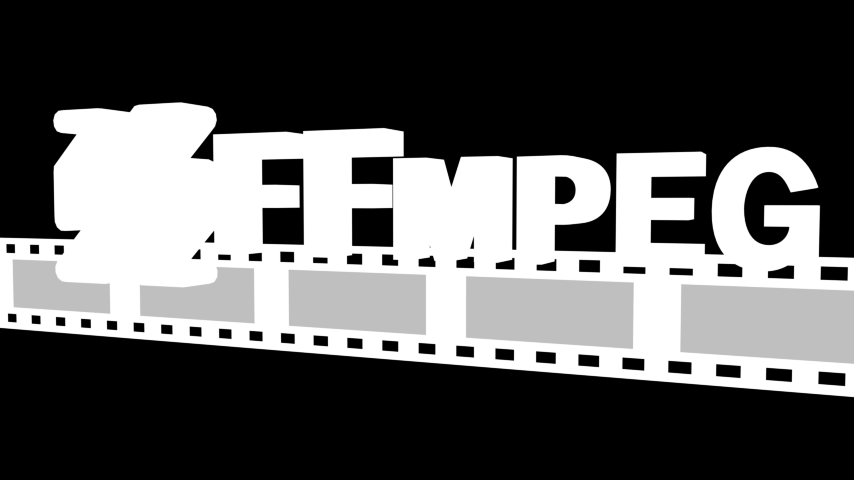

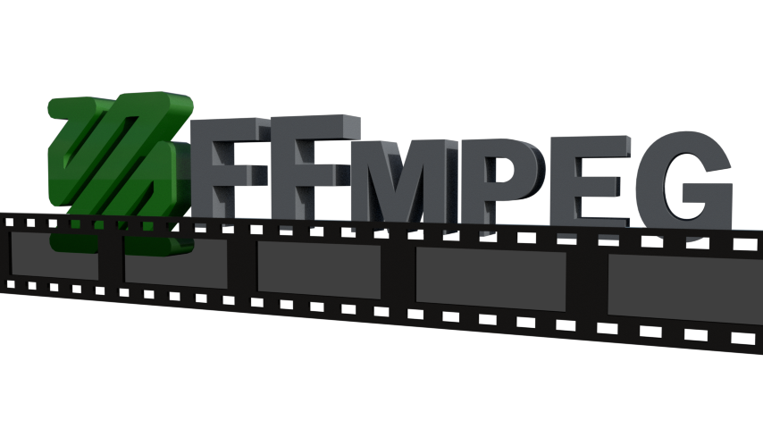

  7. Here is one way of doing it , using alphaextract,lutyuv, alphamerge
    It will look something like this, you have to adjust it for your case
    ffmpeg -i input -f lavfi -i color=color=0xFF000000:size=(width)x(height):r=(framerate) -filter_complex "[0:v]alphaextract,lutyuv=y='if(gt(val,0),255,val)'[m]; [1:v][m]alphamerge[coloralpha]" -map [coloralpha] output
    input
    Alphaextact, you can see the partial transparency of the filmstrip (just 1 frame for demo)

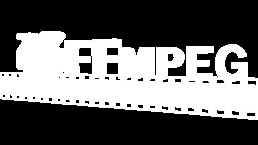

    every pixel that is not completely transparent is converted to a solid color that I set. Otherwise, it should be left transparent.
    alphaextract+Lutyuv - Because it's a binarized hard mask (all values >0 become 1) , the edges will be aliased and sharp - you can blur the alpha or increase the threshold value (just 1 frame for demo)
    Alphamerge merges the modifed alpha with the color layer input (red in this example)
