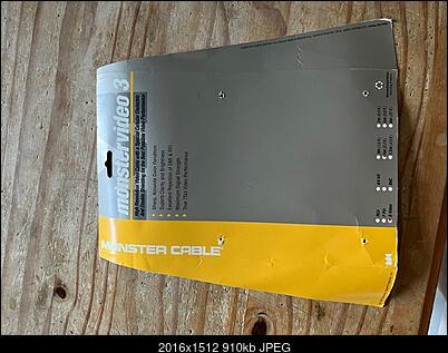

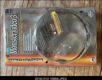

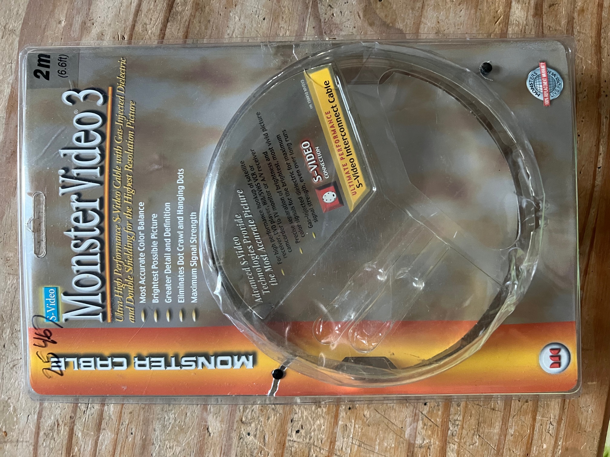

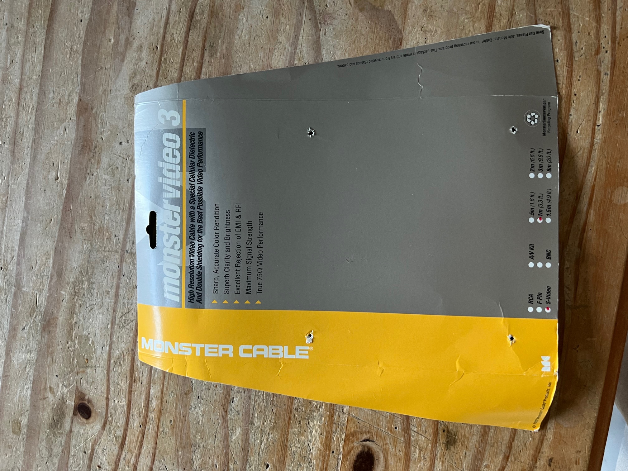

    Just as reference, when capturing I see and measure absolutely no difference between 1m and 2m lenght S-Video cable Monster Cable, series MonsterVideo3.
