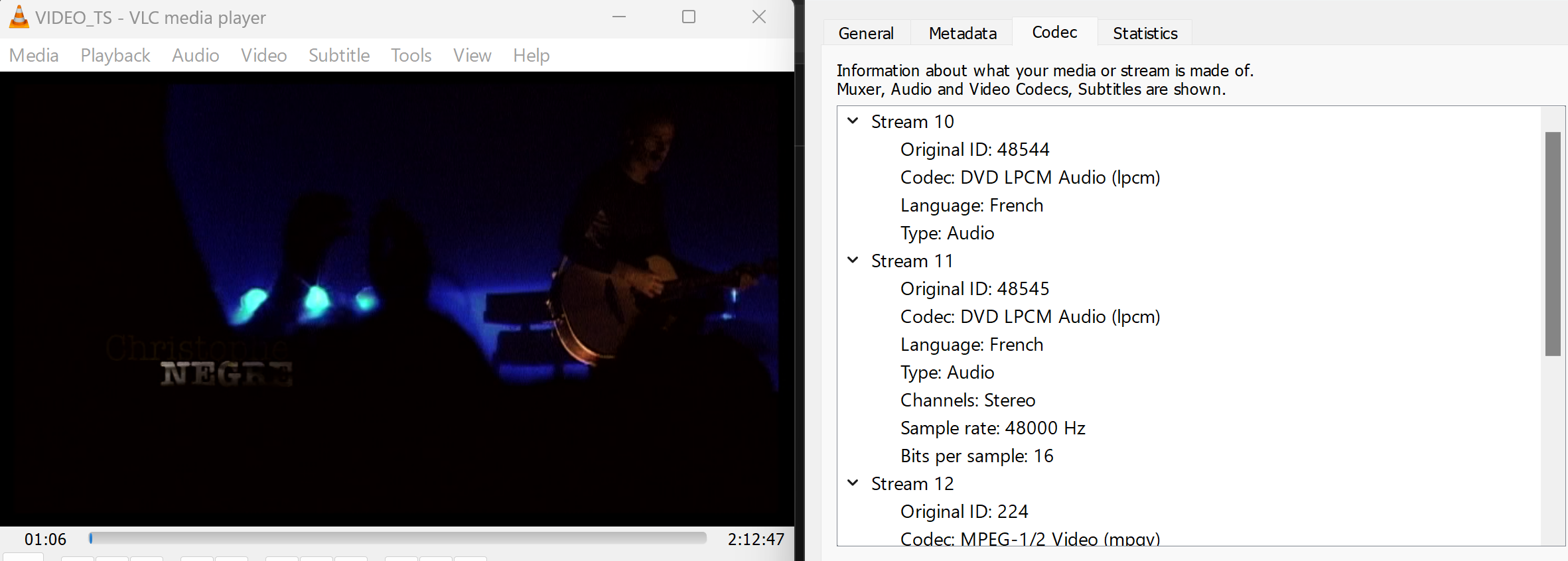

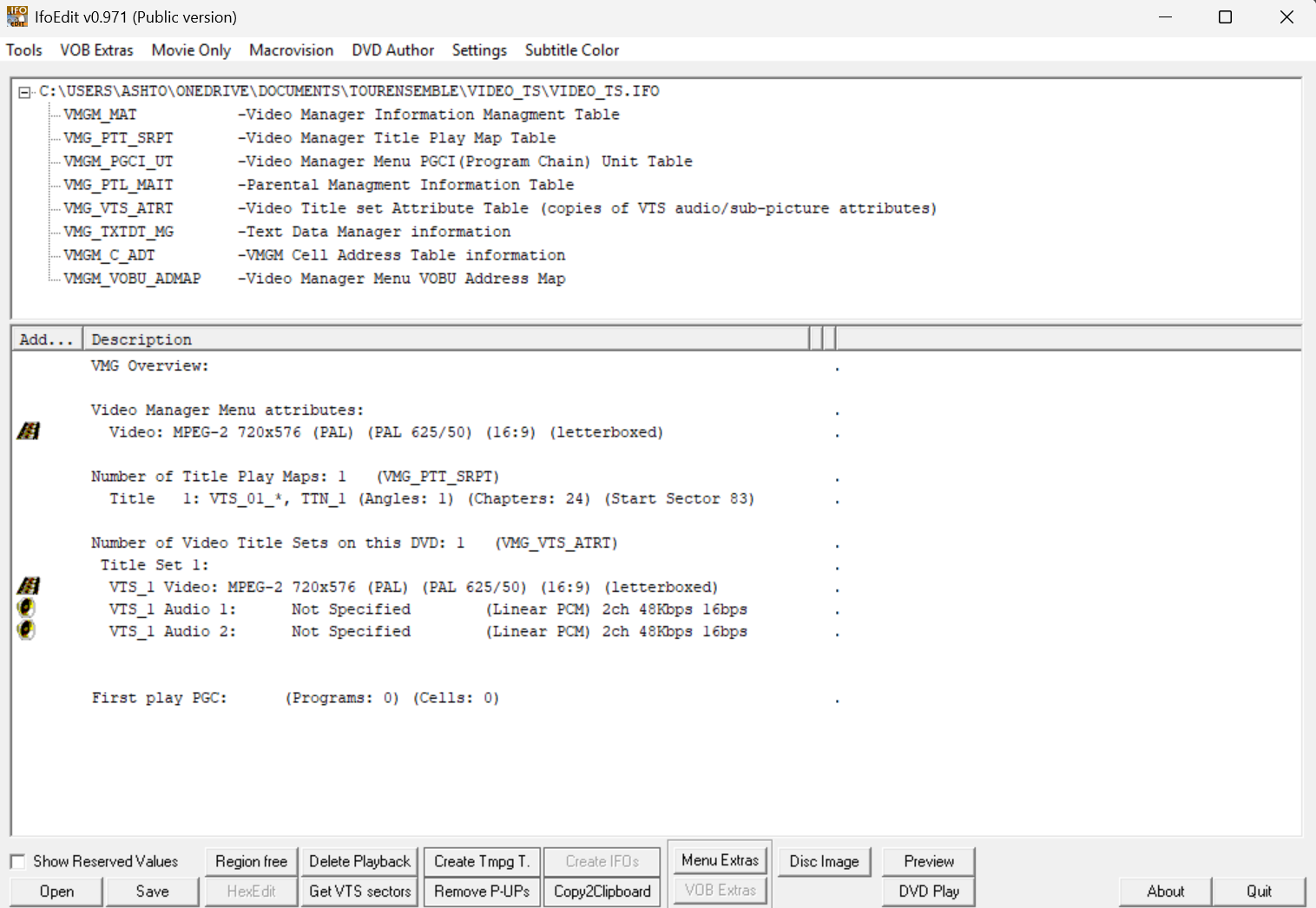

  1. I've been trying to get this to convert to sn MKV, but the disc labels both tracks as Stereo like so:
    https://postimg.cc/gallery/QjNbFGn
    Track 2 is definitely DTS 5.1, but I can't find software (even IfoEdit) so they appear normal. I want to rip the video with the DTS track, not the PCM 2. The weird things my receiver seems to think it's MC, but everything is just white noise is played as if I don't have a DTS de/encoder.
    Its this a manufacturing error or is this salvageable? Thank you everyione.

  2. Use mediainfo to know the real audio codecs.
    I think Handbrake is right and both audiostreams are lpcm.
    edit:
    tested video from pic #3, no DTS, one audio stream only:
    Stream 0:1, Audio, aac, 2 Channels, 96 kb/s

    I would agree, but the video plays normal LPCM 2.0 in audio track 1, but the normal FUZZZZZZZZZ sound of DTS without installing a decoder. Also I uploaded the wrong photo from IFOEdit. That picture is from AFTER I edited the IFO to make track 2 DTS. This is the original. Thank you!!
    Also, I've included the cover which clearly displays DTS. When I originally bought it back in 2003, there was no issue with the DTS track. I've bought it again twice in the last 5 years, but both had this same issue. So I figured there's something wrong with the disc. But if you hit the info button while it's playing the FUZZZZ DTS track, the receiver clearly says DTS 5.1 as the input.

  4. Ifoedit clearly states LPCM for audiostream 2, not DTS.
    Maybe these are bad copies of the original.
