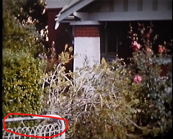

    I have a short piece of cine which I am trying to improve. I'm using this AVISynth script and it's coming out OK; hardly any dupes and blends, but I'm wondering if there would be a better script to smooth it out a bit. I have also tried SRestore + RIFE but didn't have much success.
    Thanks for any input.

    Definitely better than my TFM attempt, which has a lot of slightly blended/blurred frames (I still don't understand the Cycle numbers; I know that it's "in XX, take out YY", but how you work out the actual values is still a mystery).
    I see though that in your 18fps file, there's 9 dupes, at: 26, 55,66,81,108,121,130,135 and 142. Over 158 frames total, is that normal?
  4. Reduce frate in SRestore a bit. Try this:

    Excellent @Sharc, thank you, nice and smooth. Neat Video did a good job on all the crud, so I'm happy with the result.

    Your processing butchered the video again, introducing new temporal an spatial inconsistencies (jerky timeline and vertical jumping).
    RIFE is causing the jumping. Watch the bottom black bar.
    Apart from the jumping, I don't think yours is much better than mine. What's your code?

    ok, but did you notice the jumps in the left-bottom corner? I don't know in which phase of the processing (IVTC, Neat, interpolation) these artifacts sneaked in.
    Also remember that this steady-motion panning scene is not very demanding for motion interpolation. I would check and compare the tools for more demanding scenes as well.
Name:	Screenshot 2024-04-19 132036.png
