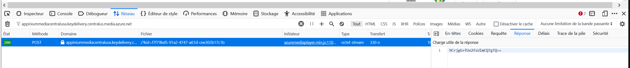

    So I looked for requests to the "key delivery" URL and their responses.
    This is what I found (sorry french UI) :
    [Attachment 78373 - Click to enlarge]
    Converted to HEX :
    Base64: 9CrjgG+fUx2fsUlmCQ7gTQ==
    HEX: f42ae3806f9f531d9fb14966090ee04d
    I then tried different id:key combinations with mp4decrypt, to no avail. (again, either "wrong id (or key)" error, or no error but 0 byte output file)

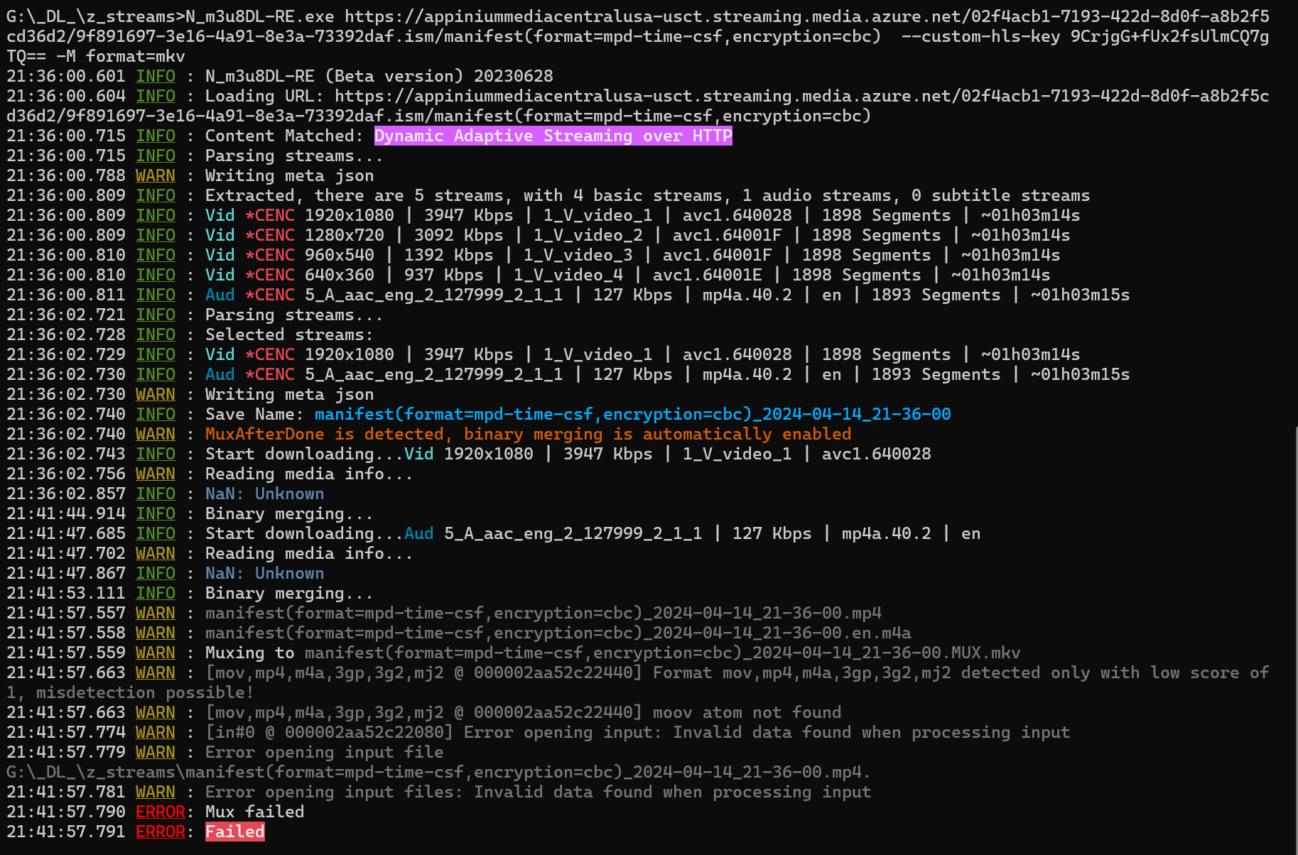

    [Attachment 78378 - Click to enlarge]
    [Attachment 78377 - Click to enlarge]

    Well, this doesn't work on my side, and actually I already tried it before. (not sure what you mean by "key must set" though)
    [Attachment 78380 - Click to enlarge]
    I'll try the method that doesn't merge the fragments asap and let you know.
    Thanks to you all in the meantime.

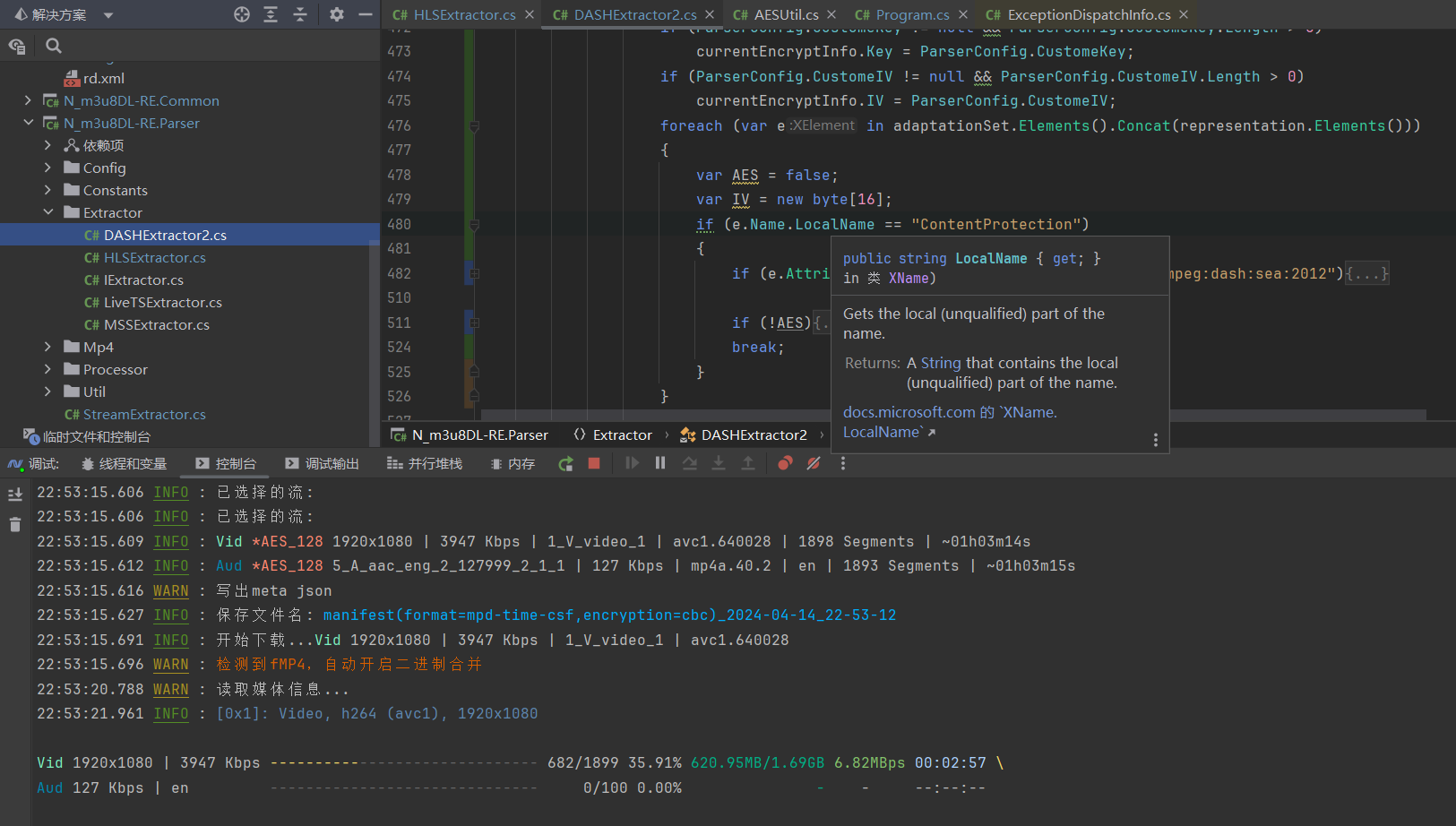

  11. Originally Posted by StanP View Post
    Use only this version of the program
    https://github.com/Tontonnow/N_m3u8DL-RE/actions/runs/8680287173
    you did it
    INFO : Extracted, there are 5 streams, with 4 basic streams, 1 audio streams, 0 subtitle streams
    INFO : Vid *CENC 1920x1080 | 3947 Kbps | 1_V_video_1 | avc1.640028 | 1898 Segments | ~01h03m14s
    INFO : Vid *CENC 1280x720 | 3092 Kbps | 1_V_video_2 | avc1.64001F | 1898 Segments | ~01h03m14s
    INFO : Vid *CENC 960x540 | 1392 Kbps | 1_V_video_3 | avc1.64001F | 1898 Segments | ~01h03m14s
    INFO : Vid *CENC 640x360 | 937 Kbps | 1_V_video_4 | avc1.64001E | 1898 Segments | ~01h03m14s
    but the program should recognize AES-128 instead of CENC
    INFO : Vid *AES_128 1920x1080 | 3947 Kbps | 1_V_video_1 | avc1.640028 | 1898 Segments | ~01h03m14s
    INFO : Vid *AES_128 1280x720 | 3092 Kbps | 1_V_video_2 | avc1.64001F | 1898 Segments | ~01h03m14s
    INFO : Vid *AES_128 960x540 | 1392 Kbps | 1_V_video_3 | avc1.64001F | 1898 Segments | ~01h03m14s
    INFO : Vid *AES_128 640x360 | 937 Kbps | 1_V_video_4 | avc1.64001E | 1898 Segments | ~01h03m14s

  13. Originally Posted by mister_ nex View Post
    never mind, I got the right exe, I wasn't logged in to github and the "artifacts" section at the bottom wasn't showing links...
    I didn't know this behaviour !
    Now with the right exe, AES-128 is correctly detected and the decryption / muxing works !
    Thanks again to you all for your help, I was very close since the beginning, but was going in circles because not using the right versions of the tools...
