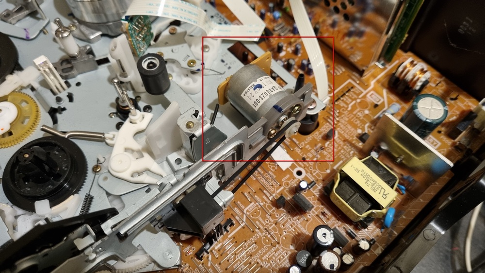

Tried the JVC again (with 240v), initially same issue so I pulled the top off and pushed in a tape. It loaded properly, played Ok and ejected Ok a few times so I guess it was a sticky something. The little motor on the right was driving it's belt Ok (I assume that's the Eject motor). Thanks @Dellsam.
[Attachment 78381 - Click to enlarge] -
It's common problem that those belts go loose even when it looks working, When loose the motor spins but the cassette-loaded sensor doesn't sense the tape on the mechanism bed so it throws a code.
I had the belts done last year but if it plays up again, I'll replace that one again. Thanks.
If the belt is good, I would be looking for dry grease on the basket rails where it slides down, Also sometimes if the cassette is pushed in at an angle it will get stuck and cannot go further or back.
Those motors fail a lot on certain models.
