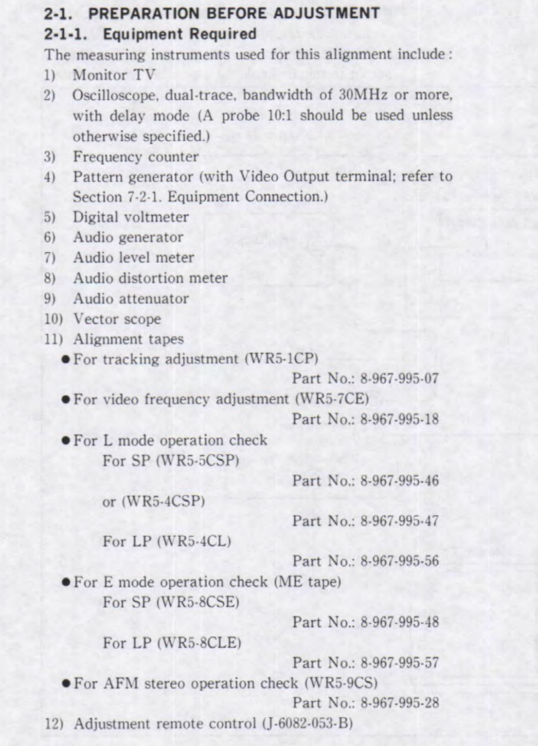

    To do a full service you would need a service manual, an oscilloscope and test tapes to be able to do all the calibration and adjustment tasks, But keep in mind such test tapes are decades old and no longer reliable, Unless you find them still in the shrink wrap I wouldn't buy any used ones, but that's almost impossible due to their rarity. The service manual has a list of equipment needed:
Name:	Screenshot 2024-04-12 115839.png
