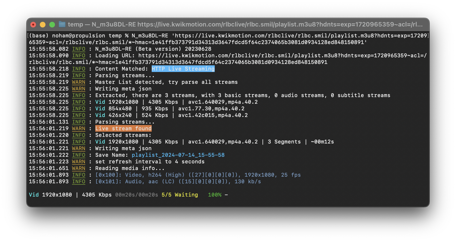

  14. Member aqzs's Avatar
    Mar 2024
    Paris
    You have to grab a fresh m3u8 url that haven't been fetched before. You can do that by blocking the request in devtools or making a python script to retrieve it.
    [Attachment 80727 - Click to enlarge]
  15. Thank you aqzs
    So i understand by the way, there is no way to use a same/unique generated link by several people or/and several times ?
    Thanks again for you possible confirmation and help too if any
    For example: tokened link inside of that main/master link can be used more than once, on several clients/people.
    https://raw.githubusercontent.com/ipstreet312/freeiptv/master/ressources/btv/py/lci1.m3u8
    So we can not do the same here for lbc, like lci channel.
    Regards
  16. Member aqzs's Avatar
    Mar 2024
    Paris
    No for that website link seems to be only fetched once and return 403 after.
    Those aren't the same stream plateform.
