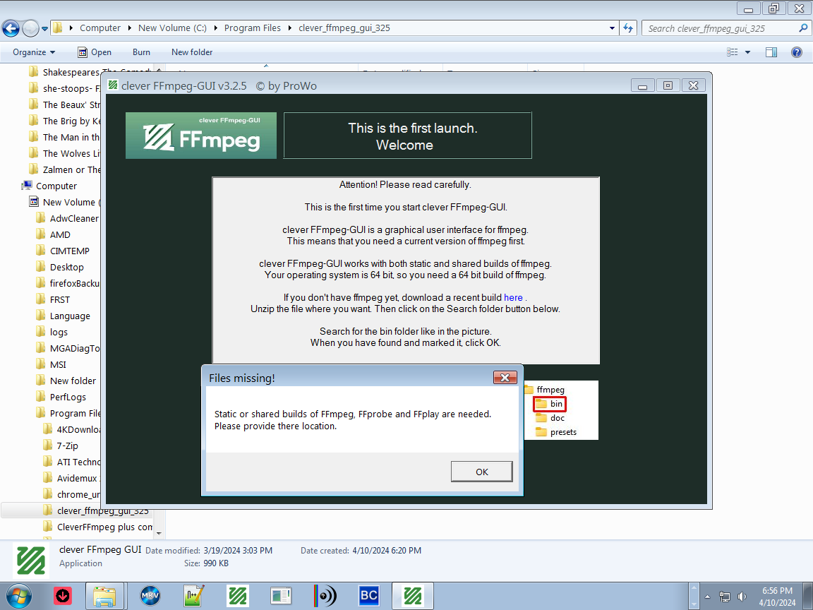

    I must have been able to pull these elements of FFMpeg together last time. Right now I have the Github Master located on the desktop along with the GUI. These did not go to Programs Folder as I would expect. What is left to do?
  12. On the FFMpeg, I moved the Master folder and GUI folder to Programs and tried the search function. Still have errors. I need the static or one of the builds yet for GUI to work. The help file in the GUI, well I'm not getting it right.
  13. Now I have three FFMpeg folders and moved to programs. FFMPEG v. 7.00, the Master from Github and Clever GUI. I don't follow the difference between static and shared versions. I will see if the GUI can see version 7.00.
  14. Here is the latest screen shot. FFprobe, etc. not found.
    Should I be pointing to the Master rather than V. 7.00? I have no idea. In the readme they don't mention any of the FFprobe etc stuff.
    I'll come back to this when I'm rested.
Name:	ffmpeg probe ffplay.png
