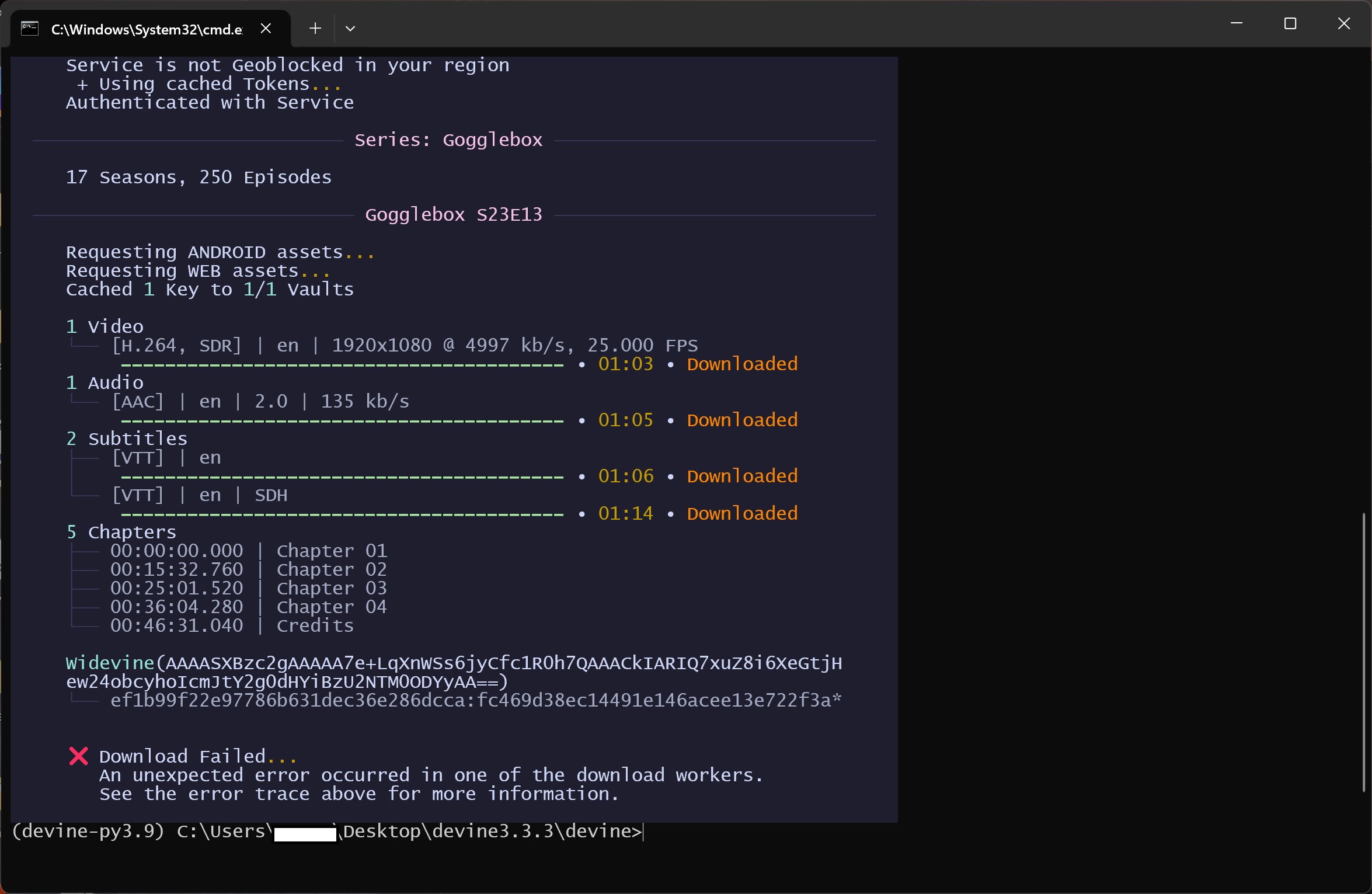

  10. Does anyone know why I am getting this error message when downloading with ALL4? I thought it may have been aria2c but commented that out and tried again but the same thing happened. I tried different shows and that didn't change anything.
    [Attachment 79008 - Click to enlarge]

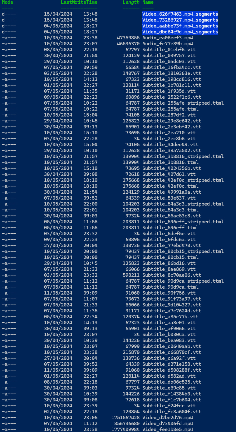

  11. When you execute in PS the following:
    ls $home\AppData\Local\Temp\devine\
    Do you have the following files there: ?
    Mode                 LastWriteTime         Length Name
    -a----        10/05/2024     20:46       83448955 Audio_386a01a3.mp4
    -a----        10/05/2024     20:47          77656 Subtitle_1d9d5e.ttml
    -a----        10/05/2024     20:46          77656 Subtitle_1d9d5e_stripped.ttml
    -a----        10/05/2024     20:45     8194719224 Video_c5d910cd.mp4
    If I was in politics I make sure you drink plenty of beer
    and watch plenty of TV to keep you busy. | Data is the new oil.
  12. I have quite a lot of files in there...
    [Attachment 79013 - Click to enlarge]
  13. Originally Posted by SaLTy View Post
    79008
    Check the logs and see if you can find where it fails.

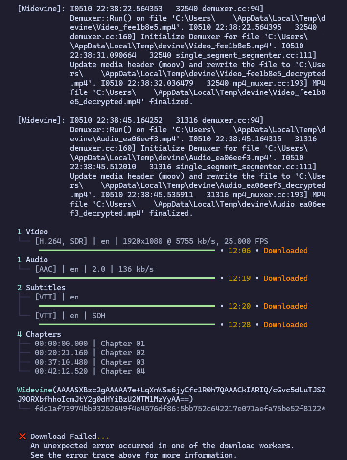

  14. Originally Posted by stabbedbybrick View Post
    79008
    It doesn't say anything else in the logs, just the below. It usually takes a while and says it downloads but then right at the end it fails. Doesn't happen all the time but occasionally it does. I went back to Freevine to download the file. This morning it download OK but took quite some time.

  16. Originally Posted by SaLTy View Post
    you have
    I believe that the video after it has been MUXed to MKV, should have been deleted
    from that DIR, unless there was an error as is in your case and its still there with others .......
    That particular video has a timestamp of 22:38:22 - 28:38:45 ( fast download and file name:
    Video_fee1b8e5_decrypted.mp4
    Audio_ea06eef3_decrypted.mp4
    The subs will be around the same time ....(so sort the files by TIME and you get the right Video/Audio/Subs)
    (Check the files have been decrypted...)
    You can either use MKVToolNix GUI and mux them into an MKV container
    or use FFMpeg to mux to MP4 container:
    #SUBS if they are in TTML: (check how to install it in my other posts here..) not sure what ALL4 uses ...
    tt convert -i $home\AppData\Local\Temp\devine\Subtitle_1d9d5e.tt ml -o $home\AppData\Local\Temp\devine\Subtitle_1d9d5e.sr t
    #PS Command:
    ffmpeg -hide_banner `
    -i $home\AppData\Local\Temp\devine\Video_c5d910cd.mp4 `
    -i $home\AppData\Local\Temp\devine\Audio_386a01a3.mp4 `
    -i $home\AppData\Local\Temp\devine\Subtitle_1d9d5e.srt `
    -strict experimental `
    -map 0 -map 1 -map 2 `
    -c:v copy `
    -c:a copy `
    -c:s mov_text `
    -c:d copy `
    -map_metadata 0 `
    -metadata title="Mammals Series 1: 6. Forest" `
    -metadata description="From the barren Australian outback to the remote, dry deserts of Namibia, mammals use their ingenuity, incredible intelligence and remarkable resilience to beat the heat." `
    -metadata comment="https://www.bbc.co.uk/iplayer/episode/m001z1fp/mammals-series-1-6-forest" `
    -metadata year="2024" `
    -metadata:s:v:0 language=und -metadata:s:v:0 handler_name=Und -metadata:s:v:0 title="2160p | h265 - HDR HLG | 25FPS" `
    -metadata:s:a:0 language=eng -metadata:s:a:0 handler_name=English -metadata:s:a:0 title="eng | English AAC LC 2.0 (Stereo) fltp, 189 kb/s (default)" `
    -metadata:s:s:0 language=eng -metadata:s:s:0 handler_name=English -metadata:s:s:0 title="eng | English SRT" `
    -f mp4 -movflags use_metadata_tags `
    -ignore_unknown -copy_unknown `
    $home\AppData\Local\Temp\devine\Mammals.S01E06.Forest.2024.2160p.iPl.WEB-DL.AAC.LC.2.0.HDR.HLG.H.265.mp4 -v verbose
    It would also help if you included version of Devine and your "devine.yaml" config (redacted of log-in details)...
    devine cfg --list
    DIR where log files are stored will show you this command:
    devine env info
    Default on my Win setup is:
    ls $home\AppData\Local\devine\Logs
    Adding this to your command may provide more information:
      -d, --debug     Enable DEBUG level logs.
    Using an VPN/Proxy or residential UK IP?
  17. Originally Posted by SaLTy View Post
    79008
    Run debug and then check the logs in your devine root folder:
    devine --debug dl -w EPISODE all4 TITLE

    I think the files do decrypt but fails right at the end, I didn't realise they were kept in a temp folder. I am on the latest version of Devine and my devine.yaml is the following:
    directories:

    i got the same
    [Attachment 79018 - Click to enlarge]

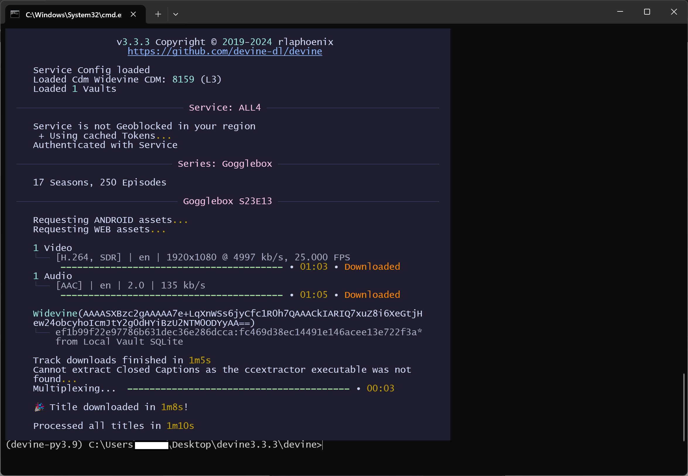

    edit: i try to download without subtitles, it works fine
    devine dl -V -A -w s23e13 ALL4 gogglebox
    There is something wrong with subtitles
    [Attachment 79020 - Click to enlarge]

    Just installed fresh Devine (3.3.3) and cloned your SERVICES
    devine --debug dl -q 216 -v H.264 --no-folder --sub-format TTML -w s23e13 ALL4 gogglebox
    I want to stop Devine MUXing to MKV, hence the "--sub-format TTML".
    ───────────────────────────── Gogglebox S23E13 ─────────────────────────────
    ╭───────────────────────── Available Tracks ─────────────────────────╮
    │ 10 Videos │
    │ ├── [H.264, SDR] | en | 1920x1080 @ 4997 kb/s, 25.000 FPS │
    │ ├── [H.264, SDR] | en | 1920x1080 @ 2957 kb/s, 25.000 FPS │
    │ ├── [H.264, SDR] | en | 1280x720 @ 2023 kb/s, 25.000 FPS │
    │ ├── [H.264, SDR] | en | 1024x576 @ 1528 kb/s, 25.000 FPS │
    │ ├── [H.264, SDR] | en | 1024x576 @ 1183 kb/s, 25.000 FPS │
    │ ├── [H.264, SDR] | en | 640x360 @ 1007 kb/s, 25.000 FPS │
    │ ├── [H.264, SDR] | en | 640x360 @ 803 kb/s, 25.000 FPS │
    │ ├── [H.264, SDR] | en | 512x288 @ 505 kb/s, 25.000 FPS │
    │ ├── [H.264, SDR] | en | 384x216 @ 257 kb/s, 25.000 FPS │
    │ └── [H.264, SDR] | en | 256x144 @ 158 kb/s, 25.000 FPS │
    │ 1 Audio │
    │ └── [AAC] | en | 2.0 | 135 kb/s │
    │ 2 Subtitles │
    │ ├── [VTT] | en │
    │ └── [VTT] | en | SDH │
    │ 5 Chapters │
    │ ├── 00:00:00.000 | Chapter 01 │
    │ ├── 00:15:32.760 | Chapter 02 │
    │ ├── 00:25:01.520 | Chapter 03 │
    │ ├── 00:36:04.280 | Chapter 04 │
    │ └── 00:46:31.040 | Credits │
    So I am trying the lowest quality 144p, but that did not download (listed, but not available??)...
    216p worked.
    The subs I have had 2 files downloaded as usual:
    1. First one *.vtt with text inside:
    WEBVTT
    NOTE Subtitles are missing
    2. Second one *.vtt has the actual subs inside ...
    Also tried downloading only Subs:
    devine --debug dl -S --no-folder -w s23e13 ALL4 gogglebox
    Result is an ERROR with 2 subs as above (one text with missing subs and one with the actual subs)...
    On the other hand trying:
    devine --debug dl -q 216 -v H.264 --no-folder --sub-format TTML -w s02e05 ALL4 late-night-lycett
    And there is only one Subs file and only has "Subtitles are missing" .....
