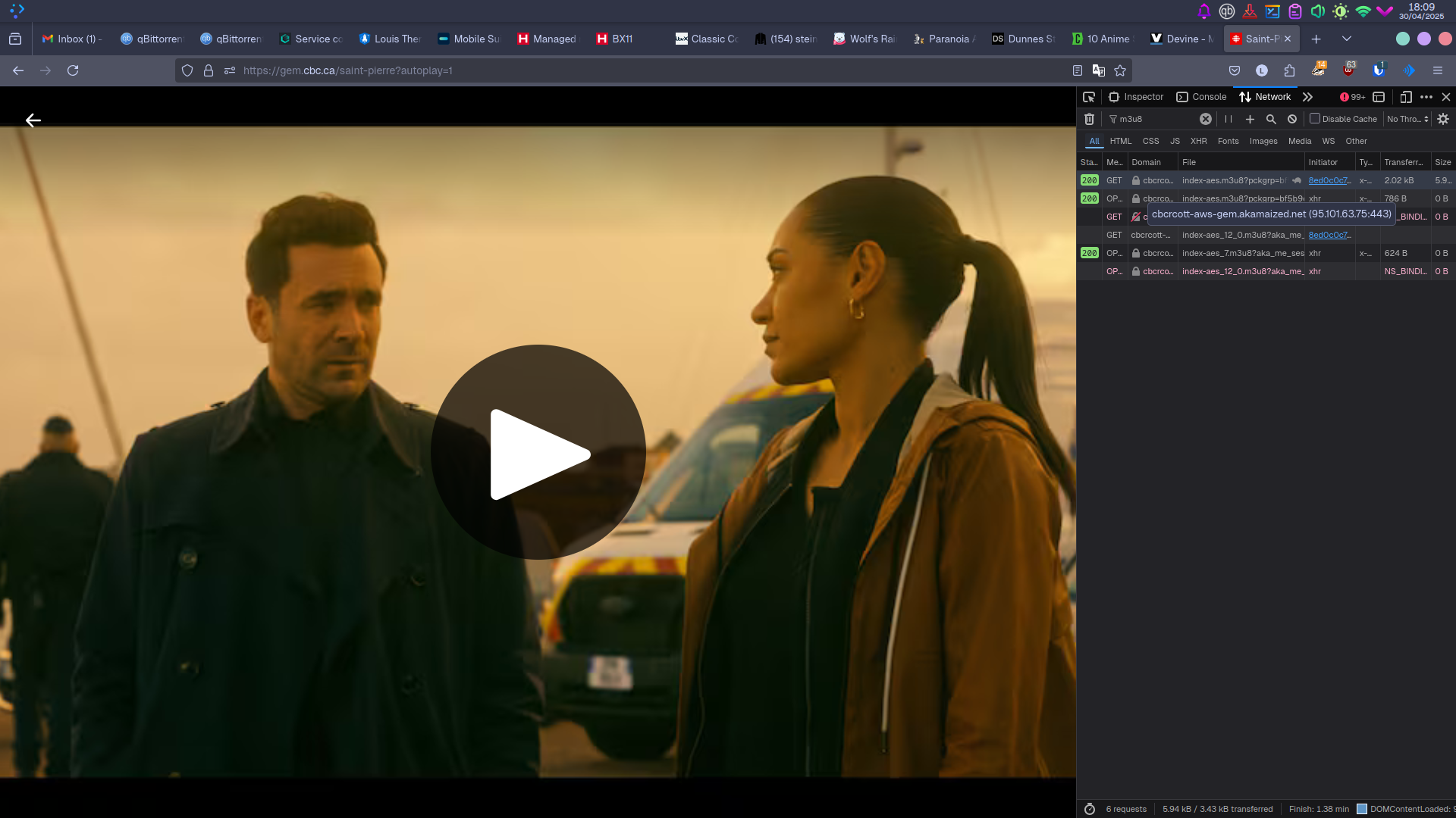

    Briefly, open the video page and inspection console search m3u8, and grab the url for index.m3u8
    [Attachment 86791 - Click to enlarge]
    In this example the url provided is
    https://cbcrcott-aws-gem.akamaized.net/out/v1/12fc1352a15d40e1957ac41ee39356d4/026bf27581e640c4b4fb78ae5aaa5021/4992c413374a4be4af23a7b5453f28df/index-aes.m3u8?pckgrp=bf5b9c2800b7e86d48330ceb5add54a4&ewid=83317&manifestType=desktop&hdnea=st=1746032914~exp=1746033034~acl=*~hmac=58e094f50aabe60c4b9c932711c73139a5120dade704cad8e1b540fa0f24ca79&EIA608ClosedCaptions=true&lang=en
    change the type flag from desktop to smarttv
    https://cbcrcott-aws-gem.akamaized.net/out/v1/12fc1352a15d40e1957ac41ee39356d4/026bf27581e640c4b4fb78ae5aaa5021/4992c413374a4be4af23a7b5453f28df/index-aes.m3u8?pckgrp=bf5b9c2800b7e86d48330ceb5add54a4&ewid=83317&manifestType=smarttv&hdnea=st=1746032914~exp=1746033034~acl=*~hmac=58e094f50aabe60c4b9c932711c73139a5120dade704cad8e1b540fa0f24ca79&EIA608ClosedCaptions=true&lang=en
    [Attachment 86792 - Click to enlarge]
    After that, you can figure it out for yourself
    Good luck

    I am sorry I was not able to get that method to work WiskeyJack. N_m3U8DL-RE spit out "htpps is not a caommand" and the list goes on. Sainte Pierre" was actually the show I was working on so that is quite a coinidence that was the example you provided. I finished up with Devine to get what I was missing.
    Thank you WiskeyJack for your kindness.
    Did you place the url in quotations?
    n-m3u8-re "<target-url>"
    Saint Pierre was the first page that opened on my browser, I ripped the show months back and uploaded it in a few places.
  6. No I didn't put it in quotations and I now put in the program name in and I am getting closer as it looks like other than 403 forbidden error it is getting closer. I am going to sign out here and go to CBC Gem and sign in and see about getting a video to archive.
    Saint-Pierre I am giving it a second chance it didn't suck me in like "The Republic Of Doyle" which I liked so much I memorized the theme song.
  7. Sorry I am getting stopped by a 403 error. I was signed into CBC Gem and finally got the correct url and put in the line of code but it has failed. Regardless even if this doesn't work for me I appreciate your advice and I am bit ashamed for sidetracking this thread about Devine.
    I'm back after taking a closer look at your first screenshot I see the "lock" url and that must be the one with the token. I also looked up 403 error here at Videohelp so I am going to give this a try again and see if I can be successful at this.

    the link expires, you need to get a fresh link
    it will be the link that aligns with
    200 | get | cbcrcott | index-aes.m3u8?pckgrp=
    Which is usually the first one that loads on FF/Zen

  10. I had success and the subititles are embedded in the video file. I am sure there is a command that can be added into the command line to mux the audio and video together. The chapters were not included but they download so fast via Devine that one could get them just by requesting Devine to get the chapters only and it would be just a matter of seconds and then just mux them into the file as well I would think. Though other than be a tad slower with Devine and then the download stopping for whatever reason for certain videos in your episode range it is a terrific tool. Perhaps it is something like one's anti-virus updating itself that wants some bandwidth to do its task and Devine doesn't want to share. TUBI doesn't usually give me this problem but it very noticable on the UK Services and CBC.
    Devine is terrific and I am sorry for this distraction. Thanks WiskeyJack and thank you for your patience. For whatever reason I never did see the red padlock icon and it wasn't first in line but "pckgrp=" eventually was noticed by me. Also this has opened up my mind like on that 2001 A Space Odyssey moment where they play Rick Flair's Wrestling Entrance Music. The tokens part of CBC Devine this is what this code is. I feel rather smart but I am sure it is just a momentary illusion.
