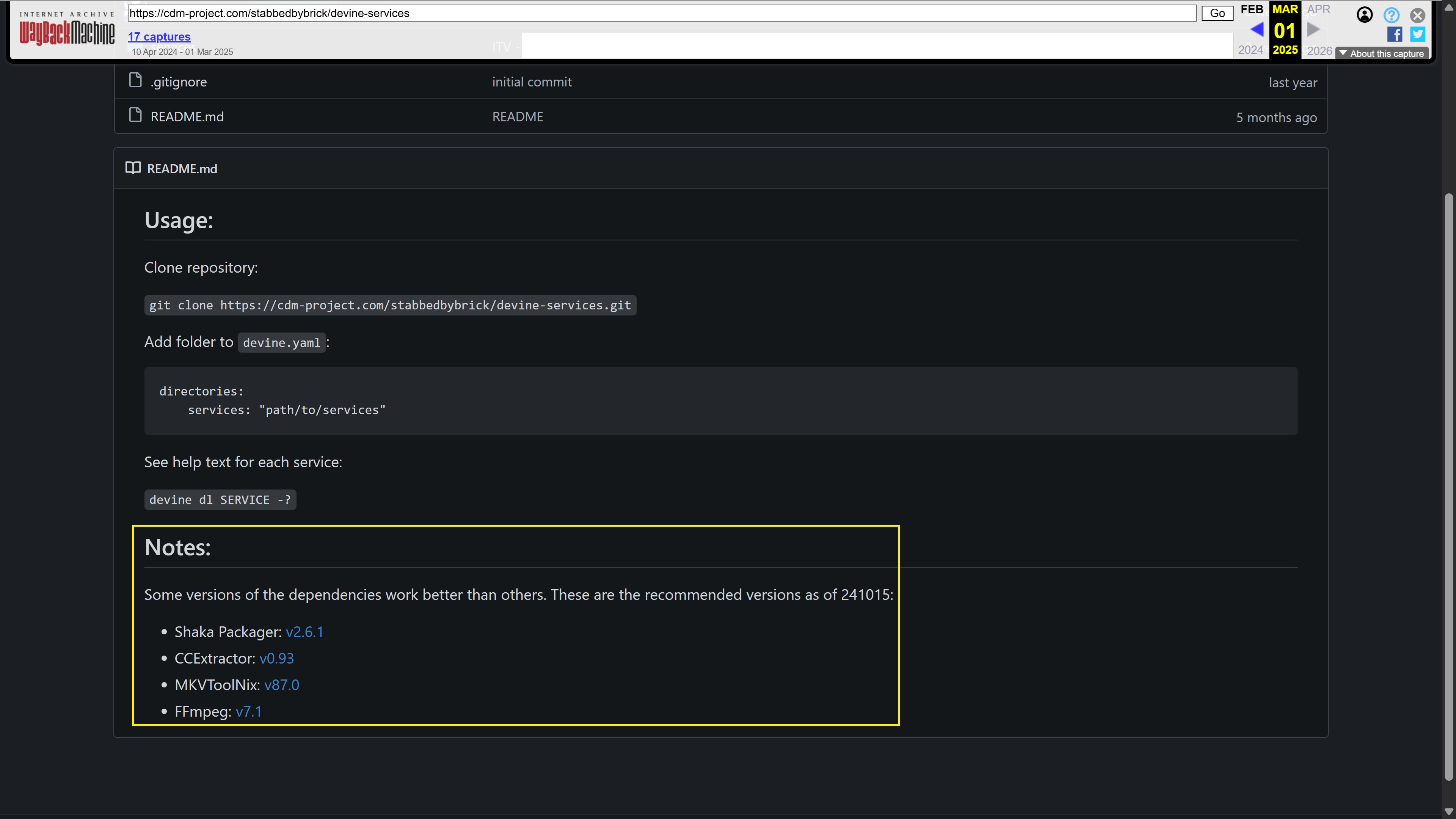

  5. 2nd Army Bridgeburners. WhiskeyJack's Avatar
    Aug 2024
    Torshavn
    Originally Posted by iamkennethy_ View Post
    Originally Posted by F1sav28 View Post
    You are using the latest service? I recall something to do with Tubi now needing aria2c, I think the updated service dictates that. Check what downloader you have set. There was Tubi chat in this thread not too long ago, have a scrape back through (if you haven't already).
    i got aria2c downloaded straight from the devine github and downloaded the services file that was uploaded yesterday but it still shows the same error. i did see some activity abt tubi and saw someone put a whole code there but i dont know how i can fix it my own way.
    i have devine (that i created) in my downloads folder and the aria2c file is in there but again it still shows the same error.
    THe errors point to something other than the service file or aria2c (And since you've provided no logs I can only make an assumption this is similar to what happened with CBC.)
    So, at a guess the video file is downloaded, TUBI being a US provider most likely used Closed Captions for subs.
    Devine extracts the embedded cc files from the merged video file BEFORE it downloads the audio and srt (in a default download command), it fails getting the CC stream and exits the operation.
    What version of ccextrator are you using? That last release has bugs that have not been fixed for some time. Get ccextractor 0.90 from here https://github.com/CCExtractor/ccextractor/releases/tag/v0.90 (I've no idea what OS you are using, most likely Windows so grab the msi file. On linux, you'll have to do the hard work yourself- if on arch manually install from aur snapshot via https://aur.archlinux.org/cgit/aur.git/commit/?h=ccextractor&id=aa6ffdbbc992325cb87fa3...9ce4aba18cfe8b )

    im using the current version of ccextractor. also, i use windows (windows 11)
    Dec 2022
    Lesotho
    You must use 0.93 (or earlier).

    The current version is broken, reread my reply sbove again. And then reread it. Version 0.90 is the working version. 0.94 WILL NOT WORK!!

    [Attachment 86379 - Click to enlarge]

  30. Are services now taken offline? I only get 404 trying to access the URL
    remote: Not found.
    fatal: repository 'https://cdm-project.com/stabbedbybrick/devine-services.git/' not found
