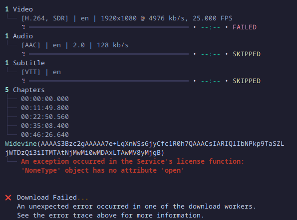

  5. Hi,
    Currently getting this from all services except iPlayer:
    [Attachment 85899 - Click to enlarge]
    As far as I can tell I've set everything up right, but clearly not. I'm running devine on Fedora 41.
    Mar 2024
    Something wrong with either your Widevine device (wvd file) or configuration.
    iPlayer does not use DRM so might explain why that works.
  7. The .wvd works ok with freevine so I guess that's fine. The service files are the ones from devine-services so I guess they're good too, so it must be something in the devine.yaml file? I've not changed anything else.
    Looks like it was a formatting error in the devine.yaml, thanks SaintyUK.

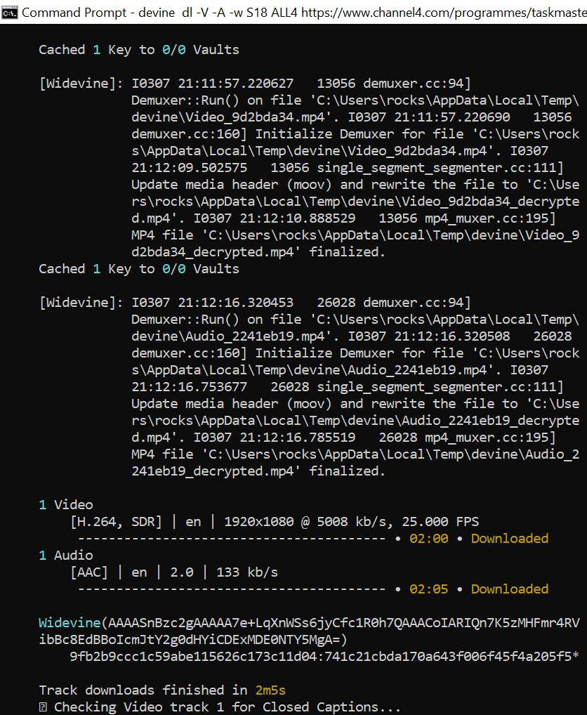

  8. Is there any way to not check at all for captions? Even with -V -A (see command at top of window) devine still checks for closed captions. Image
    [Attachment 85975 - Click to enlarge]
    EDIT: Bit of a brute force way, but commenting out lines 577-615 in dl.py in the pip package completely disables the closed caption part of the code. -V -A must be broken.

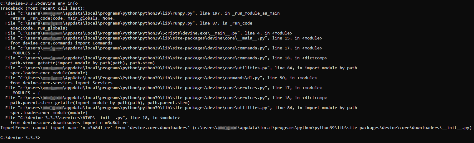

  20. I am a new devine user and trying to set it up. When I run "devine env info" I am getting the below error. Could someone please help how I can fix it?
    I have all the tools (aria2c.exe, mp4decrypt.exe, N_m3u8DL-RE.exe etc.) in C:\devine-3.3.3\binaries
    If you created a virtual environment, doesn't look like you started it. Double check that.
  22. Originally Posted by ehurdler View Post
    Thanks for responding! I didn't know that was required. So, I ran poetry env activate from C:\devine-3.3.3 folder. Then I ran activate.bat from C:\devine-3.3.3\.venv\Scripts and then tried running devine env info from (devine-py3.9) C:\devine-3.3.3\.venv but I still get the same error.
    Not sure what am I doing wrong.
    Just at a guess, the error says it can't find n_m3u8dl_re in the downloaders folder
    rename N_m3u8DL-RE.exe to n_m3u8dl_re.exe Windows may not give a flying hoot about case, but other systems do....
    Also, just an asside. How have you installed this? Via github pull and poetry install or via pipx?
    For ease of use, install via python pip
    https://pypi.org/project/devine/
    when installed, issue the command
    devine env info
    and start configuring properly, it should hint at where your devine.yaml can be loaded from and edit that to point to WVD and devine services.

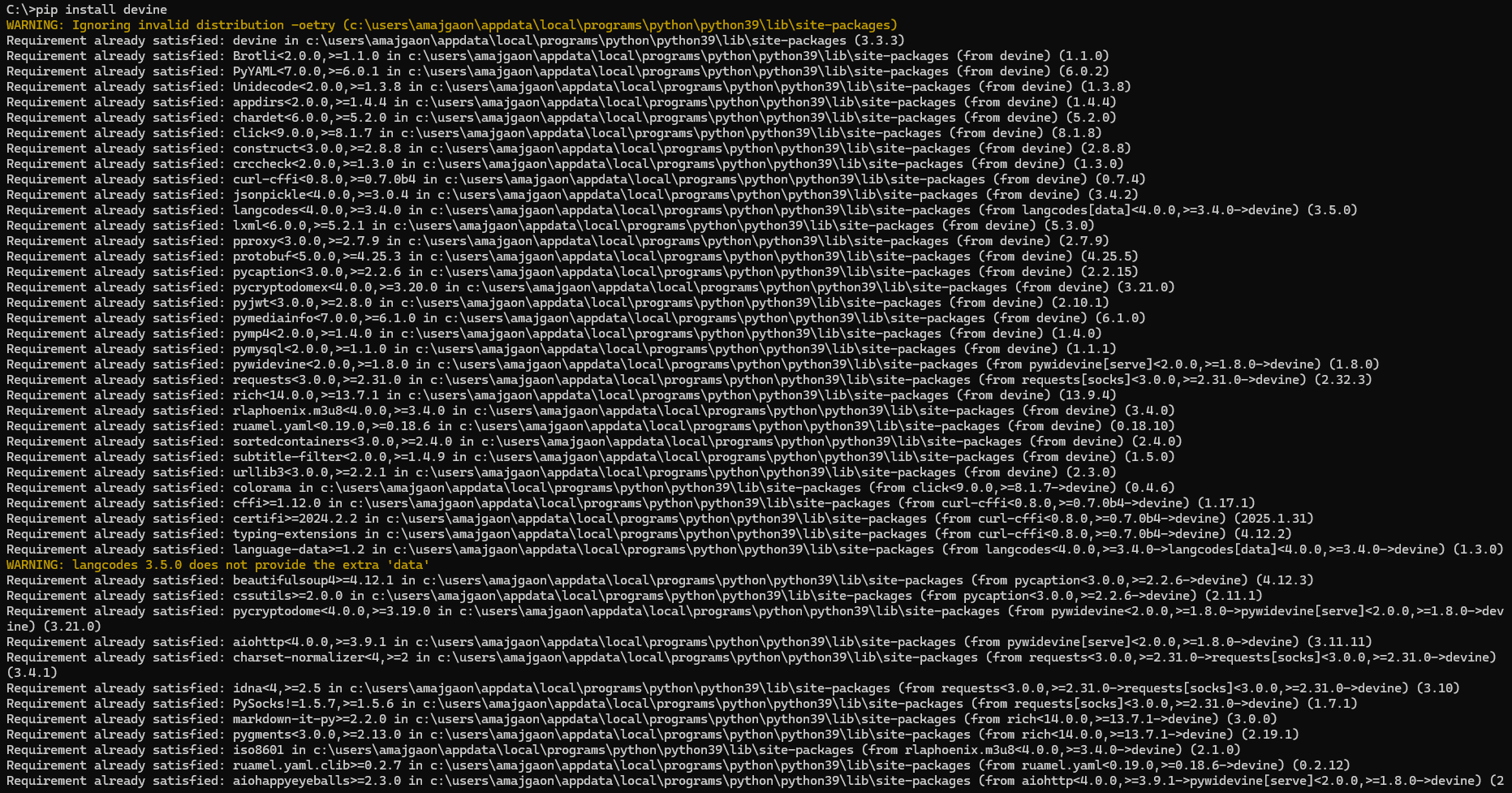

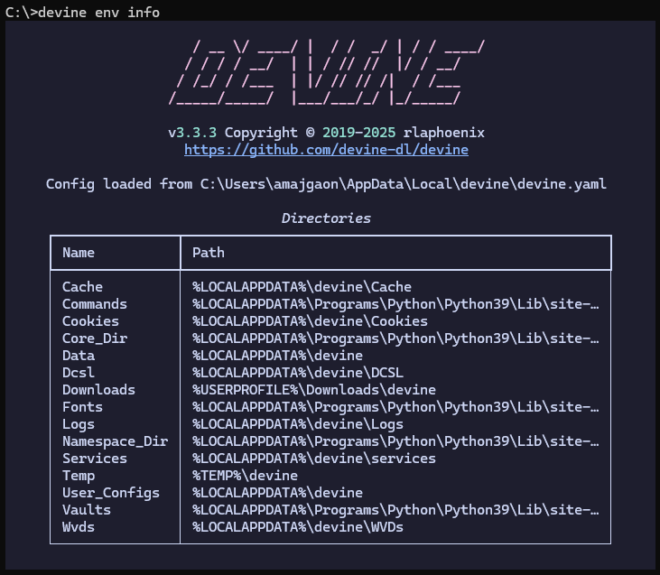

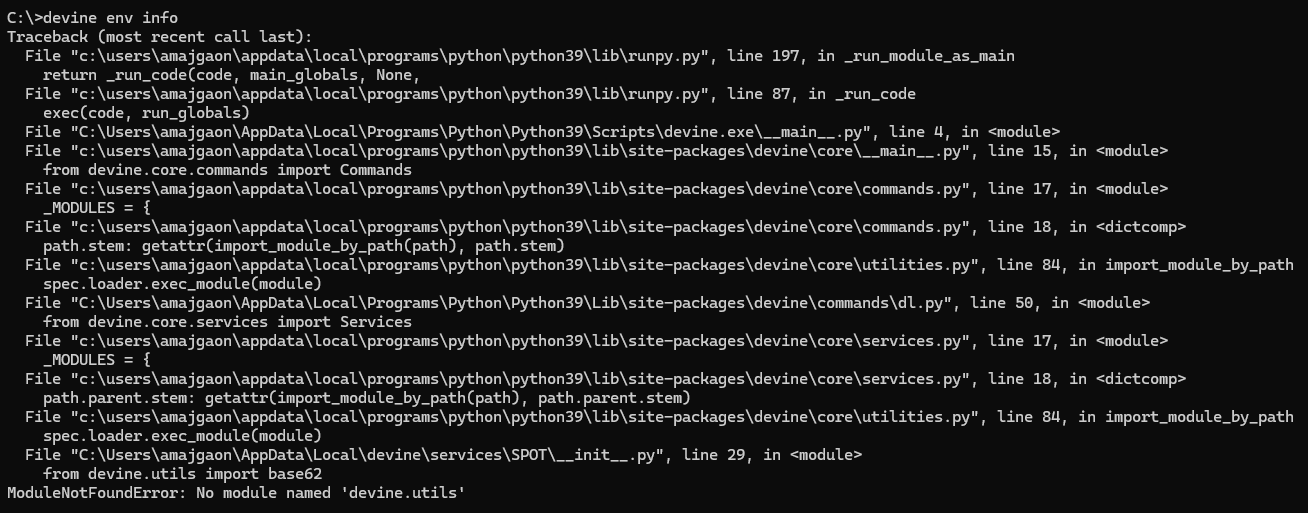

  25. Thanks for your responses, @PunchDrunkL0ve & @WhiskeyJack!
    So, I ran pip install devine and it shows that I already have it installed as a module/package see below.
    Then when I ran devine env info I see the screen with Devine logo and paths listed.
    After that, when I add different services (subfolders) in the C:\Users\amajgaon\AppData\Local\devine\services folder & run the devine env info again, I get an error (last image).
