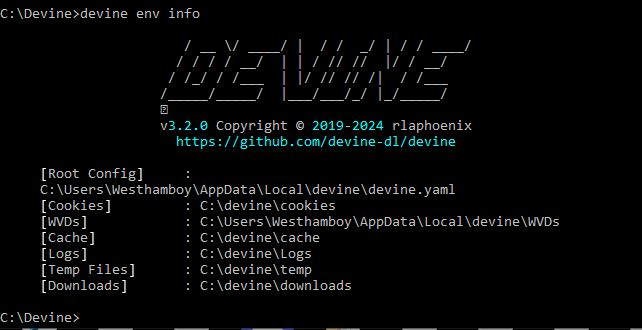

    so the devine.yaml within C:\Users\xxxxxx\AppData\Local\devine caused the error message.
    I am back to having this:

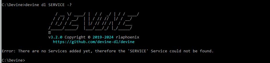

    [Attachment 78287 - Click to enlarge]

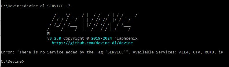

    and this when i type: devine dl SERVICE -?
    [Attachment 78288 - Click to enlarge]
    I cannot give up hope.....

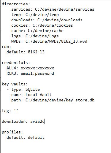

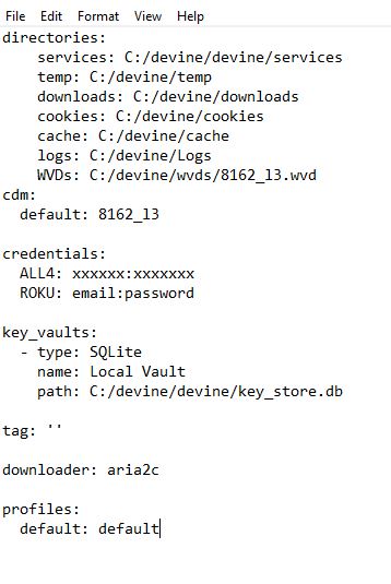

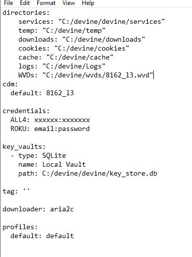

    decided to re-edit my devine.yaml (the one inside C:\Devine\devine) to this
    [Attachment 78290 - Click to enlarge]
    (yes i know the image shows uppercase WVDs)... but it looks like this:
    directories:
    services: C:/devine/devine/services
    temp: C:/devine/temp
    downloads: C:/devine/downloads
    cookies: C:/devine/cookies
    cache: C:/devine/cache
    logs: C:/devine/Logs
    WVDs: C:/devine/wvds/8162_l3.wvd
    Still the same....
    Error: There are no Services added yet, therefore the 'SERVICE' Service could not be found.
  5. Delete the config.yaml in your current 'devine' directory. When you run 'devine env info', it will tell you that it is reading from your users/USER/AppData/Local/devine and that is the one and only config.yaml that matters. Delete all other copies so you don't confuse yourself.
    I repeat, do all of these things.
    - directories need to be in quotation marks and use forward slashes
    - do not include the name of the wvd file in wvds
    - It's not "WVDs:", it's "wvds:" all lowercase
    - "ALL4:" needs an "email and password" (you probably had this, just deleted it for posting)
    When you run "devine cfg --list" it will tell you everything that it read from your config file. If it read the services correctly, it will display it there.

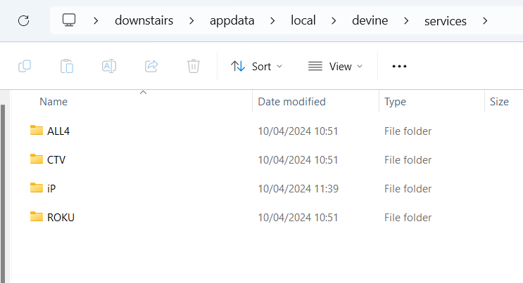

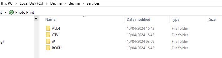

  6. I know it sounds daft, but do you realise that you have two devine folders mentioned in your config file? Are you sure that is where your services folder is?
    As soon as I pointed my devine.yaml to my services folder I get the following message when I use your devine dl service -?
    Error: "There is no Service added by the Tag 'service'". Available Services: ALL4, CTV, ROKU, iP
    so it is definitely picking my services up.
    Are you 100% sure there is no more devine.yaml files anywhere on your PC? I always install the everything app on my PCs - https://www.voidtools.com/downloads/ which is great for finding out if you have two copies of files.
    Also, in your services folder does it look like this :
    [Attachment 78292 - Click to enlarge]

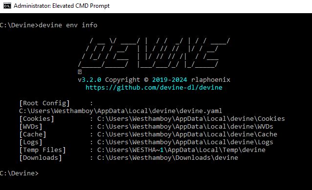

  7. okay achilles,
    all other config.yaml's have been removed.
    only have one now, and that is in C:\Users\xxxxxxxx\AppData\Local\devine

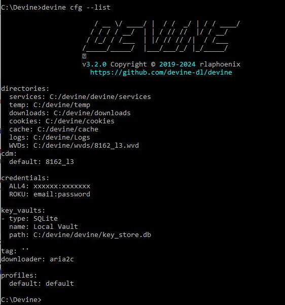

    devine cfg --list gives this:
    [Attachment 78293 - Click to enlarge]

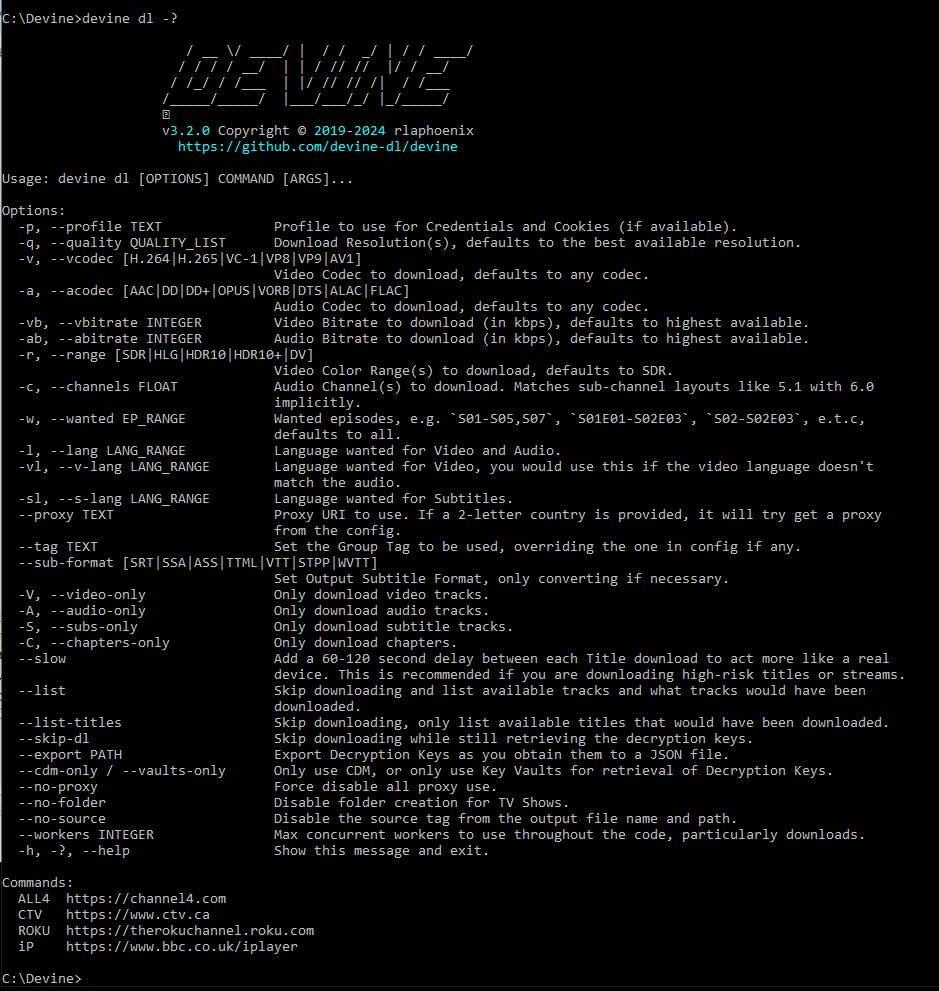

  9. hi peterb, yes, services folder is in : C:\Devine\devine\services
    and looks like this:
    [Attachment 78294 - Click to enlarge]
    nothing in these have been touched.
  10. Originally Posted by LastResort View Post
    That's because your config.yaml has errors. Please post the contents of your now one and only config.yaml.

    devine.yaml now looks like this:
    [Attachment 78296 - Click to enlarge]
    Is there anything that needs to be corrected,.. because where this file is now, creates the error message.
    (achilles please read this as if i am answering both yourself and pssh)

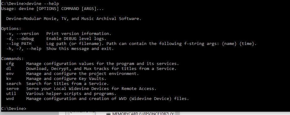

  15. I have tried
    devine --help
    devine cfg --list
    devine env info
    all of them show the exact identical error
    [Attachment 78298 - Click to enlarge]

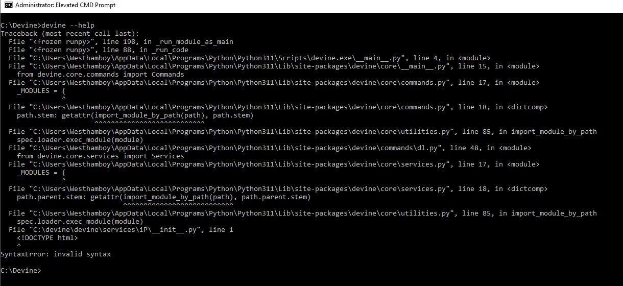

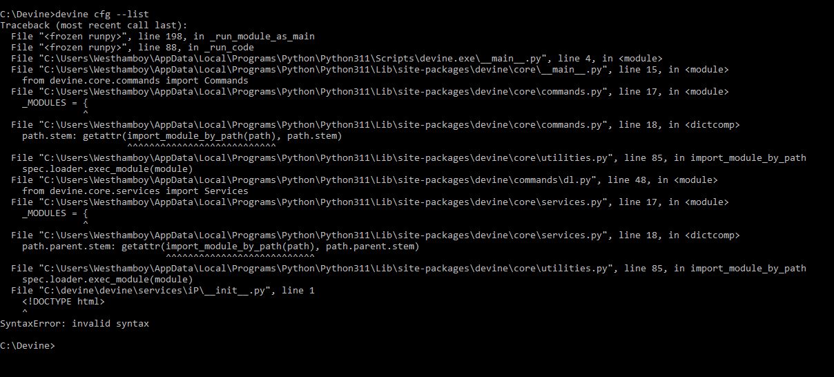

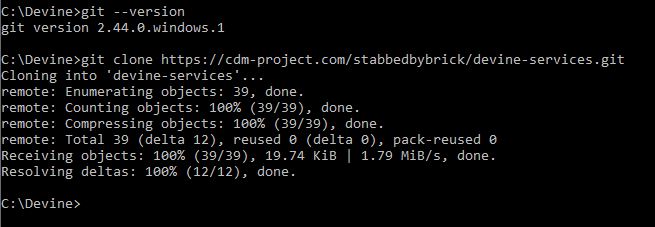

  17. @LastResort:
    You've downloaded the html page of the script, not the script itself...
  18. Originally Posted by stabbedbybrick View Post
    @LastResort:
    You beat me to it. As I looked at the error again, I see that it is trying to load iP service code and received
    "<!DOCTYPE html>" instead of "from __future__ import annotations".
    LastResort, best way to dupe the service code is to use git.
    Step 1. Install git.
    Step 2. git clone https://cdm-project.com/stabbedbybrick/devine-services.git

    credentials:
        ALL4: email:password
        #AMZN: email:password
        #NF:  email:password
        #john: john@gmail.com:TheGuyWhoPaysForTheNetflix69420
        #paul: john@gmail.com:TheGuyWhoUsesTheNetflix69421
        #DSNP: jane@gmail.com:TheGirlWhoPaysForTheDisney69422
        #CTV: email:password
        #CBC: email:password
    downloader: aria2c
    #aria2c: prealloc
    aria2c:
      max_concurrent_downloads: 2
      file_allocation: prealloc
    #profiles:
    #   default: default
    #SERVICES - iP - BBC iPlayer CERT.PEM settings
    services:
      iP:
        cert: C:\Users\xxxx\git\devine-services\bbciplayer.pem
    #KEY_VAULT - storing your "kid:key"
    key_vaults:
    - type: SQLite
      path: C:\Users\xxxx\git\devine-services\key_store.db

    I've checked to see if i have git installed,... yes, already installed.
    git clone done as seen here:
    [Attachment 78301 - Click to enlarge]
    all of the required files are already inside Devine folder. C:\Devine
    My devine folder came from an upload by iamghost,... I have now downloaded it directly from https://github.com/devine-dl/devine/releases/tag/v3.3.1
    unpacked devine-3.3.1.zip and copied into C:\Devine over-writing all files.
    devine env info gives this:
    no point in uploading the same error message again.... but basically it's the one with this at the end of the error
    spec.loader.exec_module(module)
    File "C:\devine\devine\services\iP\__init__.py", line 1
    <!DOCTYPE html>
    SyntaxError: invalid syntax
  21. Originally Posted by stabbedbybrick View Post
    @LastResort:
    Yep, I can guess what most are thinking.... but where is the script located please stabbed... so that i can at least delete the thing.
    here:C:\Devine ?? or here: C:\Users\xxxx\AppData\Local\devine ?
  22. When you did the git clone of the services repo, it put it into "c:\Devine\devine-services\services"
    Just delete your old "c:\Devine\services" directory completely. This is where it was trying to read from. Now move "c:\Devine\devine-services\services" one directory up so that it becomes your new "c:\Devine\services".
    As an additional point, I did some testing, and yes, the directories can have quotes or no quotes and can use forward or back slash and all variations seem to work.
    However... the wvds tag must be lowercase for devine to pick it up and its value must not contain the actual .wvd filename. Only the path should be there for it to work.
  23. yes devine-services is in the place you mentioned achilles...
    I have moved "services" folder from C:\Devine\devine-services\services to C:\Devine\devine\services (which as far as I can see is correct.. services folder should be in the C:\Devine\devine\ folder).
    Having it like this gives me: using devine cfg --list
    [Attachment 78304 - Click to enlarge]
    and devine env info gives this:
    [Attachment 78305 - Click to enlarge]
    most are being found except the wvd folder...
    devine dl SERVICE -? gives the following:
    [Attachment 78306 - Click to enlarge]
    (I actually thought it was going to show me something else). alas it was not to be.
    This is a second time:
    You have the paths wrong in your "devine.yaml" config Westhamboy
    Please re-read my earlier post to you
    https://forum.videohelp.com/threads/414154-Devine-Modular-Movie-TV-and-Music-Archival-...e2#post2731338
    As Angela once said, hold on to your chair ......
    Please see this
    https://forum.videohelp.com/attachment.php?attachmentid=78191
  25. It's not finding your wvd directory because as I've repeatedly stated, you need to put "wvds", not "WVDs" in your config.yaml.
    And "devine dl SERVICE -?" is not a valid command. There is no service called SERVICE. It's just "devine dl -?".
  26. It's been a long couple of days chaps.... my apologies.
    devine dl -? gives the following
    [Attachment 78308 - Click to enlarge]
    I have it working achilles.... I wanted to say a massive thank you to all who helped me out...
