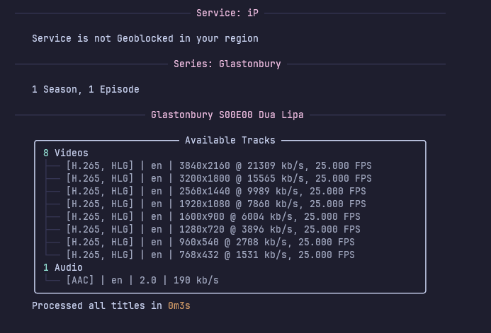

  8. Trying to get the HDR-HLG versions of the Glasto 2024 Pyramid Stage that
    the Beeb is now showing should be available,
    but no luck for the HLG......
    Did any got any luck?
    devine dl --list-titles iP https://www.bbc.co.uk/iplayer/episode/p0j4x4tr/glastonbury-coldplay
      ─────────────────────────────── Service: iP ────────────────────────────────
         Service is not Geoblocked in your region
      ─────────────────────────── Series: Glastonbury ────────────────────────────
         1 Season, 1 Episode
         └── Season 0: 1 episodes
             └── 0. Coldplay
    devine dl --list -v H.264 iP https://www.bbc.co.uk/iplayer/episode/p0j4x4tr/glastonbury-coldplay
      ─────────────────────── Glastonbury S00E00 Coldplay ────────────────────────
         ╭───────────────────────── Available Tracks ─────────────────────────╮
         │ 12 Videos                                                          │
         │ ├── [H.264, SDR] | en | 1920x1080 @ 12000 kb/s, 50.000 FPS         │
         │ ├── [H.264, SDR] | en | 1280x720 @ 5070 kb/s, 50.000 FPS           │
         │ ├── [H.264, SDR] | en | 960x540 @ 2812 kb/s, 50.000 FPS            │
         │ ├── [H.264, SDR] | en | 960x540 @ 1604 kb/s, 50.000 FPS            │
         │ ├── [H.264, SDR] | en | 704x396 @ 1570 kb/s, 50.000 FPS            │
         │ ├── [H.264, SDR] | en | 704x396 @ 827 kb/s, 25.000 FPS             │
         │ ├── [H.264, SDR] | en | 640x360 @ 688 kb/s, 25.000 FPS             │
         │ ├── [H.264, SDR] | en | 512x288 @ 437 kb/s, 25.000 FPS             │
         │ ├── [H.264, SDR] | en | 448x252 @ 436 kb/s, 25.000 FPS             │
         │ ├── [H.264, SDR] | en | 384x216 @ 281 kb/s, 25.000 FPS             │
         │ ├── [H.264, SDR] | en | 256x144 @ 156 kb/s, 25.000 FPS             │
         │ └── [H.264, SDR] | en | 192x108 @ 86 kb/s, 25.000 FPS              │
         │ 3 Audio                                                            │
         │ ├── [AAC] | en | 2.0 | 128 kb/s                                    │
         │ ├── [AAC] | en | 2.0 | 96 kb/s                                     │
         │ └── [AAC] | en | 2.0 | 48 kb/s                                     │
         Processed all titles in 0m1s
    devine dl --list -v H.265 iP https://www.bbc.co.uk/iplayer/episode/p0j4x4tr/glastonbury-coldplay
    No media found. If you're behind a VPN/proxy, you might be blocked
    If I was in politics I make sure you drink plenty of beer
    and watch plenty of TV to keep you busy. | Data is the new oil.

  27. All right, I figured out the missing UHD:
    [Attachment 80387 - Click to enlarge]
    Now I just got to figure out how to properly name things for iPlayer. Devine requires episode and season numbers for everything that isn't a movie, which really messes things up when there aren't any. And I just can't seem to find a consistent way to deal with the horrific listings on iPlayer. If anyone has any ideas, I'm all ears.
    I'll make an effort to rewrite and improve the service code when I get some time.
