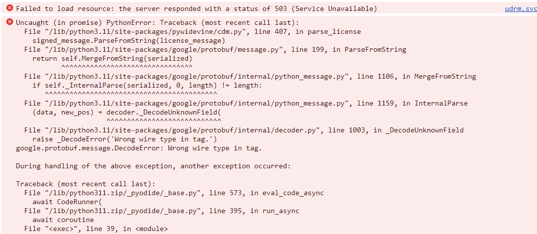

    bud i have same problem on allente
    pyodide.asm.js:9 Uncaught (in promise) PythonError: Traceback (most recent call last):
    File "/lib/python3.11/site-packages/pywidevine/cdm.py", line 407, in parse_license
    signed_message.ParseFromString(license_message)
    File "/lib/python3.11/site-packages/google/protobuf/message.py", line 199, in ParseFromString
    return self.MergeFromString(serialized)
    File "/lib/python3.11/site-packages/google/protobuf/internal/python_message.py", line 1106, in MergeFromString
    if self._InternalParse(serialized, 0, length) != length:
    File "/lib/python3.11/site-packages/google/protobuf/internal/python_message.py", line 1159, in InternalParse
    (data, new_pos) = decoder._DecodeUnknownField(
    File "/lib/python3.11/site-packages/google/protobuf/internal/decoder.py", line 999, in _DecodeUnknownField
    (data, pos) = _DecodeUnknownFieldSet(buffer, pos)
    File "/lib/python3.11/site-packages/google/protobuf/internal/decoder.py", line 978, in _DecodeUnknownFieldSet
    (data, pos) = _DecodeUnknownField(buffer, pos, wire_type)
    File "/lib/python3.11/site-packages/google/protobuf/internal/decoder.py", line 1003, in _DecodeUnknownField
    raise _DecodeError('Wrong wire type in tag.')
    google.protobuf.message.DecodeError: Wrong wire type in tag.
    During handling of the above exception, another exception occurred:
    File "/lib/python311.zip/_pyodide/_base.py", line 573, in eval_code_async
    await CodeRunner(
    File "/lib/python311.zip/_pyodide/_base.py", line 395, in run_async
    await coroutine
    File "<exec>", line 39, in <module>
    File "/lib/python3.11/site-packages/pywidevine/cdm.py", line 411, in parse_license
    raise InvalidLicenseMessage(f"Could not parse license_message as a SignedMessage, {e}")
    pywidevine.exceptions.InvalidLicenseMessage: Could not parse license_message as a SignedMessage, Wrong wire type in tag.
    at new_error (pyodide.asm.js:9:10014)
    at pyodide.asm.wasm:0x158e62
    at pyodide.asm.wasm:0x15ff9e
    at _PyEM_TrampolineCall_JS (pyodide.asm.js:9:120223)
    at pyodide.asm.wasm:0x1a3494
    at pyodide.asm.wasm:0x28a2bd
    at pyodide.asm.wasm:0x1e431e
    at pyodide.asm.wasm:0x1a397d
    at pyodide.asm.wasm:0x1a3c3e
    at pyodide.asm.wasm:0x1a3ce0
    at pyodide.asm.wasm:0x2689a4
    at pyodide.asm.wasm:0x26e800
    at pyodide.asm.wasm:0x1a3e08
    at pyodide.asm.wasm:0x1a3a98
    at pyodide.asm.wasm:0x15f76b
    at Module.callPyObjectKwargs (pyodide.asm.js:9:64297)
    at Module.callPyObject (pyodide.asm.js:9:65365)
    at wrapper (pyodide.asm.js:9:32855)
  21. wow great update! thanks for that
    work fine for me. thank you
    and now nevermind WVCore.Server. nice
    only 2 note:
    1) required more time to get the key, than py script (but i've tested one time only, maybe is due to server response)
    2) i can see SIGNING and CONTENT. the second is the key, alright, but what is SIGNING ?
    anyway a BIG thanks for this new rel
