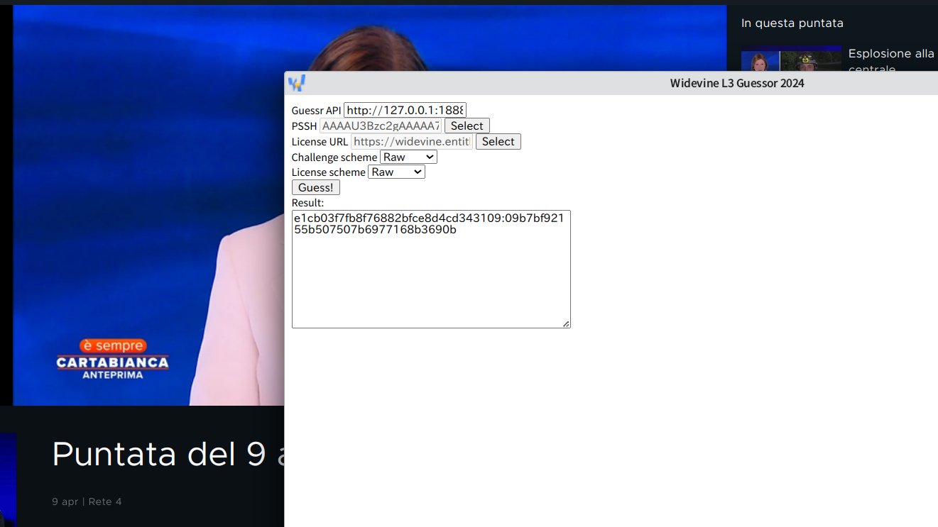

  11. >no IT VPN? ok no problem, i have. but guesser not work (for me)
    Ah, Singapore server worked.thanks.
    Anyway, key fetching works on my side.
    [Attachment 78271 - Click to enlarge]
    >chromium based 109 only
    Try latest version of chrome or firefox.
    This extension use completely differrent way by old guessor extensions.
    So you do not need downgrade browsers.
    And follow the installation instructions on readme.
