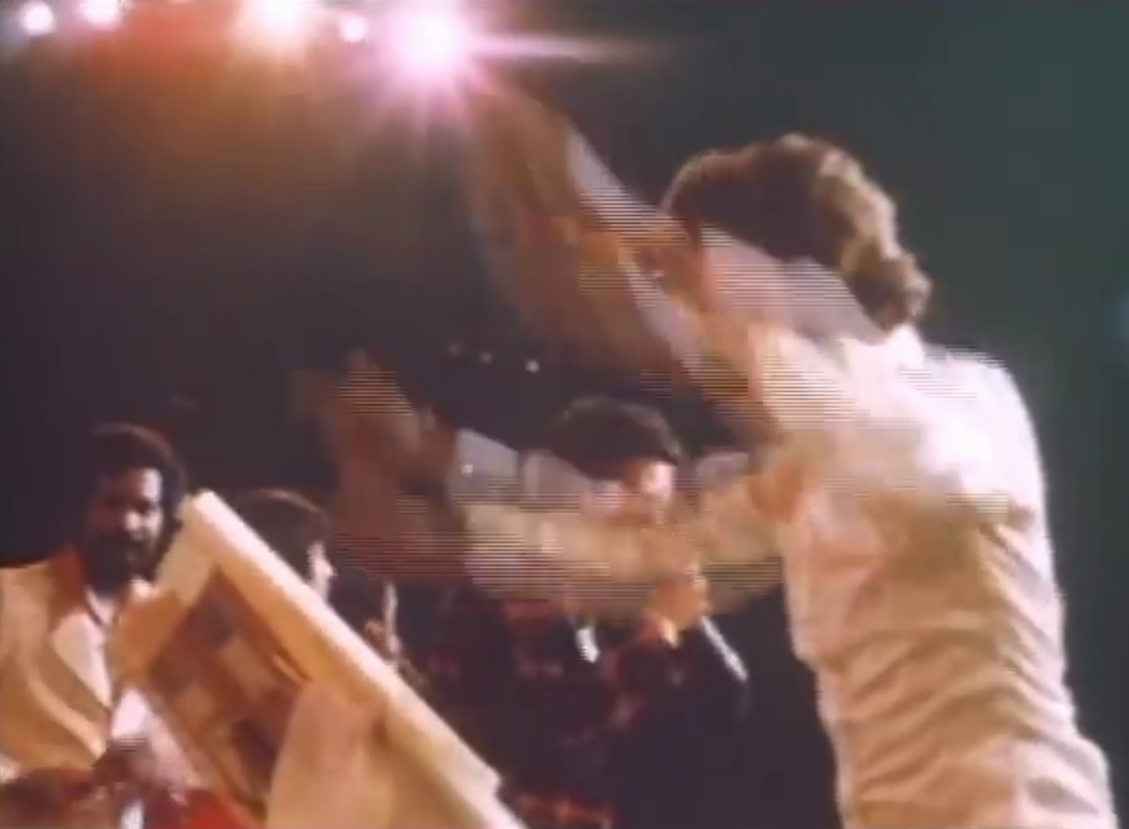

    [Attachment 78228 - Click to enlarge]
    It is a small fragment of a video where you can see some intermediate frames with lines, which of the ways do you recommend me to diminish this effect.
    What would you try to use in the first instance to mitigate it.
    The original format is of very bad quality.
    Thank you very much!
    https://www.mediafire.com/file/b8fn21o5djzcagt/Movie+interlaced.mov/file

    Following the indications of another post, the answer given by Selur also worked perfectly for me.
    QTGMC_BasicVSR++_NNEDI3
    [Attachment 78246 - Click to enlarge]

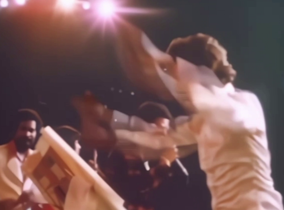

  3. How about this?

    You really did an excellent job. I really like the final result. I would like to know what path you took to solve it, I watched the video and it looks really good. It exceeded my expectations.
    How about this?
  5. It will probably take a lot of work to do the entire video -- you'll have to adjust the code for every break in the pattern. But here's what I did for the short clip:
    LWLibavVideoSource("Movie interlaced.mov")
    src = last
    BilinearResize(width,240).Spline36Resize(width,height)
    p1 = Overlay(last, Loop(2,0,0), mode="Subtract", opacity=0.5).ColorYUV(gain_y=256, cont_u=256, cont_v=256)
    p2 = Overlay(last, Trim(1,0), mode="Subtract", opacity=0.5).ColorYUV(gain_y=256, cont_u=256, cont_v=256)
    p12 = Merge(p1, p2.Trim(1,0))
    p12 = p12.SelectEvery(5, 1,1,1,1,1)
    Interleave(src, p12)
    SelectEvery(10, 0, 3, 5, 6, 8)
    TDecimate()
    # some temporal noise reduction may help here
    ConvertBits(8) # for x264 cli
