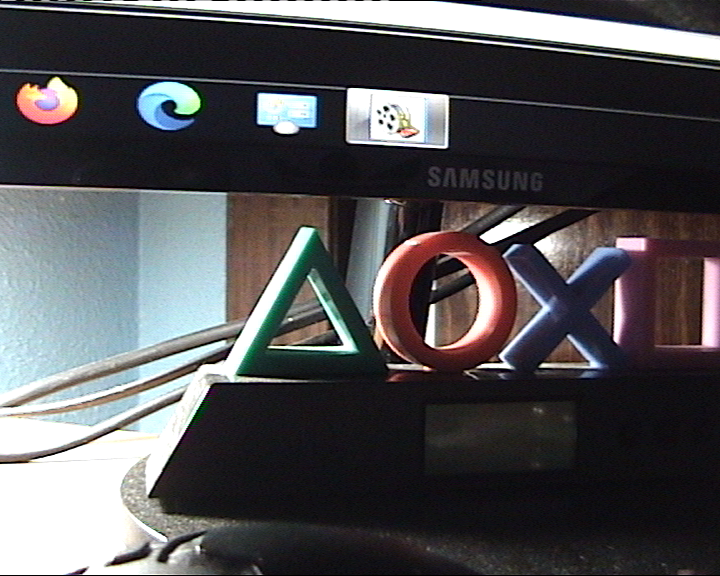

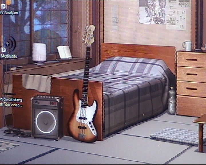

    I made a test comparing it to my firewire card with my digital 8 camera to see how much the difference is from a digital camera to analog and back to digital vs using firewire wich is digital already and there is not a lot of conversions going on vs using the analog ports.
    Capture from the Terratec analog card via s-video at 4:2:2, deinterlaced with bwdif and converted from 4:2:2 to 4:2:0 because the Staxrip program doesn't let me to deinterlace with 4:2:2 and fixed with qtgmc in "progressive repair details" to fix some minor things like aliasing or little interlacing artifacts from the bwdif/yadif filters:

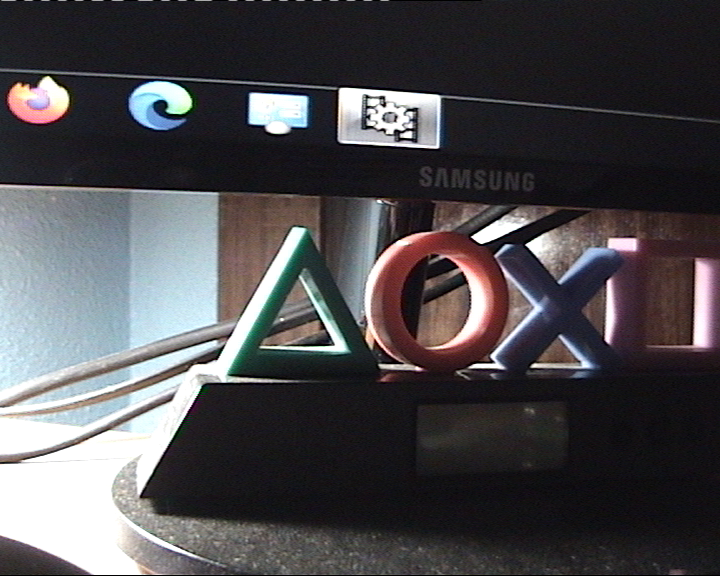

    Capture from firewire at 4:2:0 by native because of the DV codec and deinterlaced with QTGMC:
    [Attachment 78238 - Click to enlarge]
    I made those captures with the screenshot option of the VLC player.

    Obviusly the colors are a bit better with the firewire capture but you think the analog capture card is good or have a problem with colors?
    I bought it as a replace for my old BT848 card and was a big improvement that it had a better chip, audio in and native drivers for windows 7.
    I still don't have analog camcorders but i'm planning to buy a Hi8 XR cam so that's why I bought this analog card for analog captures with s-video. My digital 8 camera doesn't work as a capture device because it only have output ports so analog to DV is out of my mind (for now).
    However I don't see the card is doing itself any compression with virtualdub and huffy 4:2:2 I see it very good (but in the end of the day I convert it to 4:2:0 while deinterlacing).

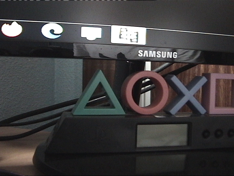

    I noticed that using VirtualVCR with default settings I get far better colors than default settings with VirtualDub.
    Here an example from VirtualVCR default settings:
    [Attachment 78254 - Click to enlarge]

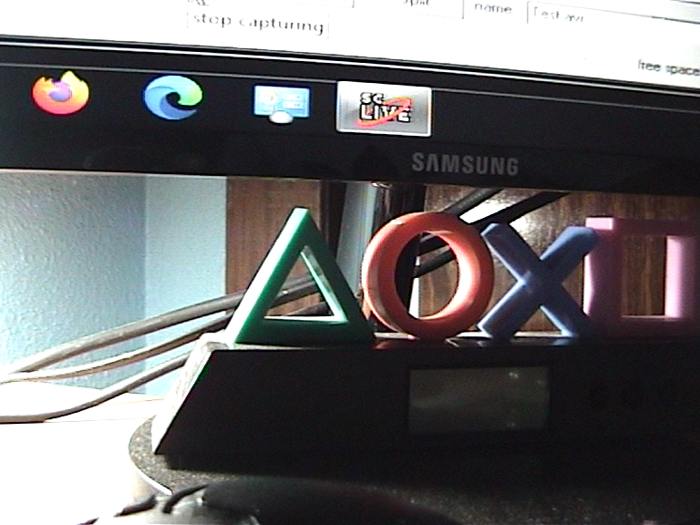

    Capture with VirtualDub default settings:
    [Attachment 78255 - Click to enlarge]

    Yes I did a screenshot with that option from VLC. I was seeing the difference in the preview of the capture software too. But is not the best example.

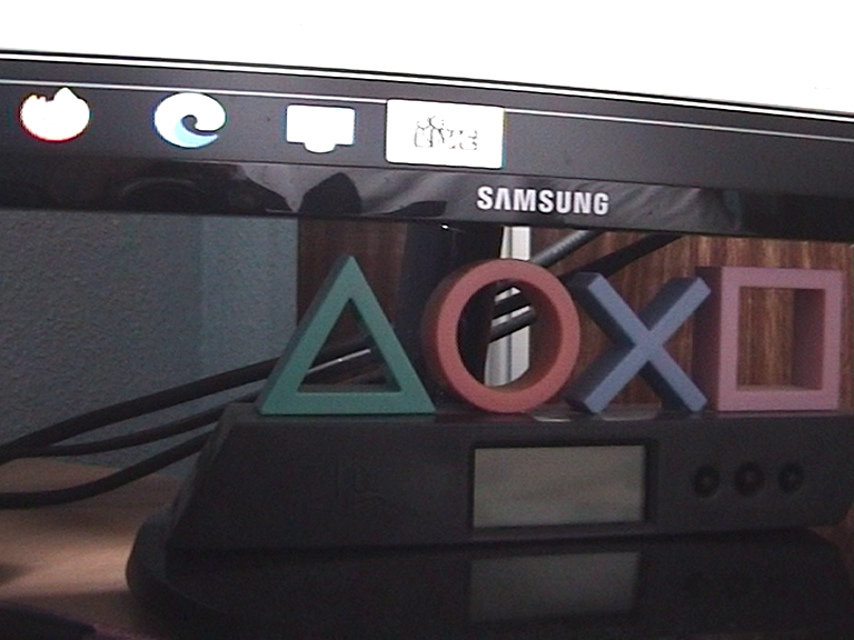

    I made another test better from the same exact position beetwen firewire, VirtualVCR and VirtualDub.
    Capture from firewire:
    [Attachment 78256 - Click to enlarge]
    Capture from VirtualVCR:
    [Attachment 78257 - Click to enlarge]
    Capture from VirtualDub:
    [Attachment 78258 - Click to enlarge]
    Those may or not may be good examples at all also I didn't deinterlace the videos these screenshots are from raw AVI samples.
    As far as I can tell VirtualVCR does a better job with the picture quality from my tv tuner card with the CX2388X chip.
    An appropriate capture software as VIrtualDub, VirtualVCR or AmarecTV has no impact on the intrinsic quality of the picture, it should just insure a video compliant to specifications.
    What you may see is a difference in the video levels because the procamp settings or other.
  11. Originally Posted by lollo View Post
    Yes. Default settings in virtualdub just gives me weird colors while in VirtualVCR default settings show a better configuration of colors, brightness, contrast…
