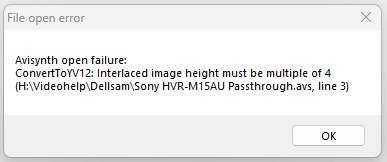

QTGMC won't open that M15AU file because the YV12 conversion fails:
[Attachment 78209 - Click to enlarge]
486...
My script:
Code:SetFilterMTMode ("QTGMC", 2) AVISource("H:\Videohelp\Dellsam\Sony HVR-M15AU Passthrough.avi") ConvertToYV12(interlaced=true) AssumeBFF() QTGMC(preset="Fast", EdiThreads=8) Prefetch(24)
The customer is using a JVC VCR with TBC ON and probably an external frame TBC, I didn't ask for details since I have to fix this problem on my end, not on his end.
I believe NTSC is BFF, I could be wrong. 486 is broadcast standard capture, If you can't process it, crop it down to 480.

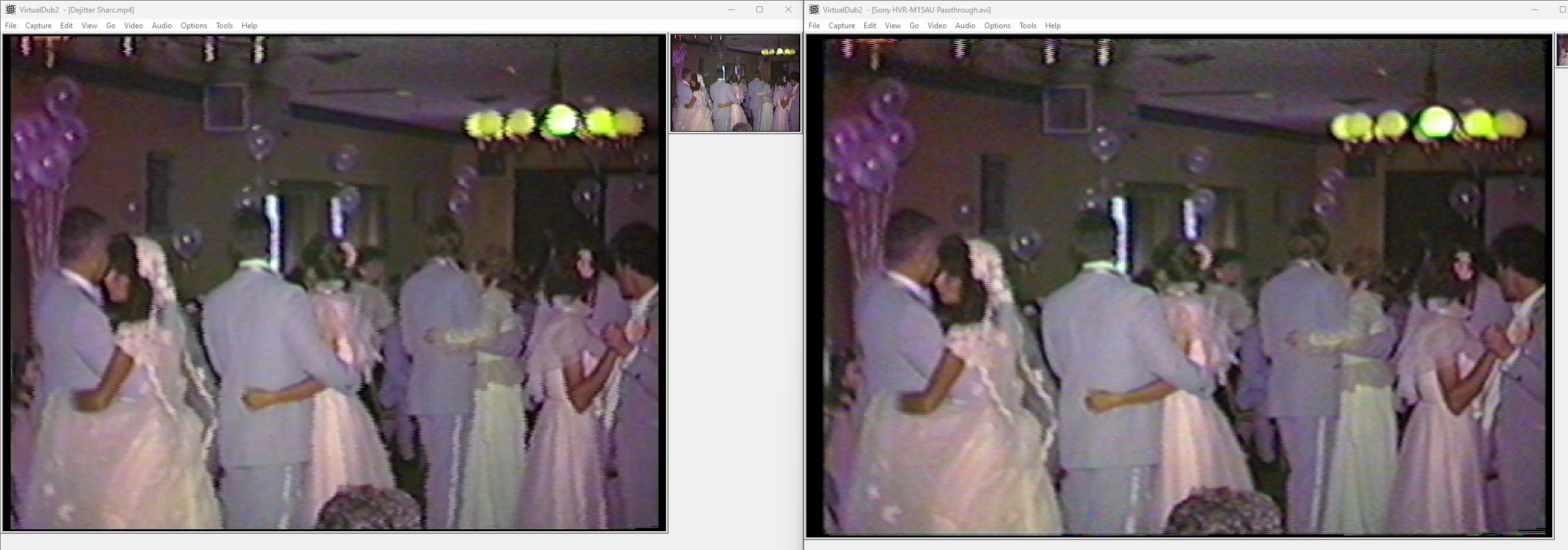

Try Dejitter (Avisynth32 plugin). It seems to give some improvement.
http://www.avisynth.nl/users/vcmohan/DeJitter/DeJitter.htm
Code:AVISource("Sony HVR-M15AU Passthrough.avi") crop(0,0,-0,-6) DeJitter(jmax=80,th=0.1, wsyn=8, extend=true) crop(0,4,-32,0).addborders(8,2,8,2) #centering, 704x480
@Sharc, I don't think that improves things overall; while the top is steadier, the detail of the vertical surfaces is compromised. Check the legs and edge of the dresses around frame 1200.
[Attachment 78222 - Click to enlarge] -
@Alwyn: Yes, I noticed this as well. I didn't try to optimize anything. It was just a quick shot using this filter. It may work better when applied to the deinterlaced video, I don't know.
Initially I thought to just crop/mask the top ~32 pixels as there is not much significant picture content there.
Maybe there are better proposals around. -
