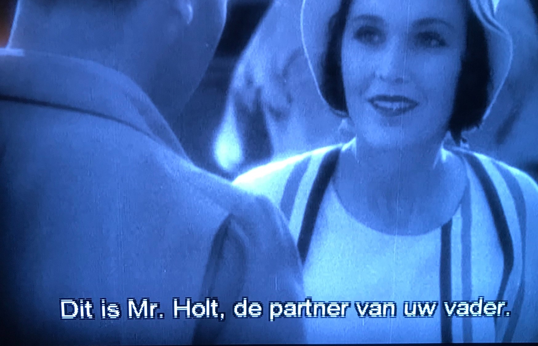

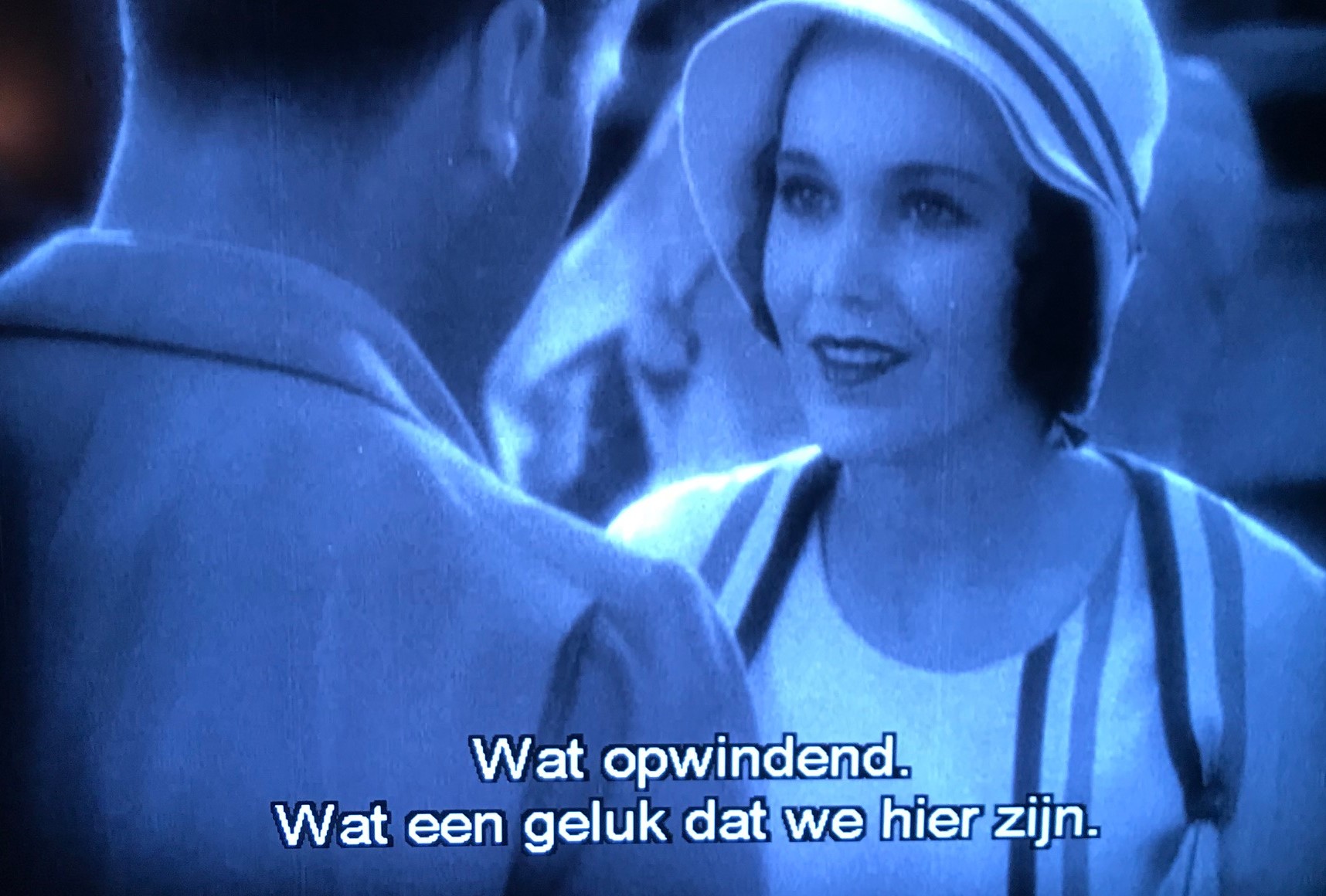

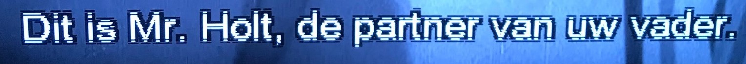

    I have troubles with DVDstyler (subtitles).
    When I make .sub subtitles created with Subtitle Edit, export them for DVD. I get these weird looking subtitles.
    It Gets those weird lines trough it. You have to klick on the picture, and its noticeable, on TV its more noticeable then the picture.
    [Attachment 78303 - Click to enlarge]
    [Attachment 78194 - Click to enlarge]
    It goes between weird and normal on and on. Every other turn they turn normal and then weird again.
    Anyone experienced this? DVD is used on XBOXONE

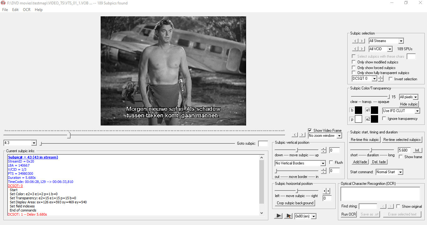

    To find out, get DVDSubEdit, open the main movie VOBs and post a screenshot.
    You could also try playing the DVD in another player. If the subtitles look fine, it's almost certainly the cropping issue that some players struggle with.
  3. Yes it works normal on other players, but not on the xboxone.
    Here is the screenshot.
    [Attachment 78497 - Click to enlarge]
    Okay i don't know what to look for. Only see some text in red.

    The text in red is fine, it's always red.
    Now it's certain – it is the old issue of cropped subpictures causing problems with some players.
    See where it says "Set Display Area: sx=126 ex=593 sy=469 ey=540" some combinations of even/odd numbers cause this issue.

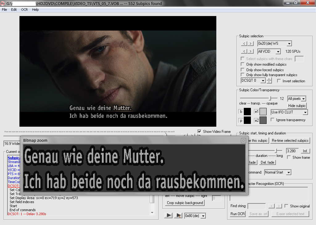

    With normal (full frame) subpictures, all Set Display Area commands would have the same numbers. For example:
    [Attachment 68465 - Click to enlarge]
    The only solution is not to use cropped subpictures. Commercial DVDs also never use them. You will have to see if there is an option somewhere in Subtitle Edit to prevent cropping the subpictures automatically, or maybe it happens in DVDstyler (I don't know because I don't use either one).

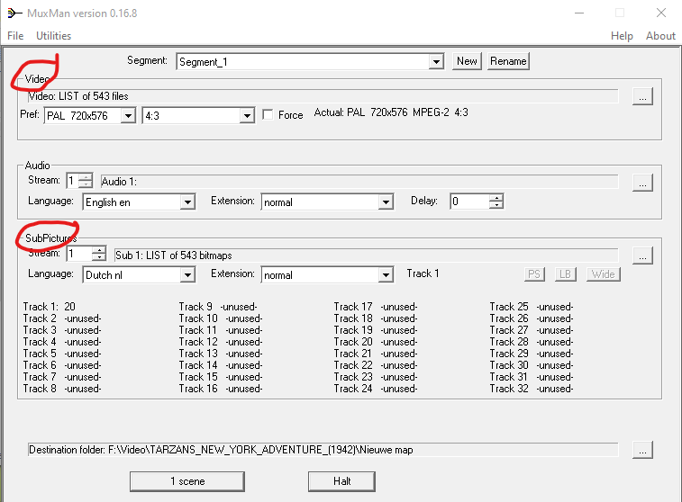

  14. So do i need to select all the Bmp files in the video section?
    And the SST file in the subtitle section?
    Like this
    [Attachment 78607 - Click to enlarge]
    And press start?
    I'm not very familiar with Muxman and PGCdemux
  15. Got the subtitles extracted with PgcDemux, but same results as before. Converted it with BDSup2vob. A setting that i mis?
    Don't know what i'm doing wrong? ��

    Ah yes, forgot to mention it – by default BDSup2Sub will crop the subtitles by itself. To prevent it from doing this, you need to launch BDSup2Sub.jar with /acrop:0 command.
    I like to put a BAT file next to BDSup2Sub.jar containing the command.
    java -jar BDSup2Sub.jar /acrop:0
    Paste this command in a notepad and save as a BAT file (for example "BDSup2Sub NOCROP.bat"), and use it to launch BDSup2Sub. That should fix it. You did the MuxMan part correctly.
