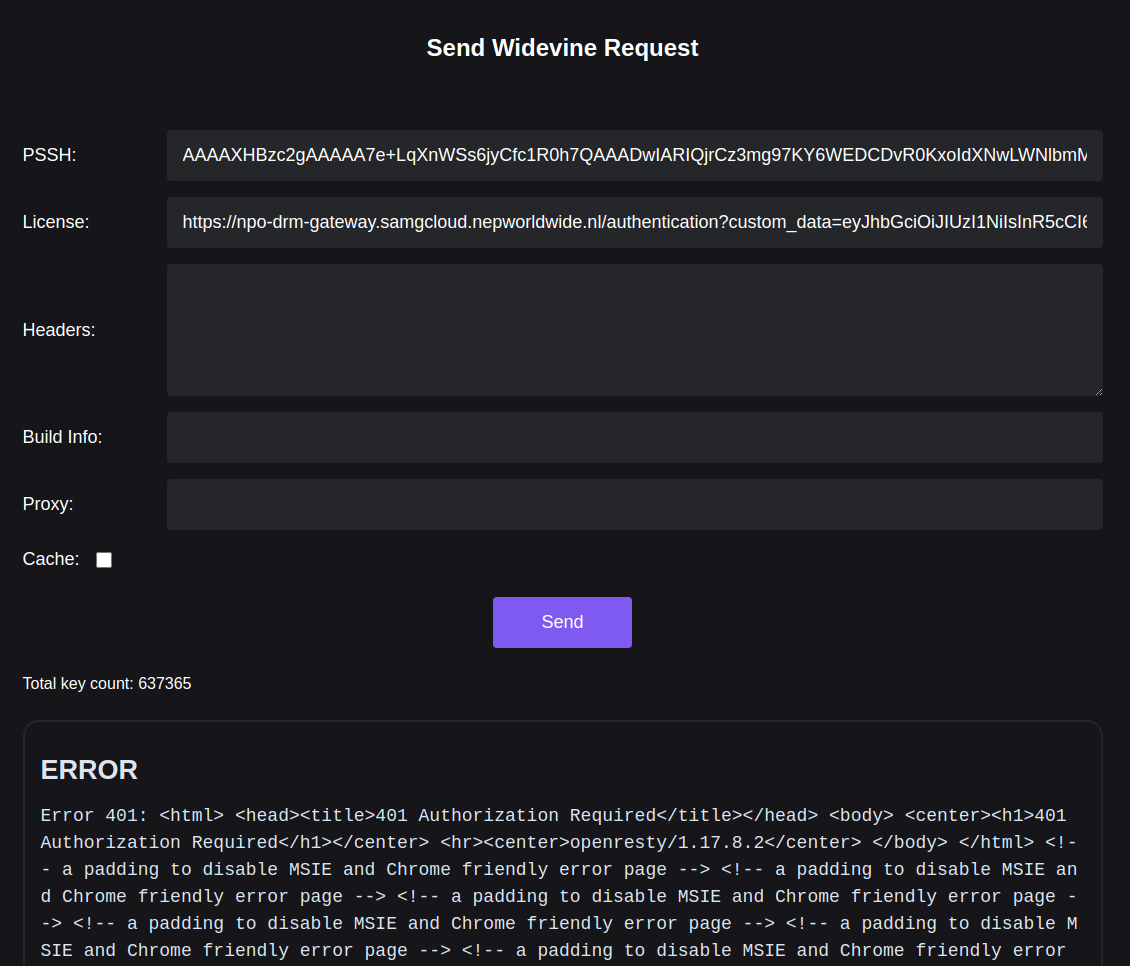

[Attachment 78176 - Click to enlarge]
Btw, CDRM-project.com does not work in this case
AAAAXHBzc2gAAAAA7e+LqXnWSs6jyCfc1R0h7QAAADwIARIQjr Cz3mg97KY6WEDCDvR0KxoIdXNwLWNlbmMiGGpyQ3ozbWc5N0tZ NldFRENEdlIwS3c9PSoAMgA=
https://npo-drm-gateway.samgcloud.nepworldwide.nl/authentication?custom_data=eyJhbGciO...6LKp872pYPzAwk -
CDRM-project.com could work but you need a fresh token and a header.
