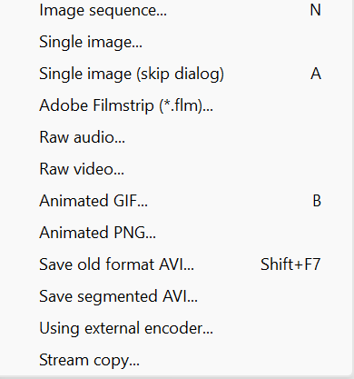

In VirtualDub2, there's Steam Copy and Direct Stream Copy. What's the difference between them? Are they both lossless?
Also, for the latter I can't change priority back to internal AVI driver or switch the default driver to it. How do I fix that? My videos are AVC/HEVC in mp4/mkv/mov files.

I have VDub2 and mine doesn't have "Steam" (or Stream) Copy. It only has Direct Stream Copy. Direct Stream Copy is lossless.In VirtualDub2, there's Steam Copy and Direct Stream Copy. What's the difference between them? Are they both lossless?
I beg your pardon, you're right; I don't use that menu much. I suspect that "Stream Copy" is not lossless if you're "copying" a lossy format (as Dellsam alluded-to in the second post). As you've probably found, you cannot do a Direct Stream Copy on a MP4-type file, only a lossless AVI eg LAGS, HUFF.
I did a quick test on an MP4; using "Stream Copy", the video bitrate was around 700kb/sec whereas the original file was 500kb/sec, so I think it is fair to say that that is not a lossless copy. -
Both Export -> Stream Copy and Video->Direct Stream Copy are lossless. You can easily verify this by comparing the two output videos.
